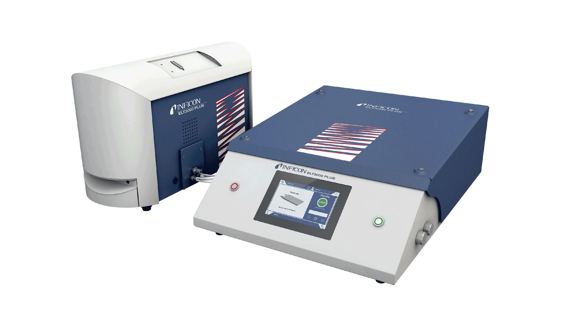

Two INFICON ELT3000 PLUS industrial leak detectors, one vertical and one horizontal with a screen.
The ELT3000 Plus is designed to leak-test battery cells filled with liquid electrolyte, regardless of format. Photo courtesy Inficon

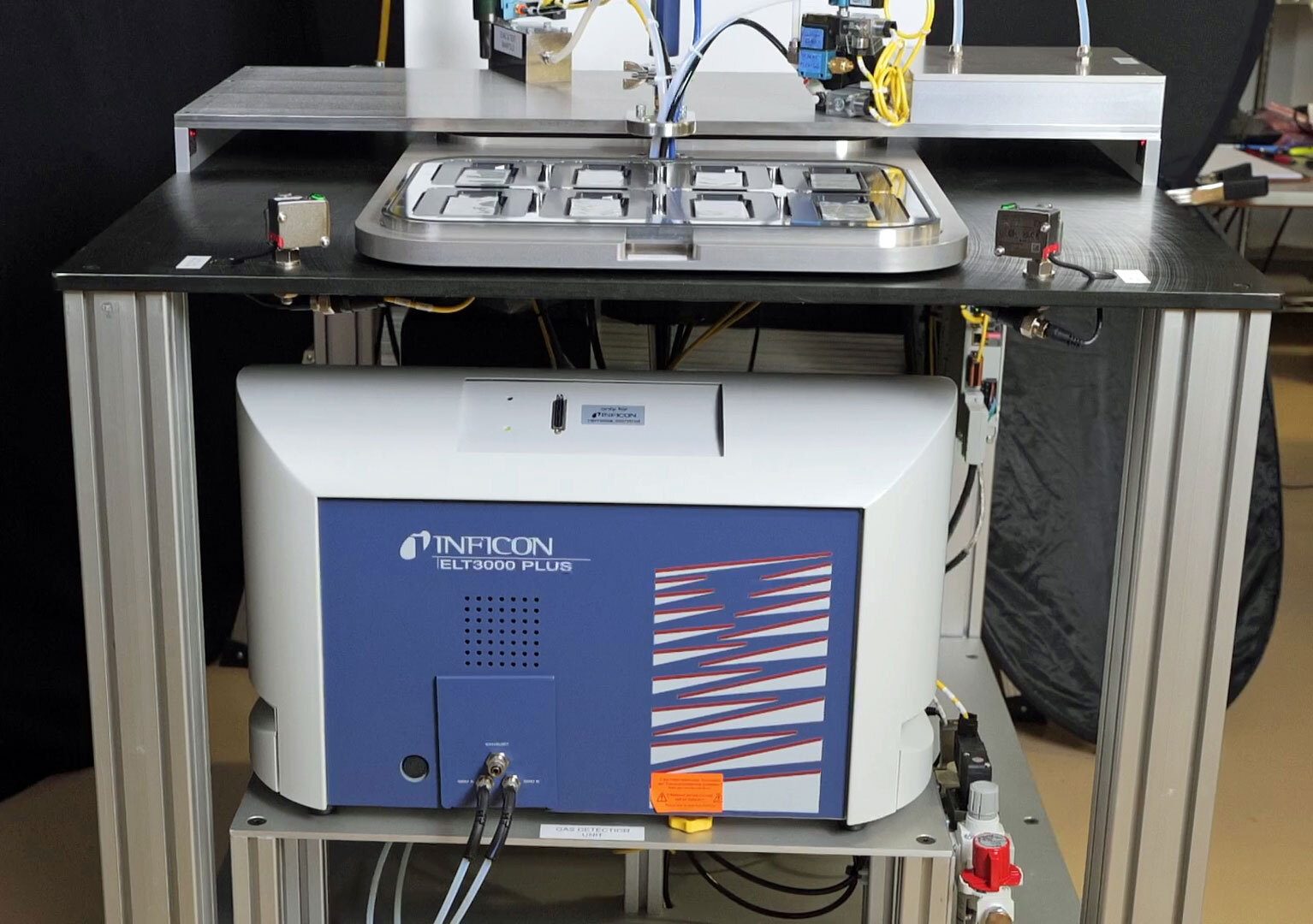

Equipped with a relatively small vacuum pump that is ideal for laboratory applications, the ELT3000 offered many advantages for high-volume battery testing. “In an industry where throughput is critical, we typically utilize vacuum pumps that evacuate the test chamber in less than a second, which is not possible with the smaller pump,” Williams explains.
His first thought was to rapidly evacuate the test chamber, finding that while the longer draw-down time of the original vacuum pump was “a problem for throughput,” it also was an advantage because as the pressure starts getting below the internal pressure of the part, then long before you’re at a pressure where you can test, you’ve already started the migration of the electrolyte to the outside of the battery. In other words, the long evacuation helped prepare the battery for testing.”
Automated lab equipment featuring a tray of rectangular samples, connected by tubes, wires, and valves.
The test system has a rotating fixture, so eight parts can be loaded and unloaded while another eight are being tested. Photo courtesy Inficon
But, Inficon’s new technology eliminated the need for compromise with the smaller, comparatively fragile, pouch cells.

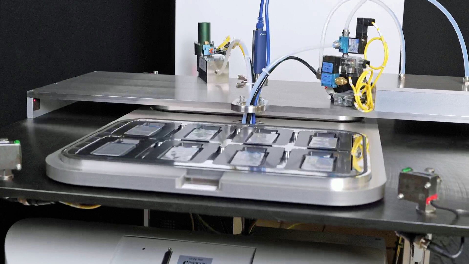

To achieve throughput requirements, Spectro Physics designed a system that integrated an Inficon ELT3000 to test eight batteries at a time. “These were relatively small batteries, so testing eight of them at a time wasn’t a problem,” Williams explains. “We would load those eight batteries into the test chamber, rotate the test chamber [a two-station clamshell] and then lift it up into position for testing.”
Evacuation to test pressure occurs rapidly, “but we had to hold on to it for a little bit under vacuum to allow the electrolyte to start leaking out.”
Though inherently slow, because eight parts are tested simultaneously, line speed is achieved for a cycle time of 12 to 15 seconds.
“We provide sufficient time to draw the gases that are in the test chamber into the gas detection unit, and it can report and tell us what the leak rate it was able to read. Then we would attach it to the status of the part and come up with a [test result for] the part,” Williams says.
There were challenges, such as electrically pre-charged cells. For this customer, Spectro Physics designed insulated test chambers to prevent shorts. Also, if even one of the eight tested batteries fails, the entire batch must be retested, according to the customer’s specification.
“It’s part of the nature of the beast where we must allow some time for the electrolyte to start leaking out of the battery before we can start detecting it. Because of that, it is never going to be a one-for-one test, like we do in the airbag inflator business,” Williams says.
