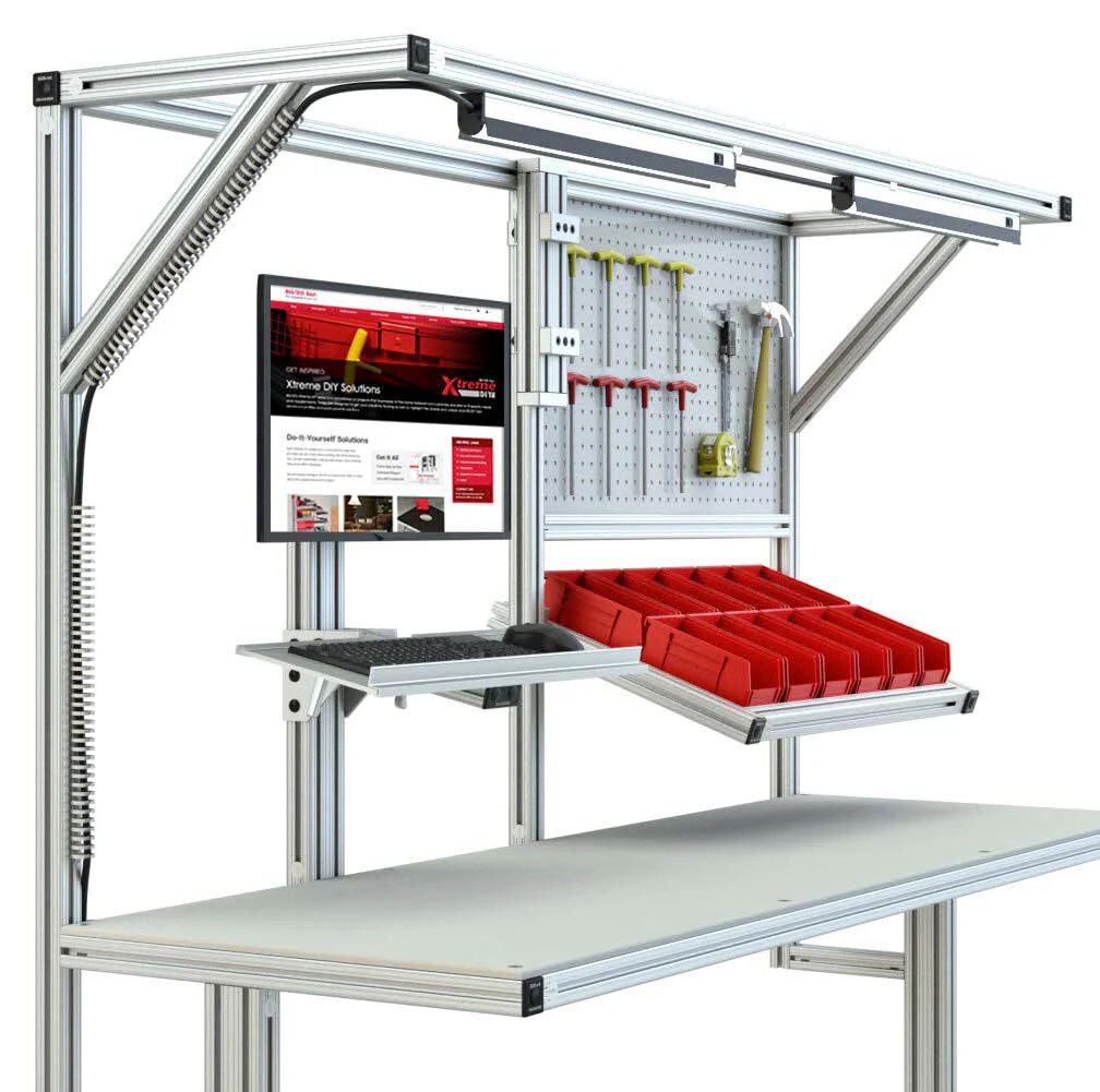

Modular workbench with aluminum frame, monitor, keyboard, pegboard tools, and red storage bins.
Studies demonstrate that ergonomic work environments increase productivity by 25 percent and lower absenteeism by 75 percent. Photo courtesy 80/20

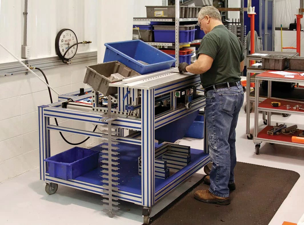

Man assembling metal parts at an industrial workstation with blue bins in a factory.
Engineers should consider who will be using the workstation and how. Will the work be done sitting or standing? Will different people use the workstation over the course of a workday? Photo courtesy 80/20
