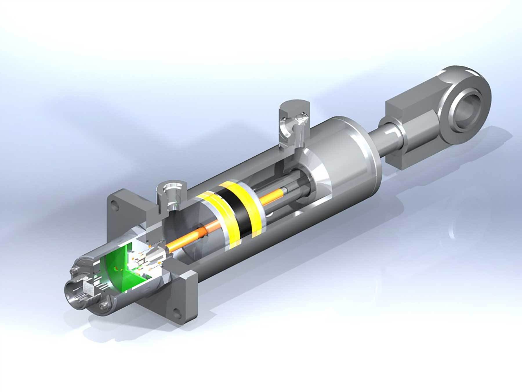

Position feedback sensors for hydraulic or pneumatic cylinders have traditionally used one of three technologies: magnetostrictive, variable resistance and variable inductance sensors.
While other sensor technologies have occasionally been used successfully in this application, this article will focus solely on the three most popular technologies. As demand for greater control and functionality has increased, sensor-instrumented cylinders are becoming more important in the heavy industry, subsea and mobile equipment worlds. Ultimately, a user or systems integrator must determine the requirements of the application and which technology best satisfies those requirements on a total installed cost vs. performance basis. This article will compare the strengths and weaknesses of magnetostrictive, variable resistance and variable inductance sensors.
Initially, a point to be noted is that all of these common sensing technologies use a long probe that extends into a deep, small diameter blind hole that has been gun-drilled into the internal end of the cylinder rod.
Magnetostrictive
Magnetostrictive technology has been the preferred technology for high-accuracy applications. The sensor, often called a linear displacement transducer or magnetostrictive linear displacement transducer, incorporates a stainless steel tubular probe and a short toroidal permanent magnet assembly around it that is installed in a counterbore in the piston.
The most common package is designed to thread the sensor’s electronics housing into an O-ring port in the back of a cylinder, with the long slender probe inserted into the rod’s bore. It uses the “time of flight" principle to determine the magnet’s position with high accuracy and moderate response time. The magnet is used to reflect a torsional mechanical pulse that is transmitted along a special wire inside of the probe called a waveguide.

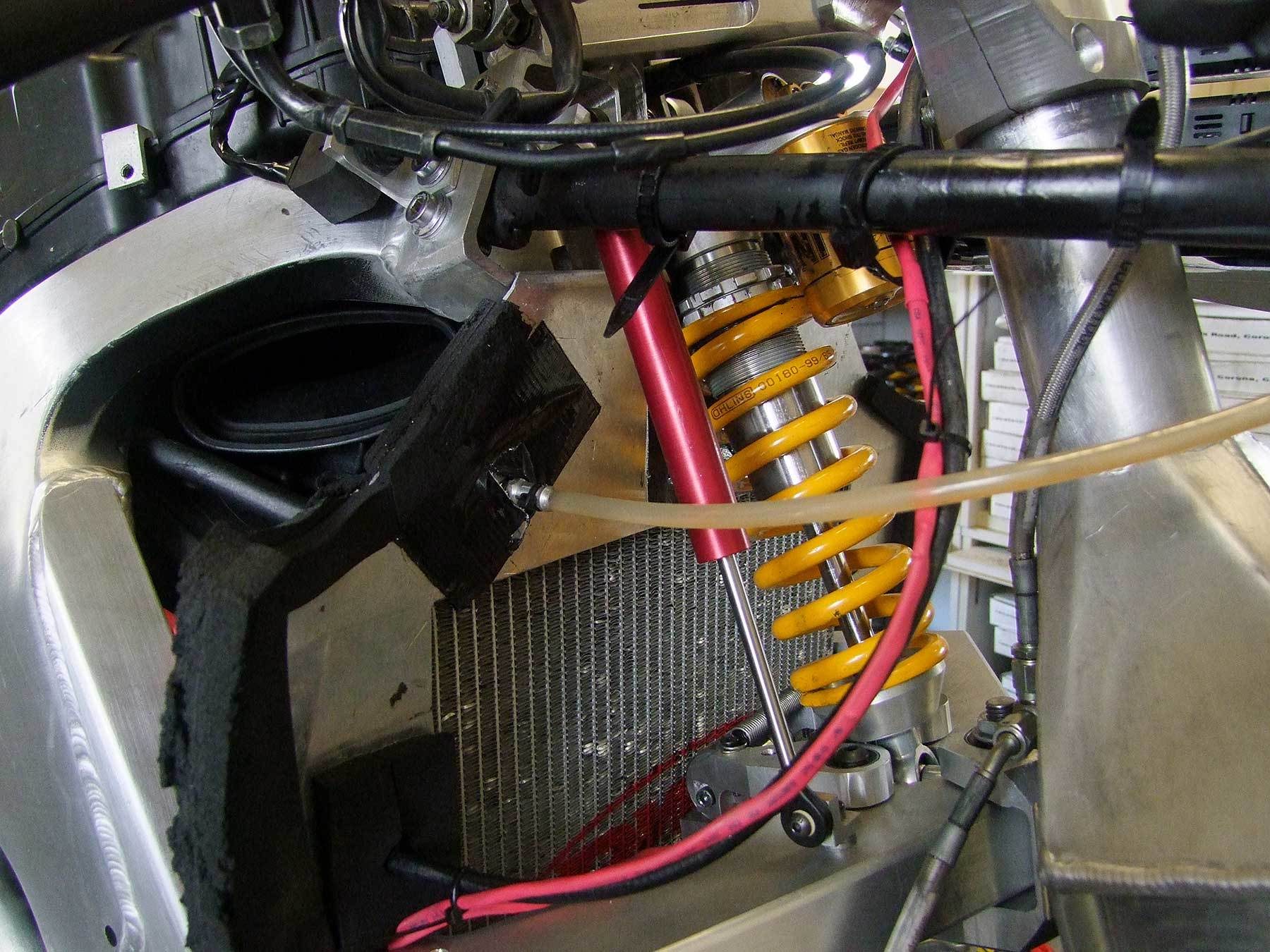

Variable inductance sensors can withstand much greater shocks and vibration. Here, a sensor is mounted to a vehicle suspension system. Photo courtesy Alliance Sensors Group

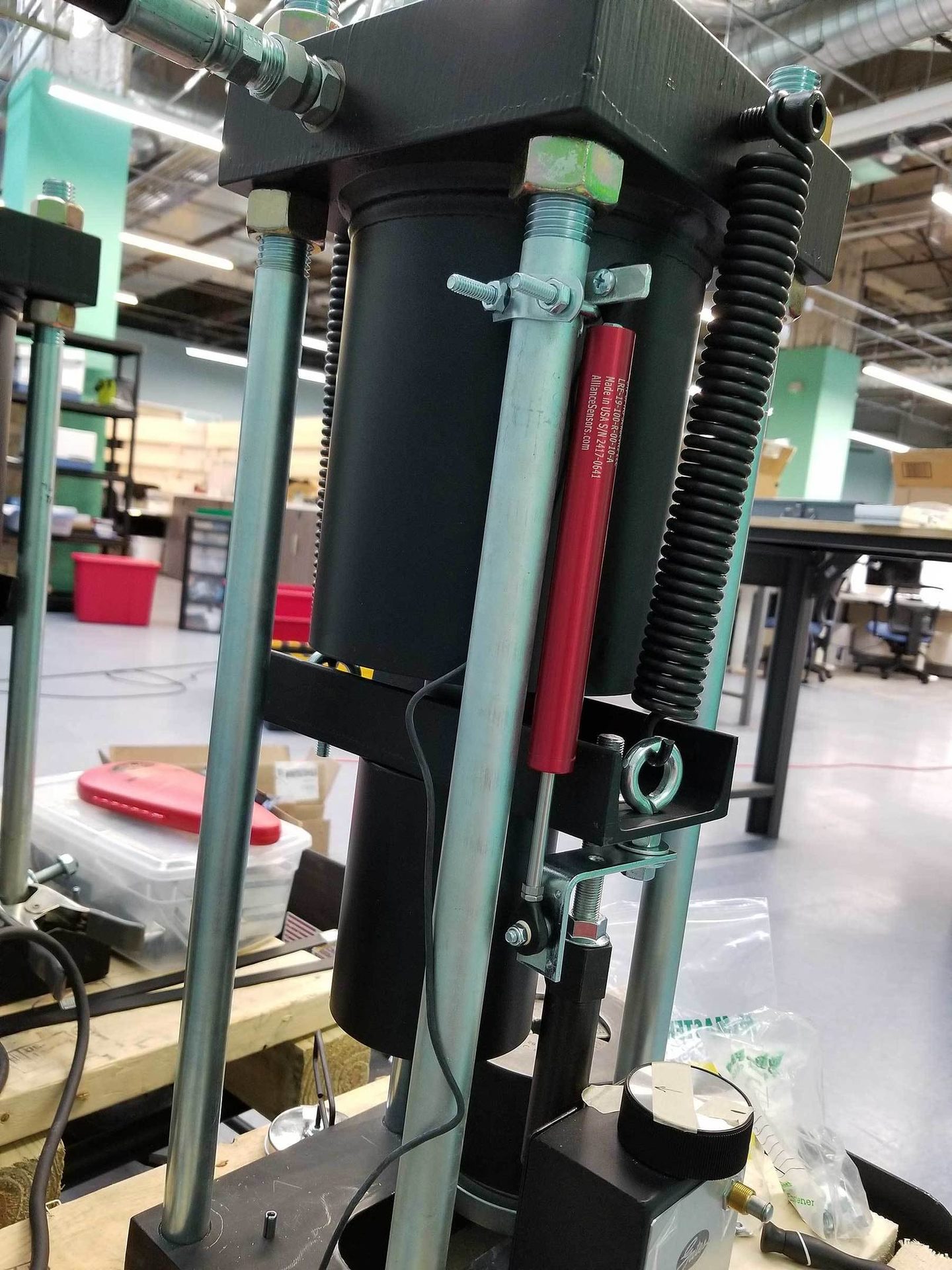

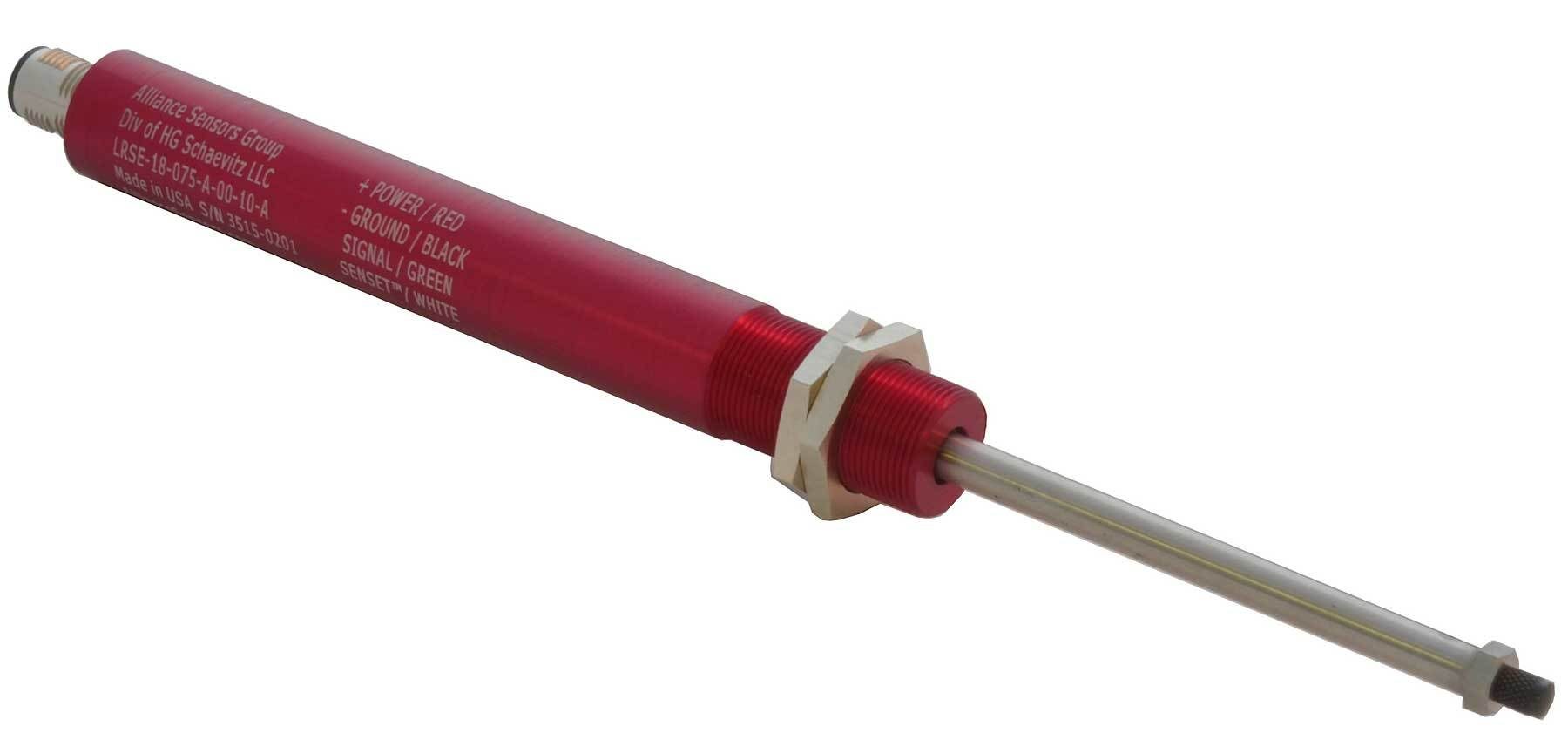

Variable inductance position sensors have been used in the cylinder industry, but have not had the widespread recognition of magnetostrictive sensors or resistance potentiometers. This noncontact technology has significant advantages over resistance potentiometers in terms of product life and long-term reliability. They usually compete favorably with magnetostrictive sensors in terms of linearity, resolution, and frequency response, but at a significantly lower cost. Equally important is the fact that variable inductance sensors can withstand much greater shocks and vibration, such as those commonly found in heavy industrial and mobile equipment applications.
Linear variable inductance sensors cover the middle ground between the higher level of performance and external port mounting flexibility associated with a magnetostrictive sensor and the ruggedness and price of an embedded resistance potentiometer. These sensors operate by measuring the resonant frequency of an oscillator circuit that uses an inductive probe whose inductance is varied by the position of the gun-drilled rod over it.
Typically offered in full scale ranges of 4 to 36 inches, both port-mounted and embedded packages are available, with connector and cable terminations that match those found on most catalog magnetostrictive sensors. These sensors offer either an analog DC voltage or current output, with an SSI digital output available for OEM applications. The variable inductance sensor is a noncontact device that does not require a ring magnet. In fact, if a variable inductance sensor were installed to replace an existing magnetostrictive sensor, the magnet can be left in place in the cylinder rod end without interfering with the sensor’s basic operation.

Remote field calibration is a standard feature offered on many variable inductance sensors. This feature permits a user to scale the output of the sensor while it is being installed on the cylinder. With a push of a button to set the zero and the full-scale output points, the sensor will give the desired full-scale output over its newly set range, so it is no longer necessary to scale the unit in an operating control system.
