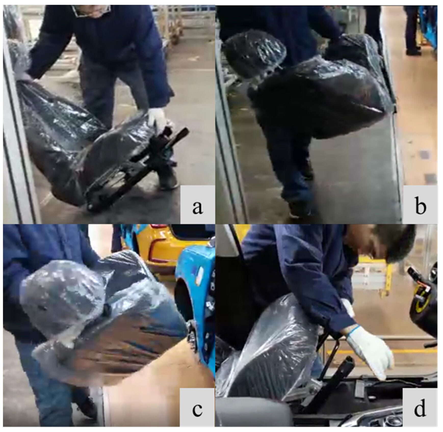

To test our idea, we conducted a field investigation at a Chinese automaker. Specifically, we looked at three actions on the line: lifting, carrying, and static assembly. The first two are self-explanatory. A worker picks up a part or subassembly—a door, a wheel, a seat—in one spot and carries it to another. In static assembly, the worker stays in one spot performing various tasks. He may or may not need to bend at the waist.

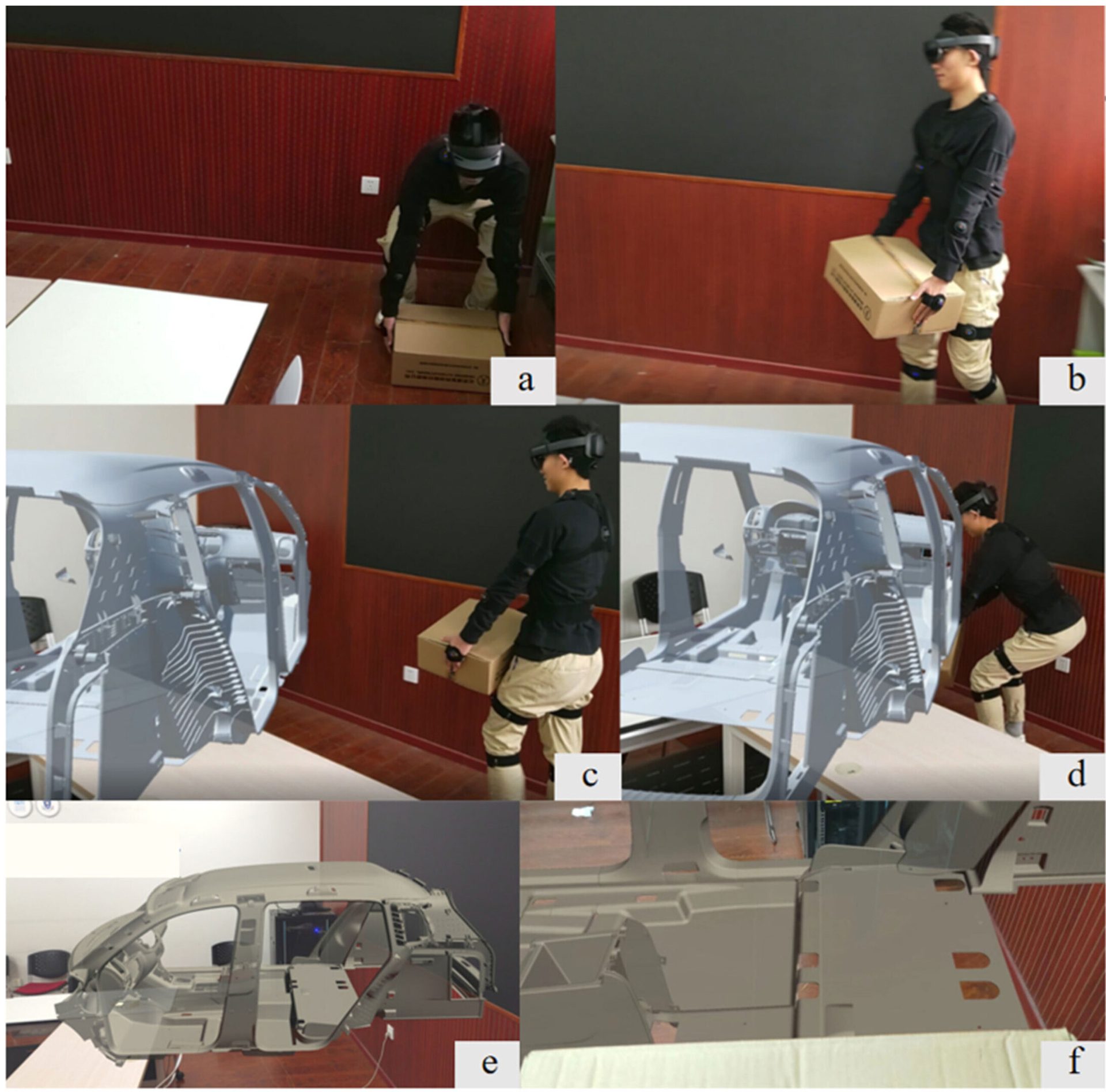

The participants—men aged 23 to 24—were divided into six groups, with three workers in each group. Workers were asked to lift weights of 8, 14 or 20 kilograms to a height of 15 or 45 centimeters from the ground. While wearing augmented reality goggles, workers had to pick up a weight, move it 3 meters, and “install” it in a virtual vehicle body. The latter process required bending over to attach the seat to the vehicle, during which time their bodies remain relatively static and only their hands perform the task.

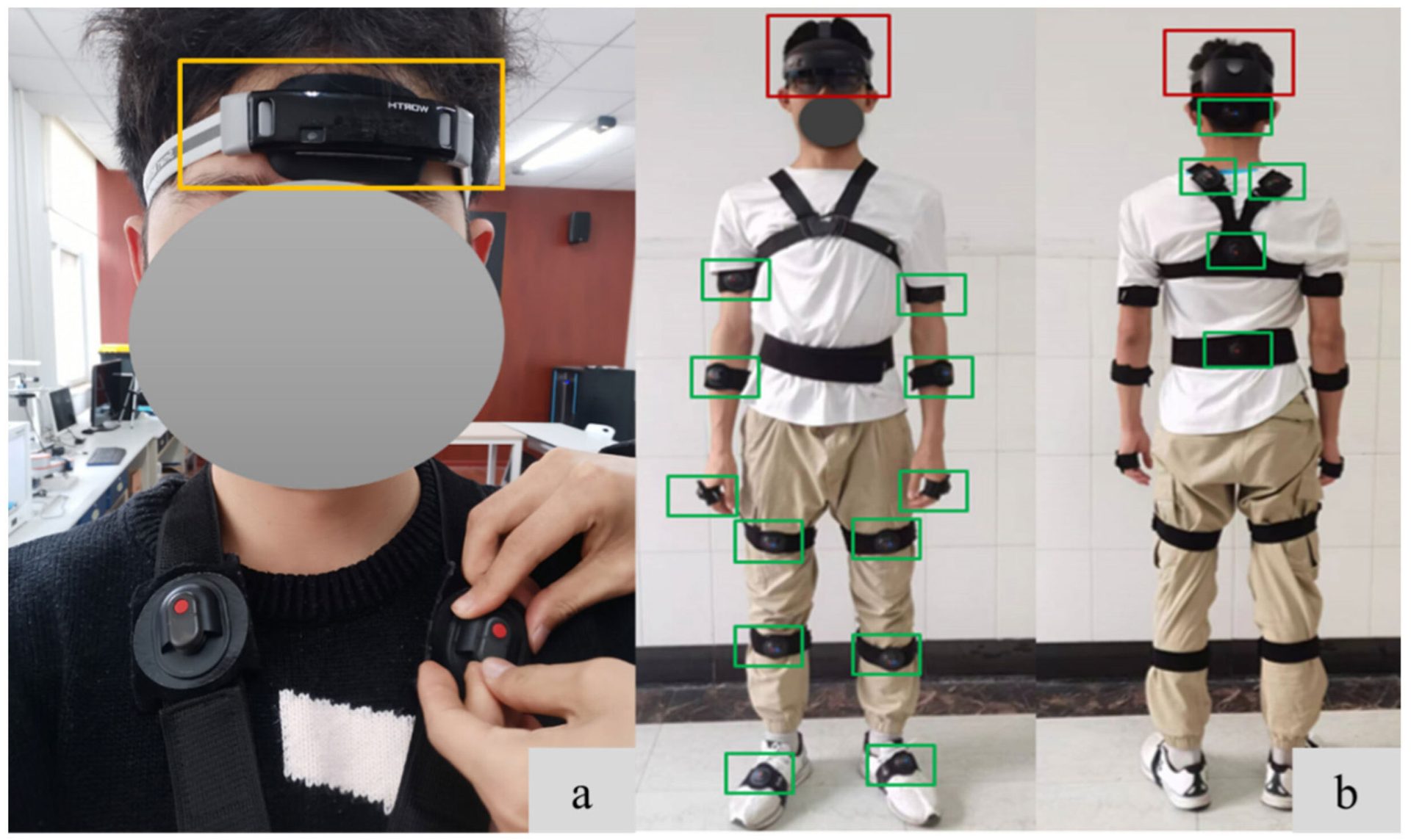

To measure cerebral oxygen levels, we used wireless blood oxygen sensors attached to a headband. The Augmented Reality-based Ergonomic Platform (ARE Platform) was used to create a consistent virtual assembly application. The platform puts virtual manufacturing models in a physical environment, providing participants with a semi-immersive working experience and retaining the constraints of the physical environment. A motion capture system collected data for the ergonomic indexes (RULA, OWAS, and NIOSH).

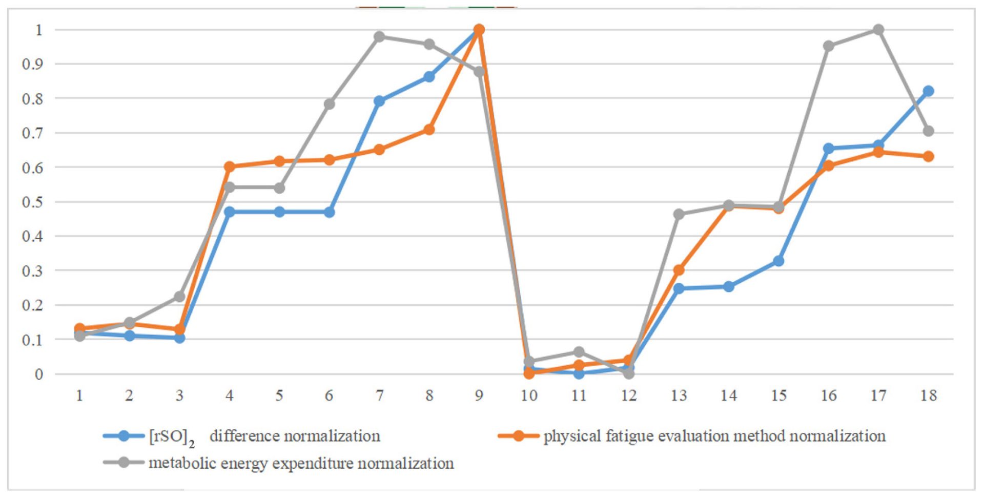

Our results showed that when the lifting height was 15 centimeters and the weight was 20 kilograms, the fatigue level was the highest. On the contrary, when the height was 45 centimeters and the weight was 8 kilograms, the fatigue level was the lowest.
The correlation between the physical fatigue evaluation method and cerebral oxygen levels was slightly higher than that between the metabolic energy expenditure estimates in Tecnomatix Jack and cerebral oxygen levels. In other words, our proposed cerebral oxygen method is more accurate than Tecnomatix Jack at predicting physical fatigue in workers.
