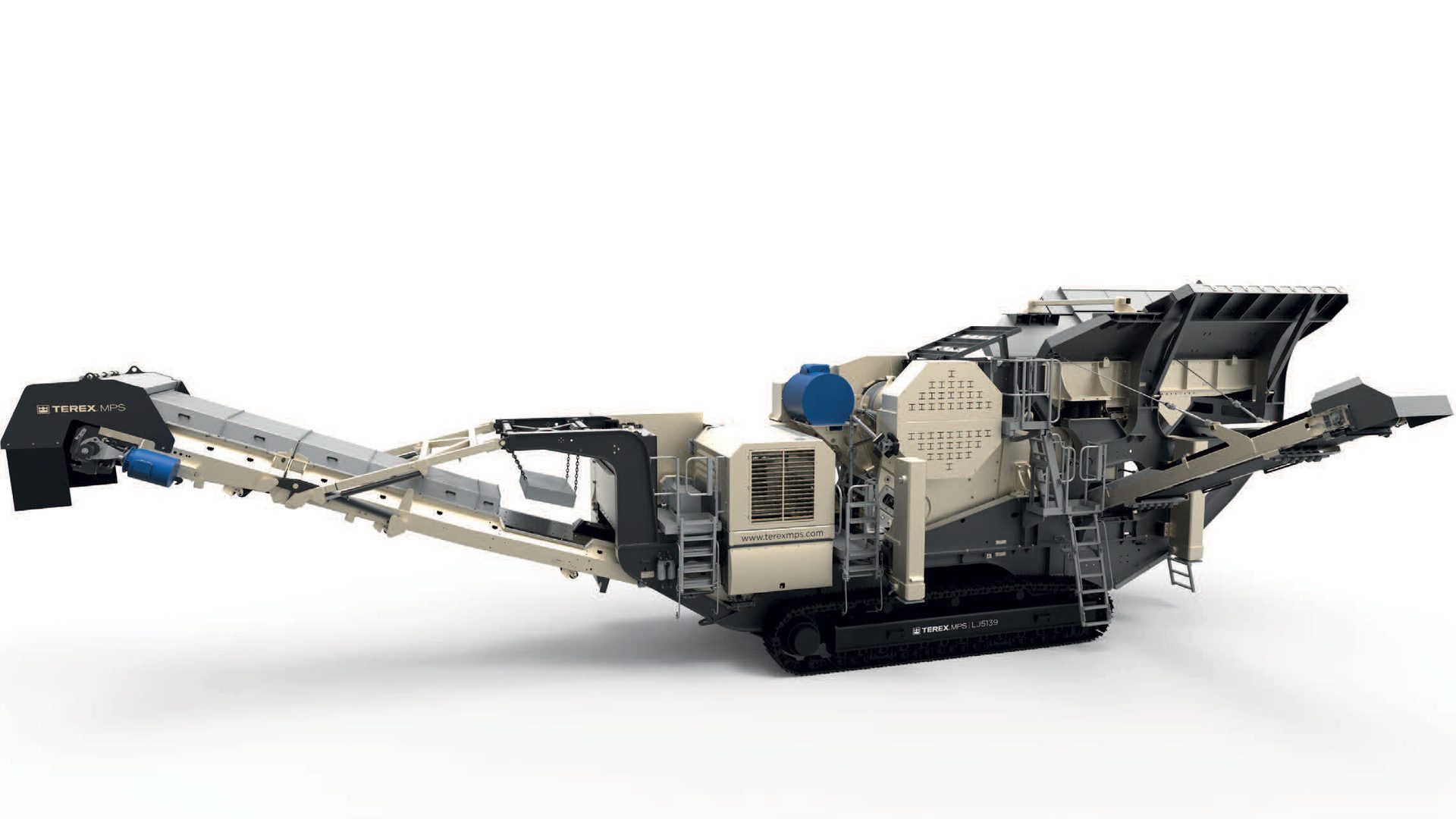

Designed for use in quarries, the LJ5139 mobile jaw crusher weighs more than 115 tons. Photo courtesy Terex MPS

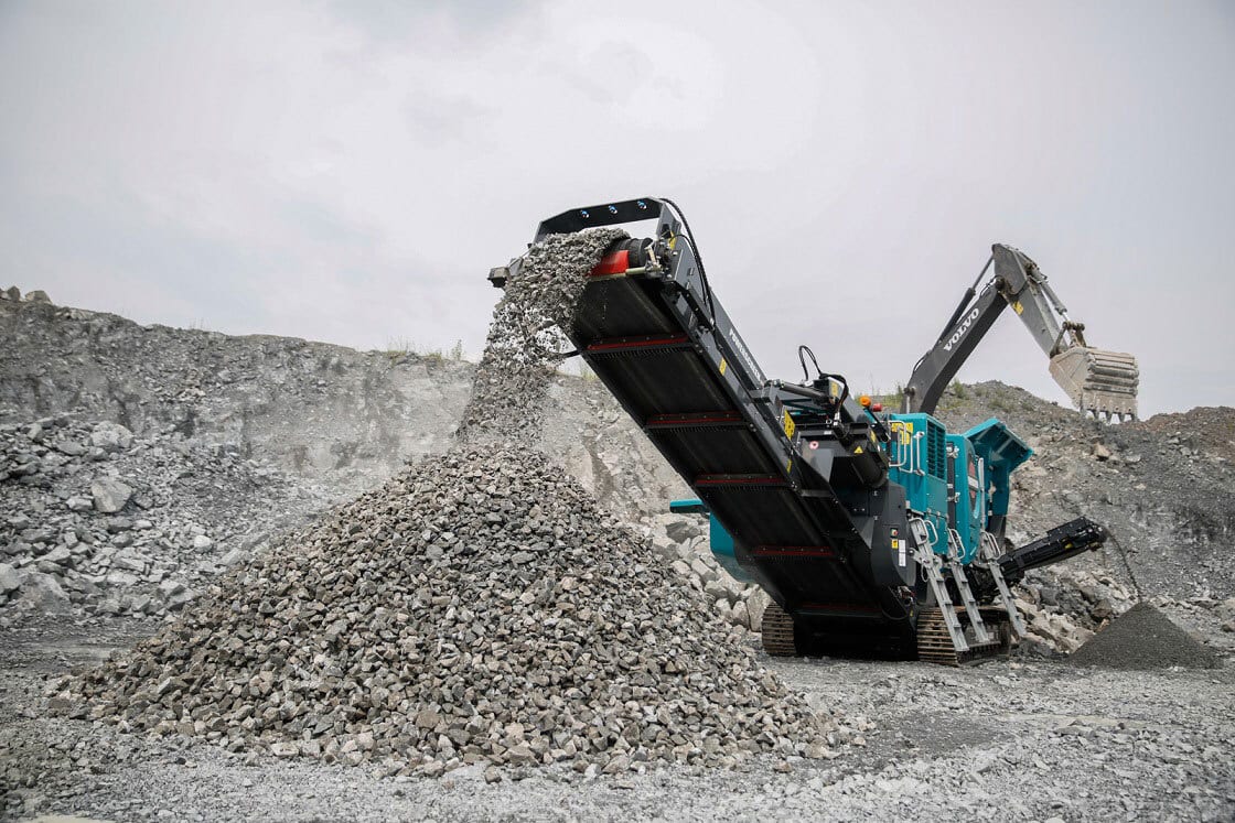

When designing machinery for quarries and mines, engineers need robust equipment to measure shock, vibration and forces. Photo courtesy Terex MPS
Terex asked HBK to consult on the company’s new LJ5139 mobile jaw crusher. Designed for use in quarries, the tracked machine weighs more than 115 tons. The chassis is subject to high loads when moving on uneven surfaces. In addition, the hopper and feeder receive high impact forces when large stones, with a volume of up to 1 cubic meters, are dropped into it by an excavator. The machine itself is subject to forces of up to 8,000 kilonewtons during the crushing process.
“To deal with these issues, we initially used finite element analysis during the design process and verified the results in the field using strain gauges,” says Ian Boast, chief engineer at Terex. “Previously, we relied on rented [test and measurement] equipment, but we were keen to invest in our own equipment for increased flexibility.”
The rented equipment had another problem. It was susceptible to noise interference from surrounding equipment. This was particularly problematic, since the loadings in the crusher are often random and transient in nature, which could potentially cause confusion and false results. In addition, the quarry environment was quite dusty. This limited test options on site, and it also meant that engineers had to take special care of the instruments.
