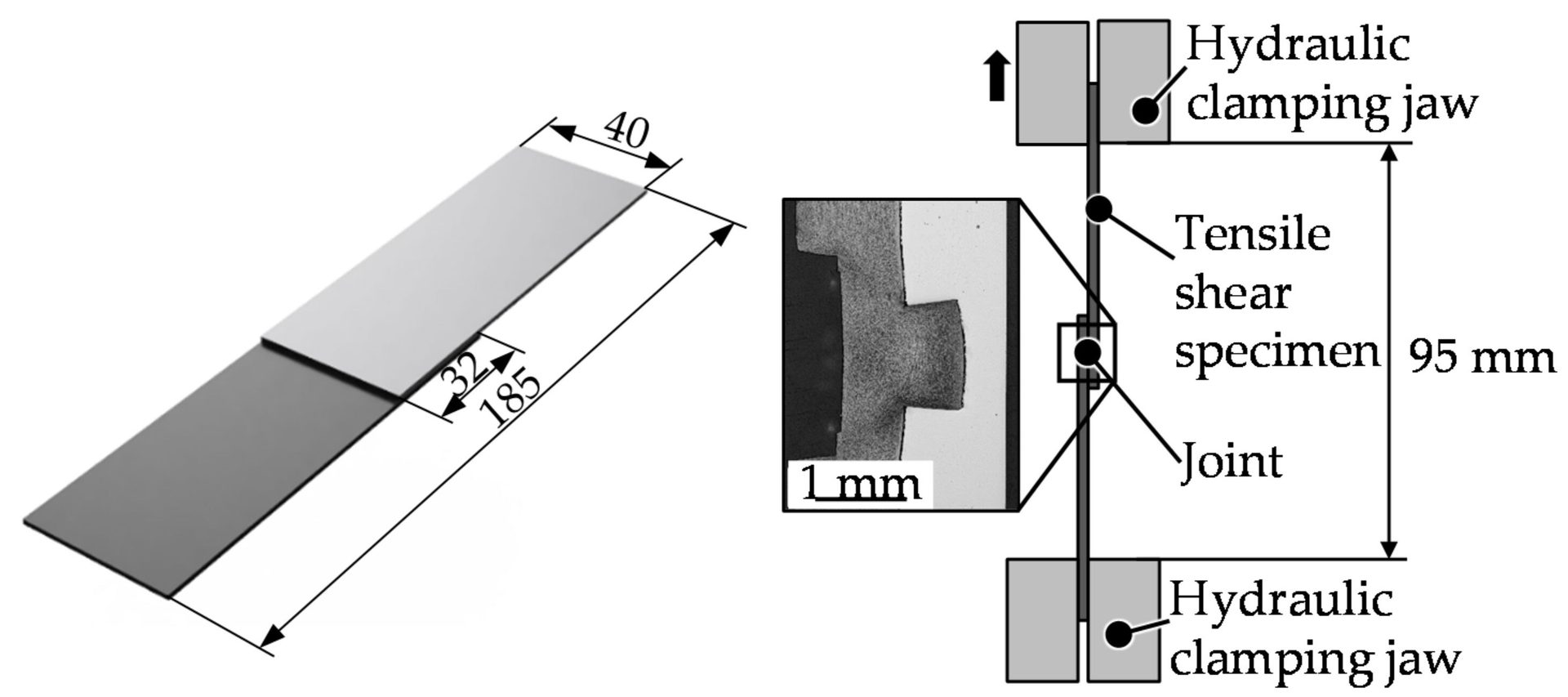

This diagram shows the arrangement used to measure the shear strength of the assemblies. Source: Institute of Manufacturing Technology

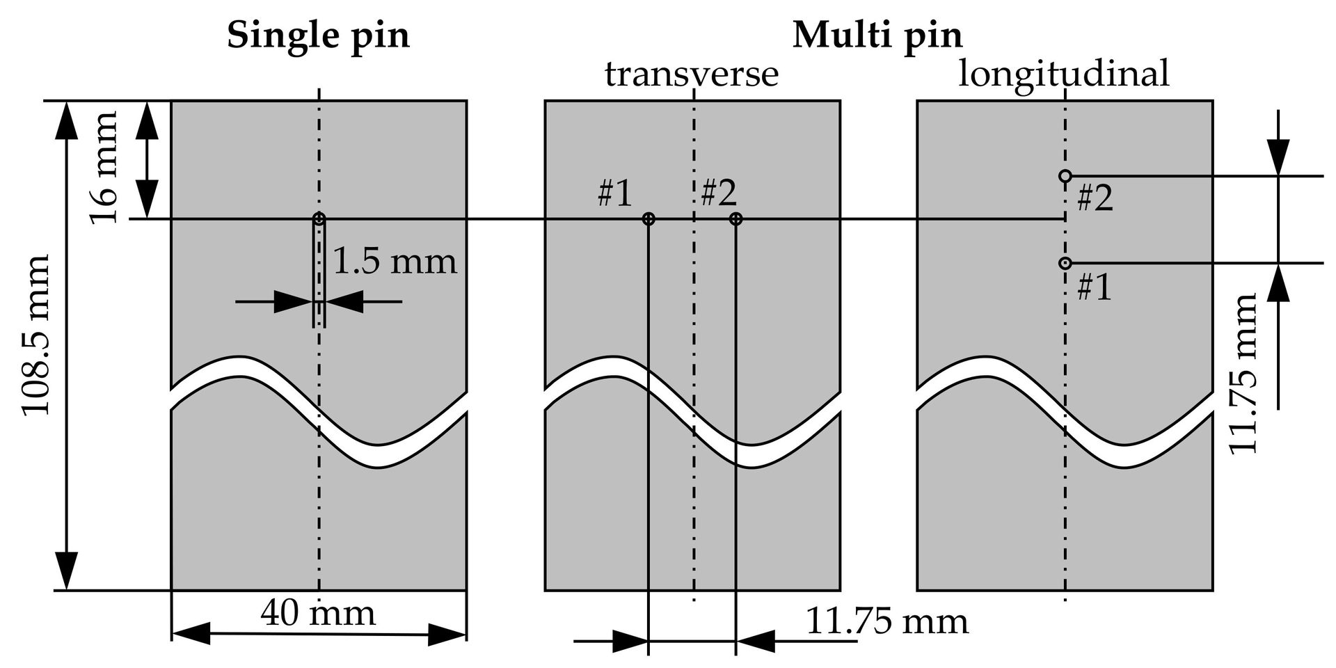

For our study, we used specimens 108.5 millimeters long, 40 millimeters wide, and 1.5 millimeters thick. Pin height varied from 1.08 to 1.86 millimeters.

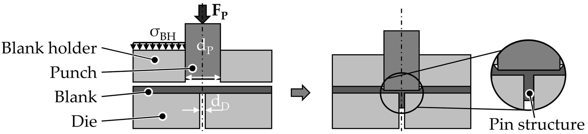

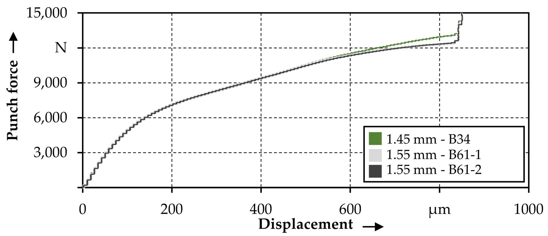

The pins were produced in the DP600 steel sheet by cold extrusion. A multi-acting tool, in which the blank holder and the punch can move independently of each other, was used. To prevent the steel sheet from bulging and reduce material flow radially outwards, a constant blank holder pressure of 250 megapascals was applied.
The pin structure is formed by moving the punch, 3 millimeters in diameter, axially at a constant speed of 5 millimeters per minute. The material is displaced both axially into a die with a diameter of 1.5 millimeters and laterally outwards into the sheet plane and the cavity. The pin height can thus be adjusted by the axial punch penetration depth, where a higher pin is realized by greater penetration of the punch into the sheet metal. To regulate the penetration depth of the punch, height-adjustable mechanical stops are used.
For our study, we varied the length of the pins, the number of pins, and the arrangement of the pins.

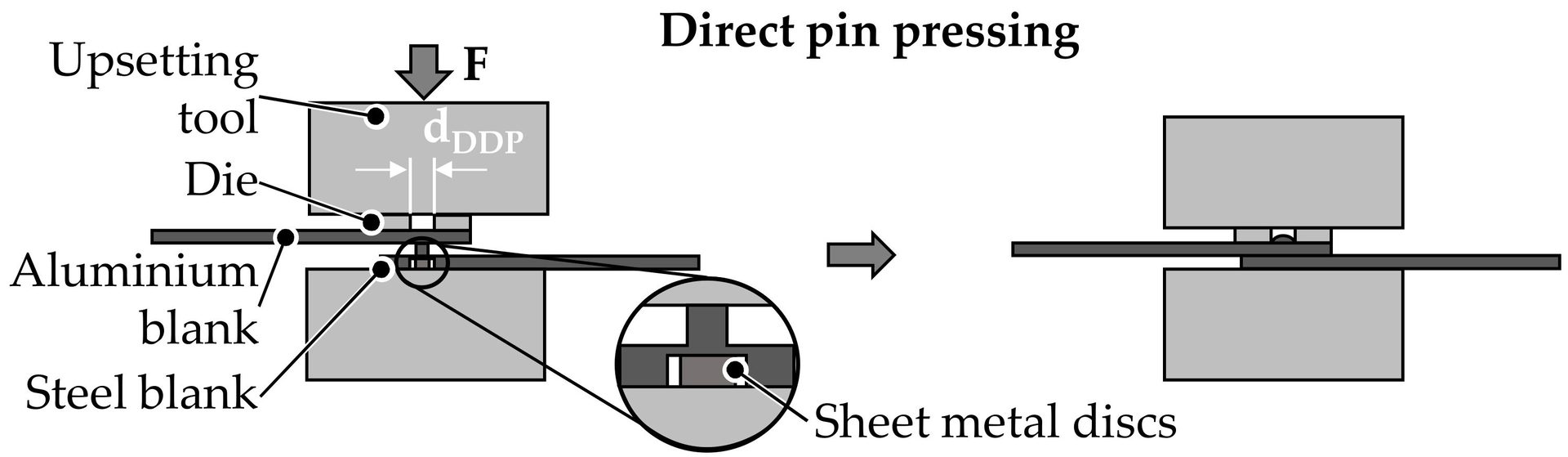

For assembly, the steel sheet was pressed directly into an unperforated aluminum sheet using a Walter + Bai 300 universal testing machine and a conventional upsetting tool. The tool moves axially at a constant speed of 5 millimeters per minute and presses the pin structure into the aluminum sheet until a force threshold of 25 kilonewtons is reached.
In the case of direct pressing of single pins, two strategies were examined: with and without a round die. The diameter of the die was varied between 3 and 4 millimeters. The aim was to investigate whether the material flow and thus the formation of an undercut can be promoted with the die.
To prevent the sheet metal from fracturing or bending back into the punch cavity underneath the pin structure, fine sheet metal discs were placed in the punch impression to provide axial support for the pins during joining. (When pressing multi-pin structures, no dies were used.)
The shear strength of all the assemblies was then measured.

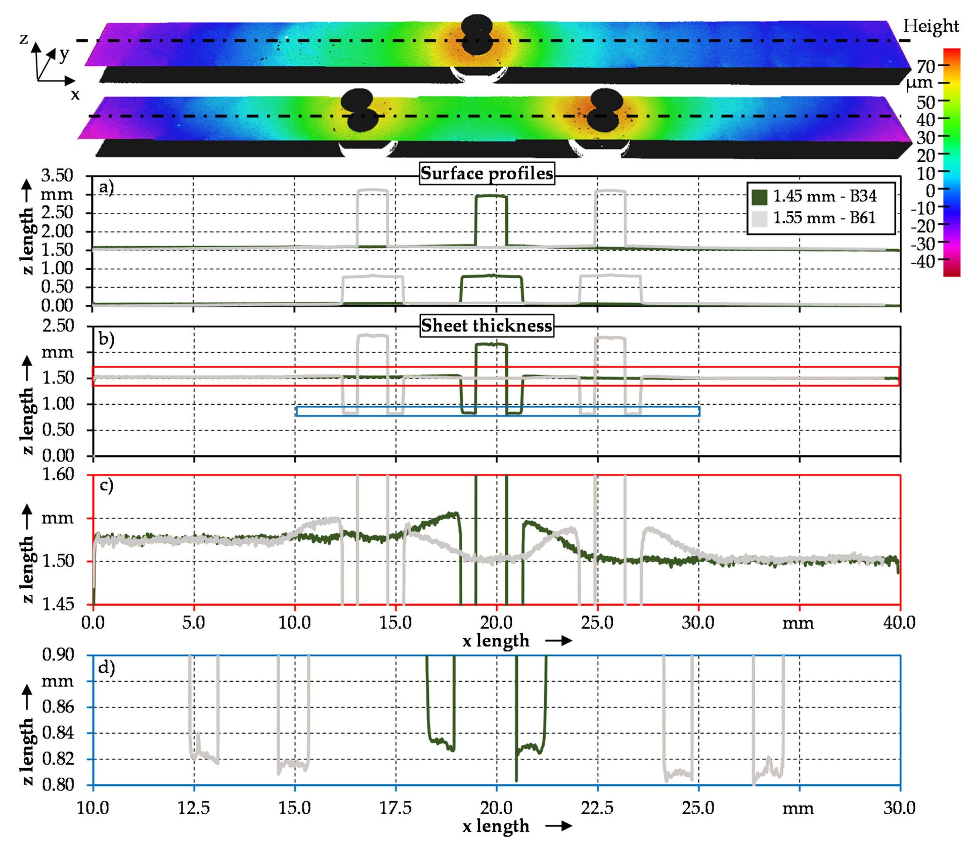

These graphs show of the surface profiles of a single and multi-pin structure, as well as the sheet thickness across the width of the sample: (a) surface profiles of the measured specimens, (b) corresponding sheet thickness, (c) detailed view of the red area marked in subfigure (b) and (d) detailed view of the blue area marked in subfigure (b). Source: Institute of Manufacturing Technology

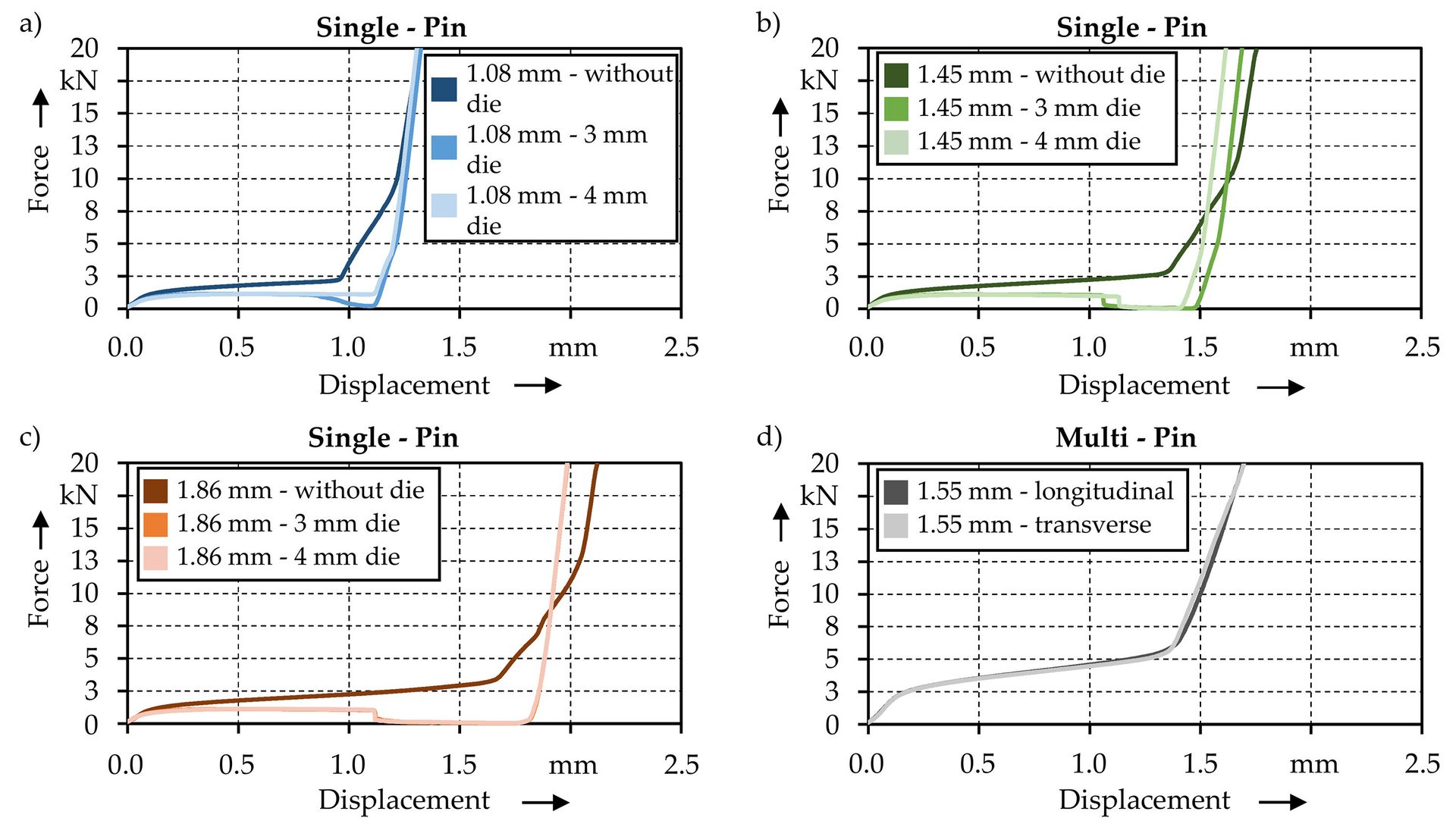

The pressing process can be divided into three phases.
Phase 1 begins with a linear increase in force while the system deforms elastically, both with and without a die. As the joining process progresses, the force increases further due to work hardening and plastic deformation. Shortly after a tool displacement of approximately 0.3 millimeter and a force of 1,100 newtons, a plateau with a constant tool force is reached. Here, the stress in the aluminum sheet introduced by the pin is so high that the material is axially displaced by the pin into the die, with the pin acting as a kind of shear punch. As the penetration of the pin progresses, a slight decrease in force can be detected due to the decreasing residual sheet thickness above the pin.
Phase 2 then begins with the abrupt failure of the aluminum sheet, at a displacement of about 1.1 millimeters. The force drops rapidly to 270 newtons, then further to almost zero, and subsequently stays there until the tool displacement has reached the pin height. The drop in force is due to the formation of a circular crack on the surface of the aluminum sheet. The crack continues to propagate until the material has been separated completely and a circular hole has formed.
Phase 3 begins when the aluminum comes into contact with the surface of the steel. The force increases linearly due to the elastic deformation and marks the end of the joining process.
The force-displacement curve for the multi-pin assemblies was similar. However, the force requirement increases linearly with the number of pin structures. For example, with 1.45-millimeter pins, phase 2 starts at a displacement of 1.38 millimeters and force of 6,336 N for the multi-pin specimen, compared to a displacement of 1.3 millimeters and a force of 3,200 newtons for a single-pin assembly.

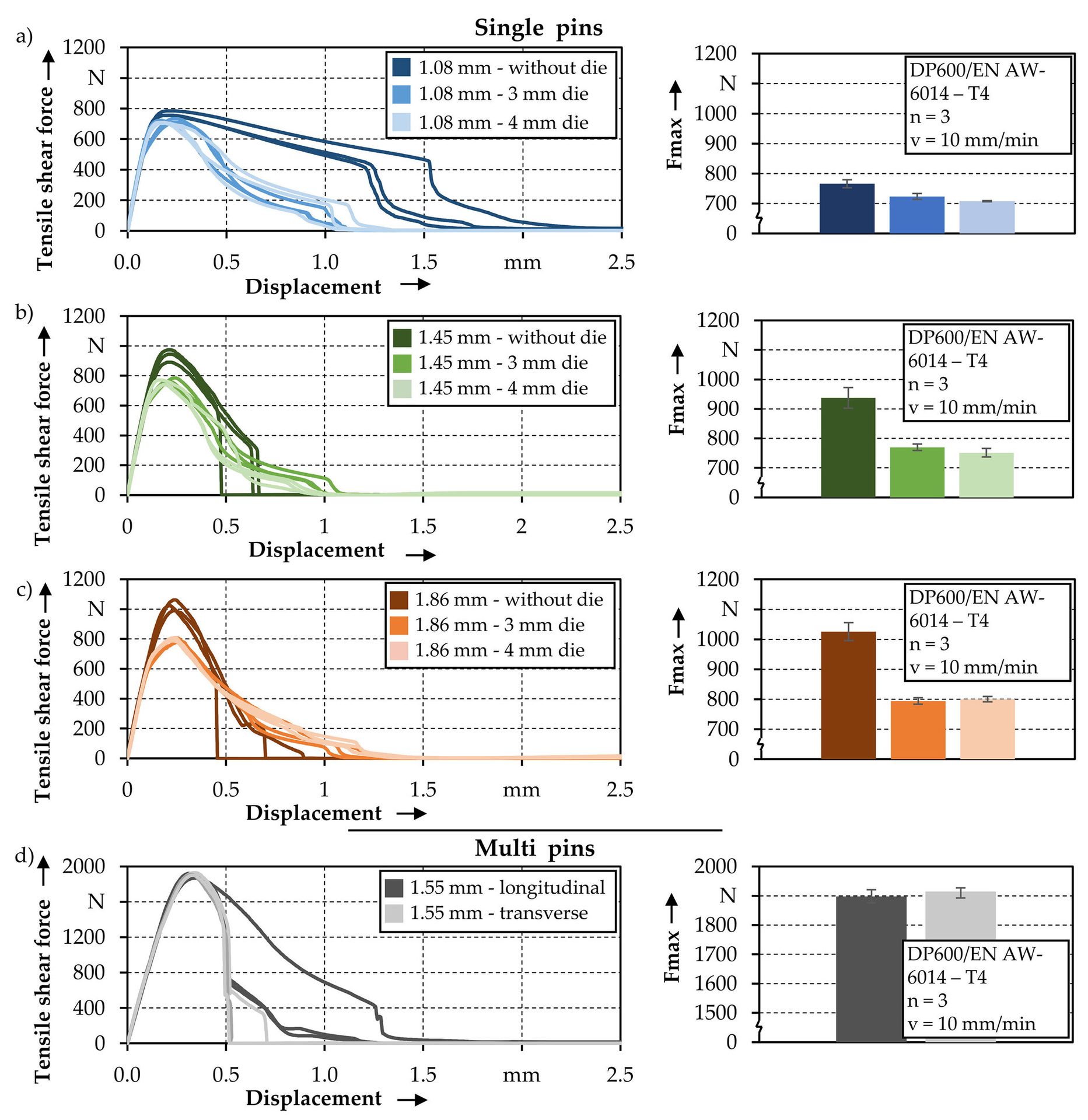

Here are the force-displacement curves (a) when joining 1.08 millimeter pins with and without a die, (b) 1.45 millimeter pins with and without a die, (c) 1.86 millimeter pins with and without a die and (d) 1.55 millimeter multi pin structures. Source: Institute of Manufacturing Technology
Tensile Shear Testing
Our data indicate that tensile shear strength increases with the height of the pins. For a pin height of 1.08 millimeters, a maximum tensile shear force of 766 ±13 newtons was achieved. For a pin height of 1.45 millimeters, the maximum tensile shear force was 938 ±35 newtons, which is 22.5 percent higher than that for the 1.08-millimeter pins. By increasing pin height to 1.86 millimeters, the tensile shear strength increased to 1,025 ±30 newtons, which is 33.7 percent higher than that for the 1.08-millimeter pins.
This increase in tensile shear strength can be attributed to the improved form fit. When longer pins are inserted into the joining partner, more pin volume is compressed, which increases the maximum head diameter of the pin and thus increases the form fit. With a pin height of 1.08 millimeters, the maximum head diameter is 1.64 millimeters. With a pin height of 1.45 millimeters, the head diameter is 1.68 millimeters. And, with a pin height of 1.86 millimeters, the head diameter is 1.71 millimeters.

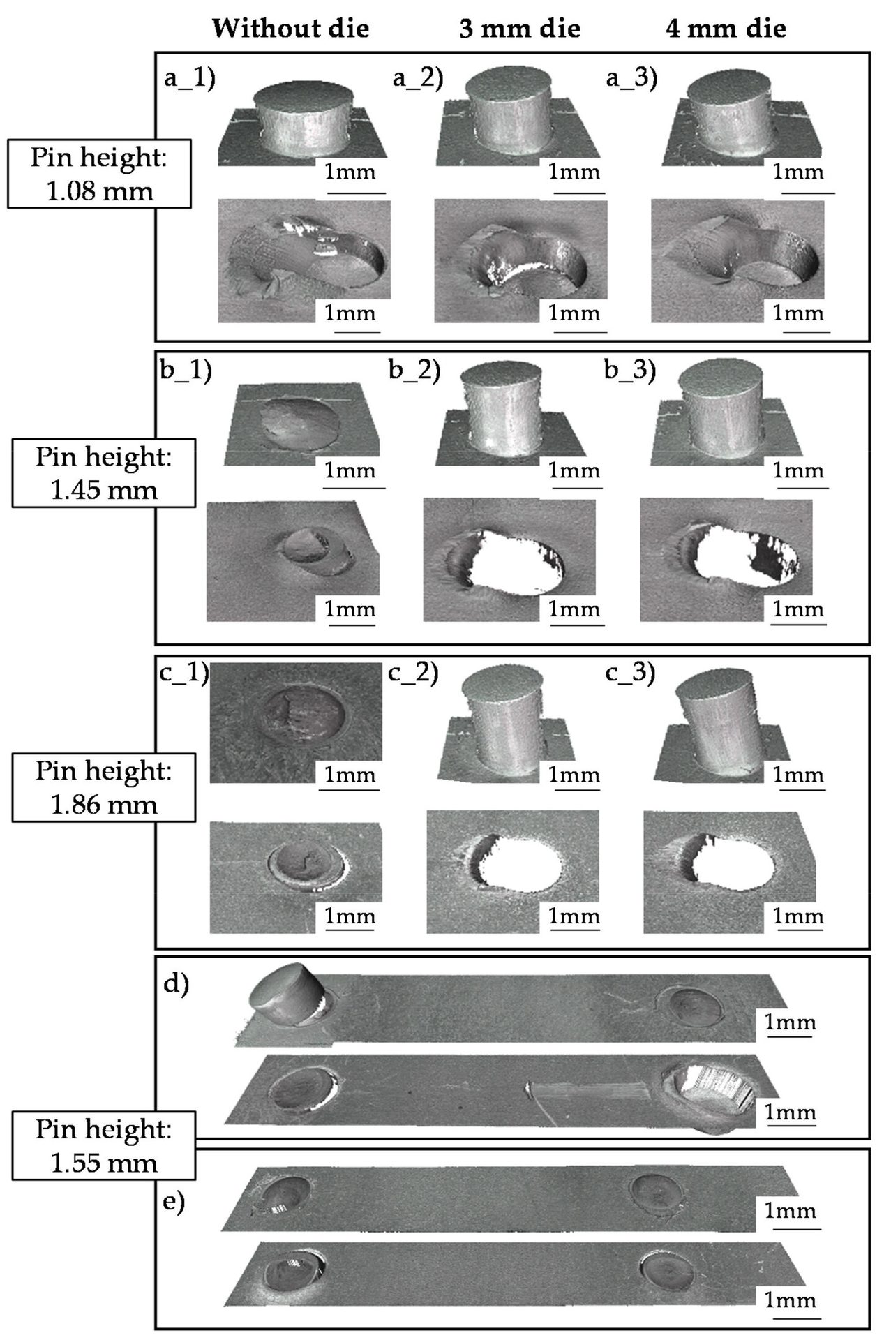

The increased form fit with taller pins is also evident when looking at the damage patterns from tensile testing.

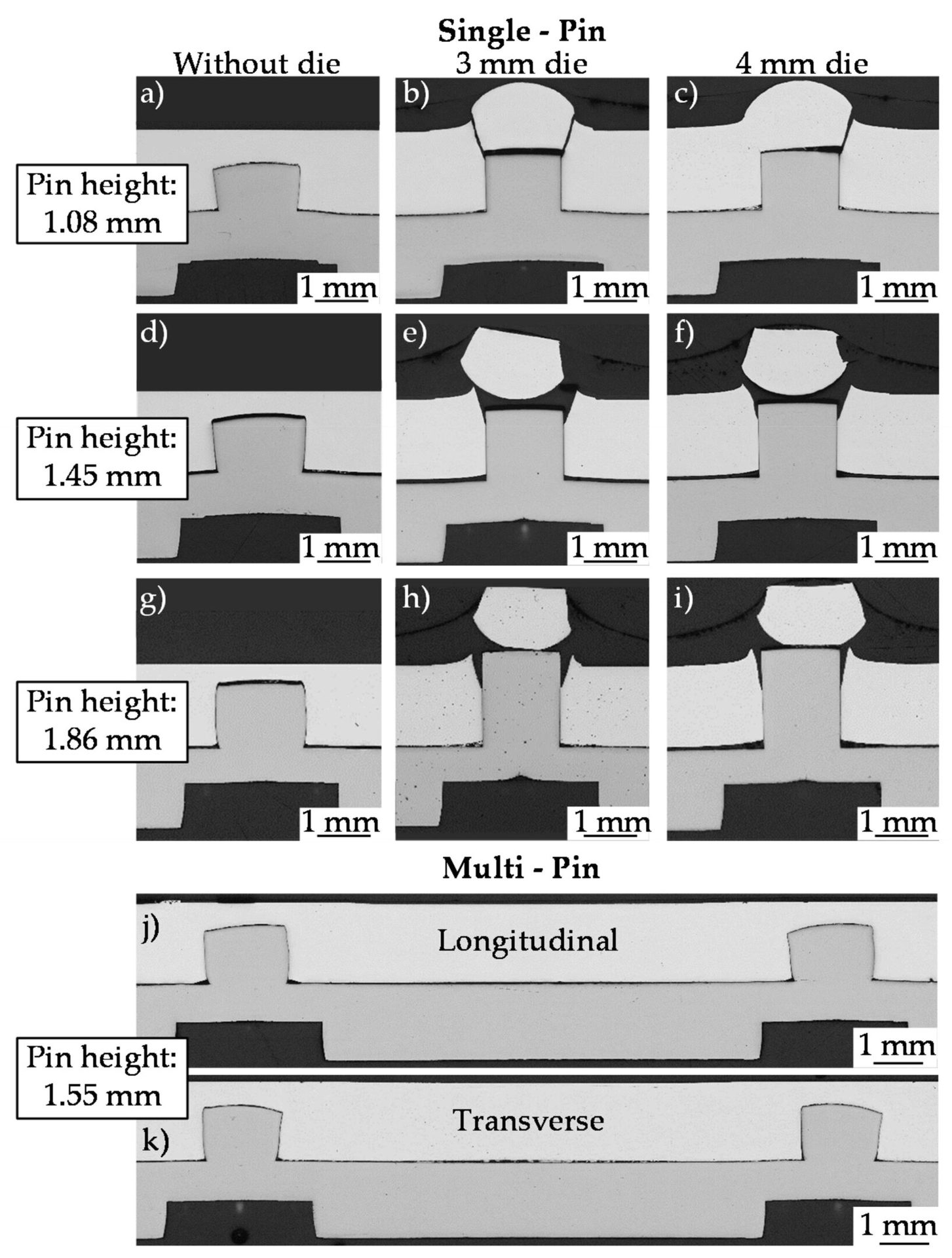

This image shows micrographs of the various joints produced in this study: (a) 1.08 millimeter pin joined without a die, (b) 1.08 millimeter pin joined with 3 millimeter with a die, (c) 1.08 millimeter pin joined with a 4 millimeter die, (d) 1.45 millimeter pin joined without a die, (e) 1.45 millimeter pin joined with a 3 millimeter die, (f) 1.45 millimeter pin joined with a 4 millimeter die, (g) 1.86 millimeter pin joined without a die, (h) 1.86 millimeter pin joined with a 3 millimeter die, (i) 1.86 millimeter pin joined with a 4 millimeter die, (j) two 1.55 millimeter pins in a longitudinal arrangement, and (k) two 1.55 millimeter pins in a transverse arrangement. Source: Institute of Manufacturing Technology
This shows the damage patterns of the joints after tensile shear strength testing. The steel sheet is on top; the aluminum sheet is on the bottom: (a1) 1.08 millimeter pin joined without a die, (a2) 1.08 millimeter pin joined with a 3 millimeter die, (a3) 1.08 millimeter pin joined with a 4 millimeter die, (b1) 1.45 millimeter pin joined without a die, (b2) 1.45 millimeter pin joined with a 3 millimeter die, (b3) 1.45 millimeter pin joined with a 4 millimeter die, (c1) 1.86 millimeter pin joined without a die, (c2) 1.86 millimeter pin joined with a 3 millimeter die, (c3) 1.86 millimeter pin joined with a 4 millimeter die, (d) 1 two 1.55 millimeter pins in a longitudinal arrangement, and (e) two 1.55 millimeter pins in a transverse arrangement. Source: Institute of Manufacturing Technology
With a pin height of 1.08 millimeters, the pin is almost undamaged after shearing. This is because the bending moment at the connection point between the pin and the sheet metal is significantly smaller than with larger pins. Since the steel is much stronger than the aluminum, the latter is plastically deformed. After reaching the maximum tensile shear strength, the form fit is reduced due to the plastic deformation and the aluminum is grooved. With increasing shear pull, the form fit decreases until the pin is completely pulled out of the aluminum.
With a pin height of 1.45 millimeters, the aluminum is also deformed plastically at the beginning of the tensile shear test. After reaching the tensile shear strength, the force decreases continuously. This is explained by the fact that the pin structure in the joining partner is slowly sheared off as a result of the good form fit. At the same time, the cross section at the pin structure’s junction with the sheet metal continues to decrease. After a certain displacement value, the pin is sheared off due to the reduced cross section and the associated higher stress.
The tensile shear strength of the pins pressed without a die was higher than that of the samples pressed with a die, independent of pin height. However, the samples pressed with a die were very similar in terms of shear strengths. Thus, the die diameter had only a minor effect on the tensile shear strength.
Looking at the multi-pin assemblies, the tensile shear strength increased significantly by adding another pin. For example, at a pin length of 1.45 millimeters, two pins in a longitudinal arrangement produced a tensile shear strength of 1,898 ±22 newtons, a 102 percent increase compared with a single pin. Similarly, two pins in a transverse arrangement produced a tensile shear strength of 1,915 ±12 newtons, a 104 percent increase.
Similar results were obtained for other pin heights: Adding an extra pin leads to a doubling of the maximum tensile shear strength.

These are the tensile shear force-displacement curves, corresponding maximum force, for the various assemblies: (a) 1.08 millimeter single pins joined with and without a die, (b) 1.45 millimeter single pins joined with and without a die, (c) 1.86 millimeter single pins joined with and without a die, and (d) two 1.55 millimeter pins. Source: Institute of Manufacturing Technology
