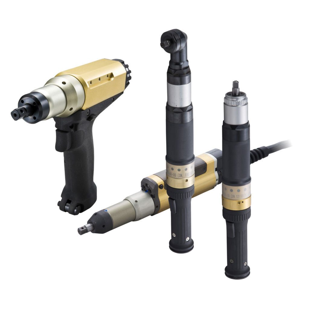

Technology Prevents Cross-Threading
Liquid
The HFC3000II and Micro-Nutrunner tools eliminate the need to manually start threaded fasteners to prevent cross-threading.
The tool’s safe-start function actively monitors the fastener as it counter-rotates on the workpiece. With the fastener preloaded into the socket, the tool rotates in the loosening direction. This continues until the tool’s pulse technology detects a consistent and distinct vibration of the screw rolling from the top of the thread down to the thread below on the workpiece.
The pulse detected by the tool must be both consistent and distinct. A distinct pulse indirectly indicates that the tool is aligned with the threads to correct thread misalignment. This prevents side load, a common cause of cross-threading and tool wear. The consistency of the pulse ensures that the exact top of the thread is detected to correct fastener misalignment. Fastening only occurs at the precise angle of thread alignment, another cause of cross-threading.
With this data, the exact depth can be determined, allowing for the detection of missing washers or even the compression of a liquid gasket.

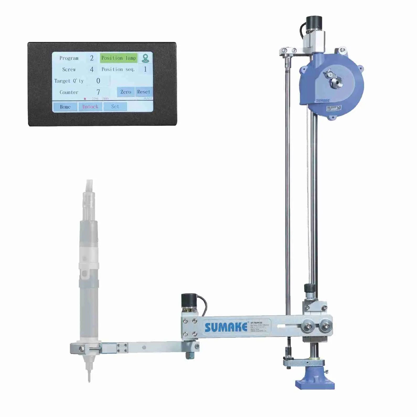

Control Arm Error-Proofs Fastening
Product, Line
Position-control torque arms play a crucial role in actively overseeing and regulating torque levels in assembly operations, along with managing the sequence of fastener application in real-time. The device consists of a control box and an articulated torque arm. It integrates seamlessly with Sumake’s brushless torque screwdrivers and transducer screwdrivers.
The arm offers support, stability and control during the screwdriving process. The arm is equipped with encoders that offer feedback on the screwdriver’s position, enabling real-time monitoring and adjustment of torque levels and fastener order. This ensures screws are tightened to precise specifications in the correct sequence.
Mounted near the workstation or assembly line, the arm secures the screwdriver in place, preventing movement or shaking during operation. This support guarantees the screwdriver remains steady, allowing for accurate and precise fastening.
As the electric screwdriver applies torque to drive the screw, a reactive force may be exerted in the opposite direction. The torque arm absorbs this force, preventing it from affecting the worker or the assembly process. This absorption maintains stability and control, which is crucial when working with delicate or precise components.
The torque arm provides smooth motion control, enabling the user to guide the screwdriver precisely to the desired location. This control is essential for achieving consistent torque levels and avoiding over-tightening or under-tightening of screws.

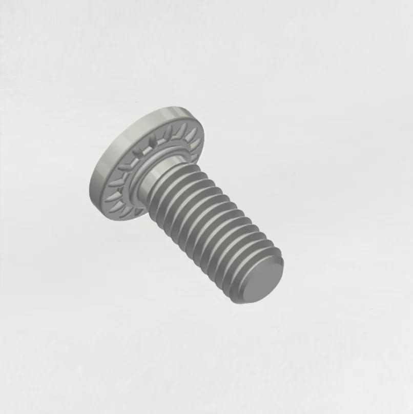

Self-Clinching Stud for Hard Metal
Automotive tire
Strux HM is a self-clinching stud for hard sheet metal. The fastener uses the same hole size and installation method as the company’s Strux self-clinching studs, which are designed for softer materials.
Strux HM features a new rib profile, equally spaced around the head, that prevents rotation after being staked into the sheet. A collar displaces metal into a retaining groove, which allows the material to flow inward to secure the stud. A retaining ring provides a barrier for displaced material to prevent push-out. The fastener provides significantly higher torsional resistance in steel vs. competing products. The stud can be installed in-die or using automated equipment.

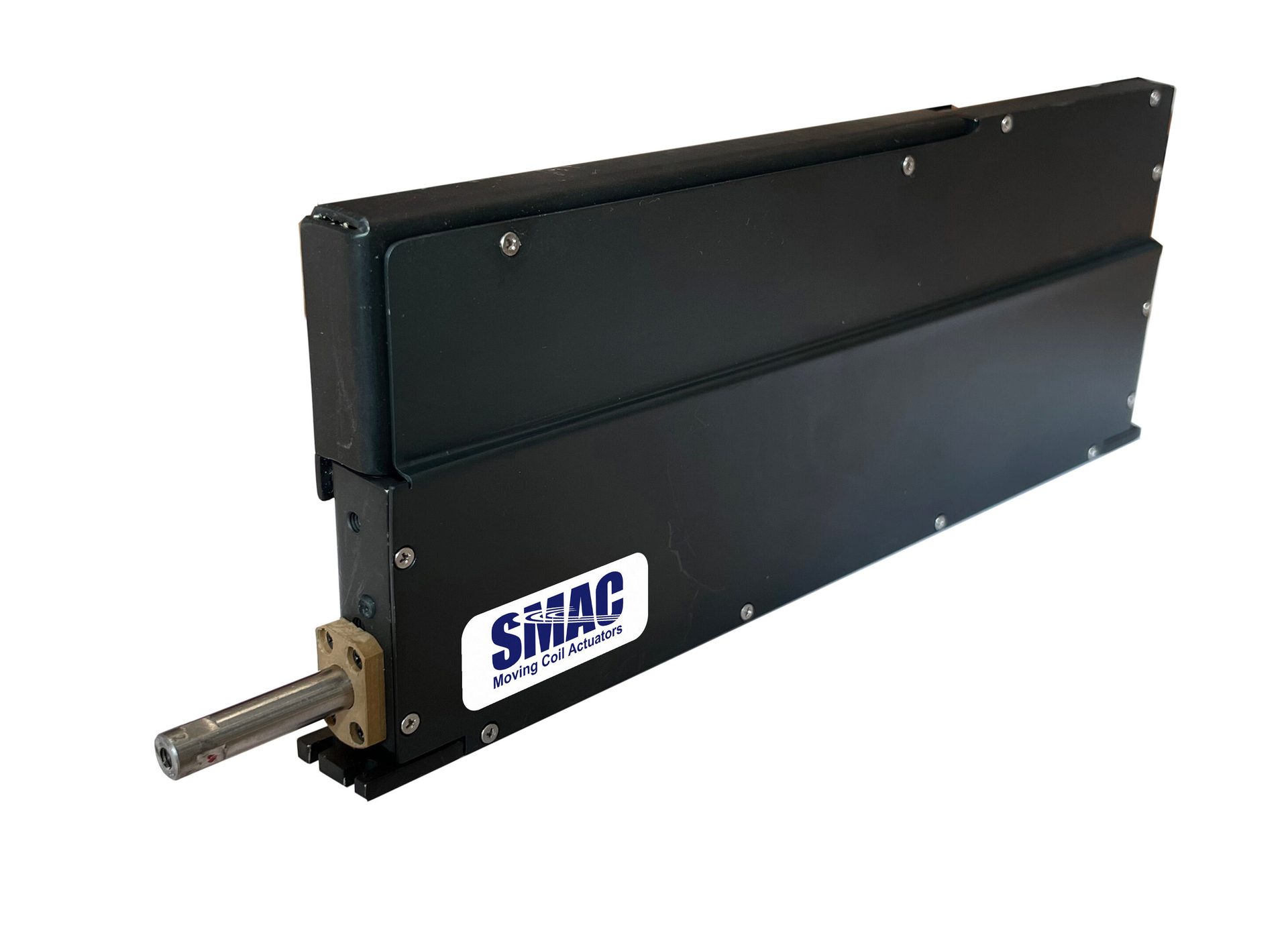

Actuators for Automated Screwdriving
Rectangle
The LBR and LDR series of linear rotary actuators feature “smart driver” technology for inserting and tightening threaded fasteners in automated assembly systems.
The actuators are ideal for applications such as electronics assembly, where small screws and delicate materials pose unique challenges.
Small screws are notoriously difficult to assemble, often leading to issues such as cross-threading and damage to tapped threads. The actuators ensure precise screw insertion by detecting the screw top, verifying the thread match, and monitoring screw movement in real-time.
The LBR and LDR verify a precise thread match every time, eliminating cross-threading. Using a 1-micron encoder, the actuator rotates counterclockwise, recognizes the drop in the first thread pitch, defines the thread, and then begins its clockwise rotation to tighten the screw.
