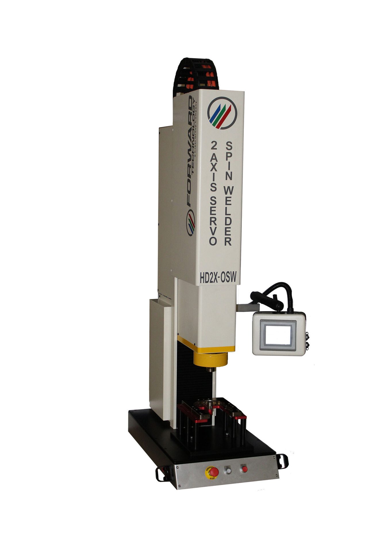

The HD-OSW servo spin welder has received a major upgrade, providing greater performance, user-friendly features, and easier integration into for automated assembly systems. Photo courtesy Forward Technology
Servo-Driven Spin Welder
Rinco’s sister company, Forward Technology, has introduced a newly upgraded version of its HD-OSW servo spin welder. The machine has undergone a major upgrade, providing greater performance, user-friendly features, and easier integration into for automated assembly systems.
“We see strong market demand for our upgraded HD-OSW model, which is an economical, high-performance option that ensures ease of use and integration for both customers and integrators alike,” says Brett Raisanen, president of Forward Technology.
The spin welder provides a range of user-friendly features to facilitate operation with a minimal need for assistance or training. Among the new updates are a fully revamped electrical architecture and controls, higher resolution touch screen, the look and feel of a tablet computer, and an enhanced servo drive for greater performance.
The machine also offers easier export of logged data; easier integration of the machine into plantwide SCADA systems or other network infrastructure; and multiple communication protocol options for ease of integration. This is important for machine builders that now have the option of using their native control architecture without engineering fees or changes to a standard machine.
While the ram is driven by a pneumatic cylinder, the rotation is controlled by a servomotor. The machine is designed for larger diameter, more difficult spin welding applications requiring delivery of high rotational power while maintaining the highest degree of precision.
However, the machine can also be used for small, intricate parts. The high-performance servo package allows for precise torque control in addition to instantaneous stopping, which is required to prevent a small weld from breaking. The machine can orient part halves relative to each other with a positioning accuracy of ±1 degree. Exact start and stop points can be programmed and precisely controlled.
Other improvements include simplified remote support without the need for third-party software or additional hardware; simplified electrical integration; and enhanced diagnostics and messaging for operators and maintenance staff.
