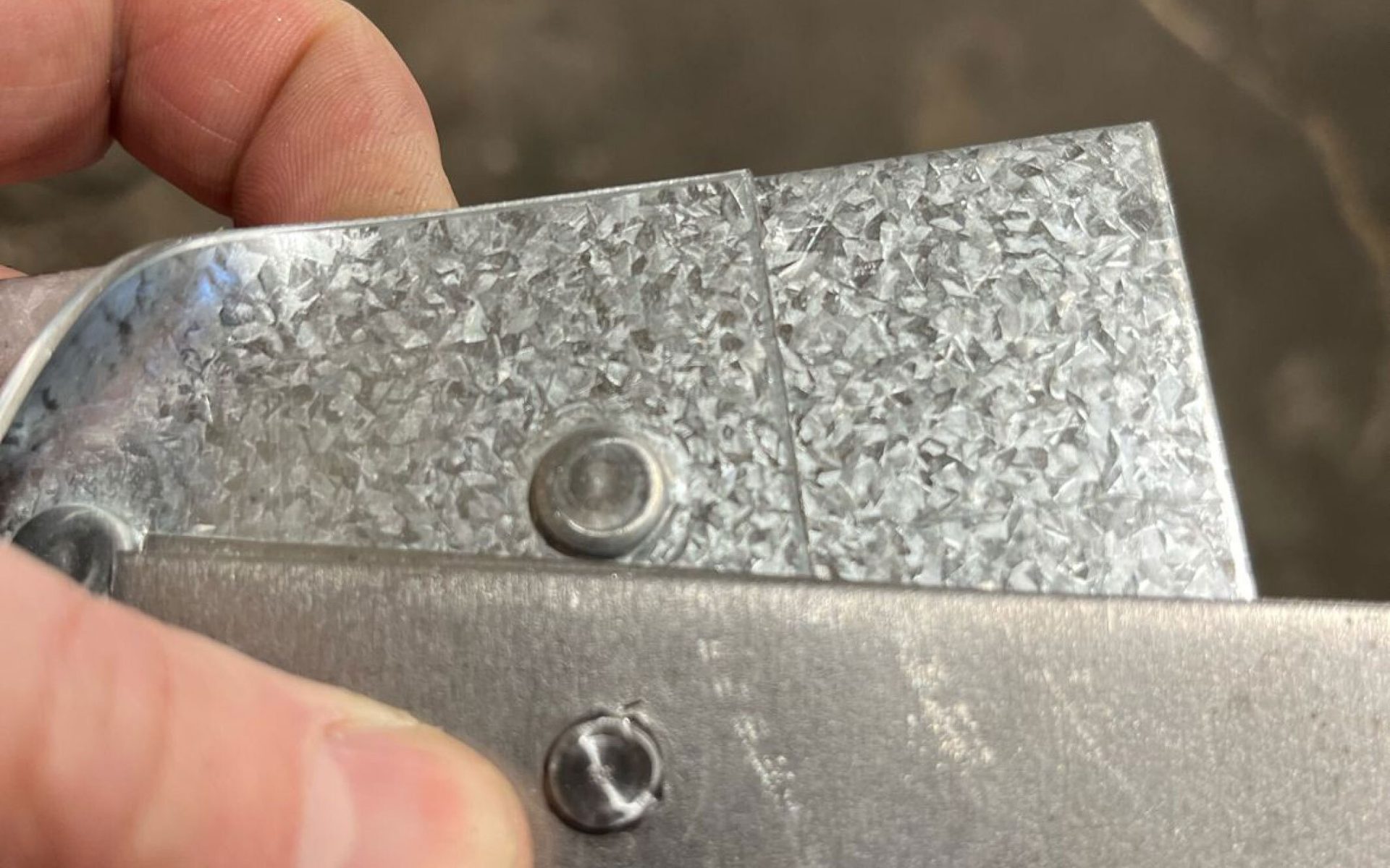

Clinching produces a round, button-like connection between two to four layers of sheet metal. The process can join metal sheets of different thicknesses. It can also join dissimilar materials, such aluminum, copper, stainless steel and titanium, without creating an isolating intermetallic phase. However, clinched joints are not as strong as spot welds.

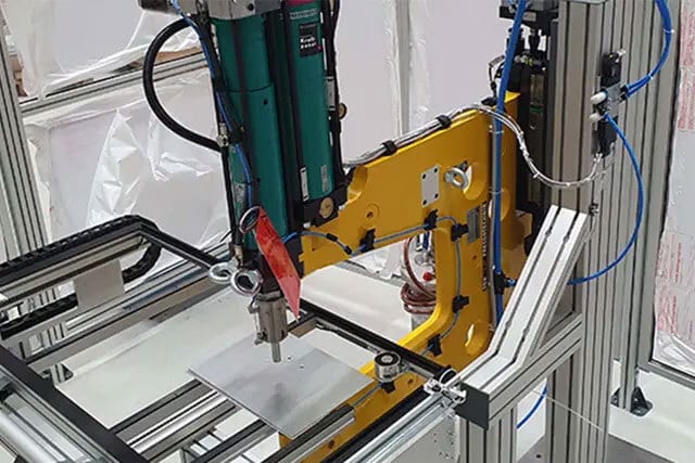

Clinching can be done manually with handheld tools or with robotic automation. A variety of benchtop, floor mounted and portable machines are available, including electric and pneumatic models.

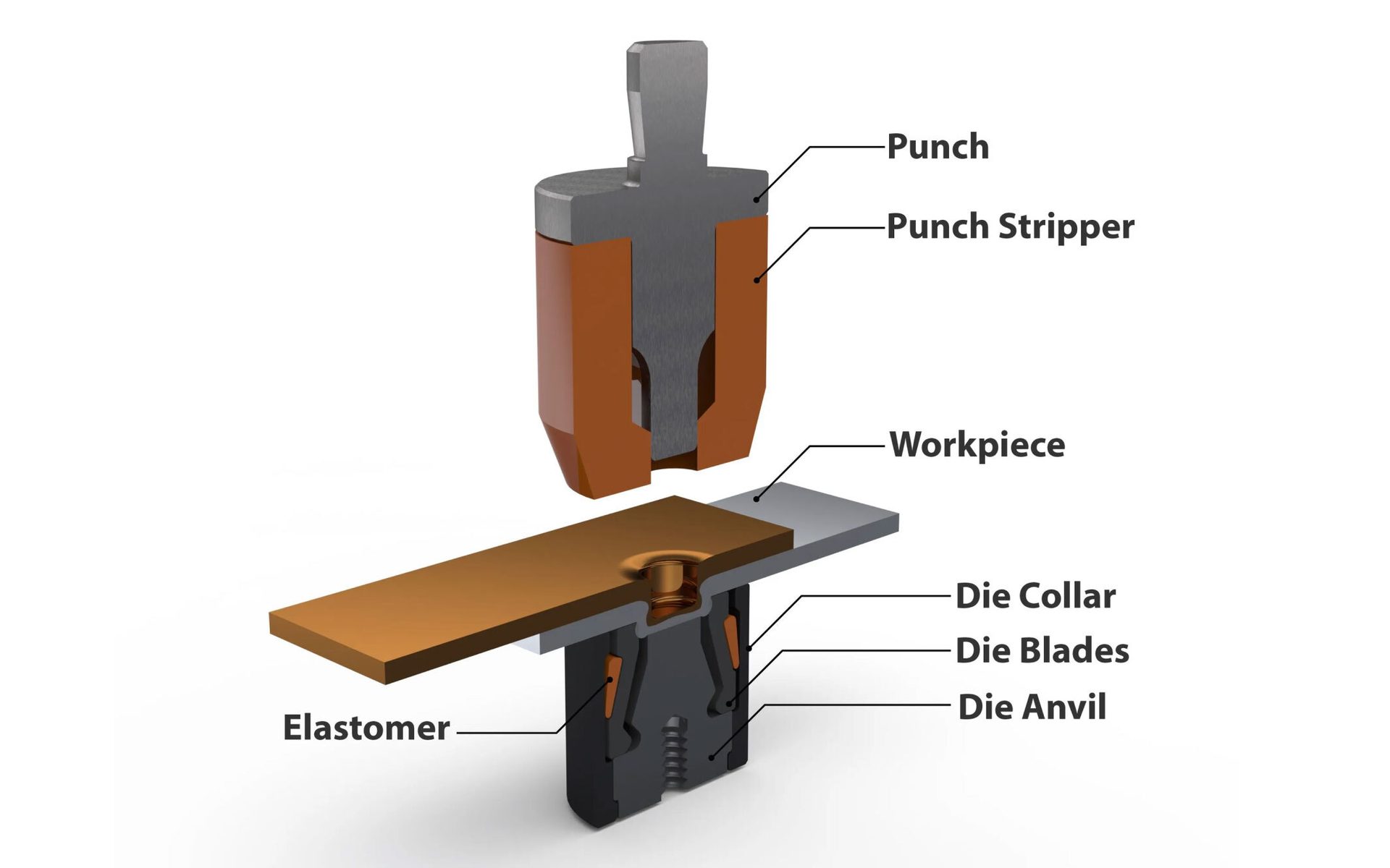

Sheet metal clinching uses a punch and a die to mechanically join material. Illustration courtesy Press Lock Technologies
Tooling consists of a punch and a die that are designed specifically for the materials to be joined. Material is pushed into the die, forming a mechanical interlock similar to a press stud.
There are two types of dies: solid, fixed-cavity dies, and dies with moving components. The punch forces the layers of sheet metal into the die cavity. The pressure exerted by the press forces the punch-side metal to spread outwards within the die-side metal. Joints typically range from 1.5 to 26 millimeters in diameter.

“Companies are also looking for clinching equipment designed for robotic integration,” Wochos points out. “Specifically, plug-and-play compatibility with major robot brands like ABB, Fanuc and Kuka.
“[Engineers want] compact, lightweight clinching units that can be easily mounted on robot arms, with standardized communication protocols and simplified programming interfaces,” notes Wochos. “Multistation flexibility is also crucial. They want systems that can handle different part geometries and material combinations, without extensive retooling.”
