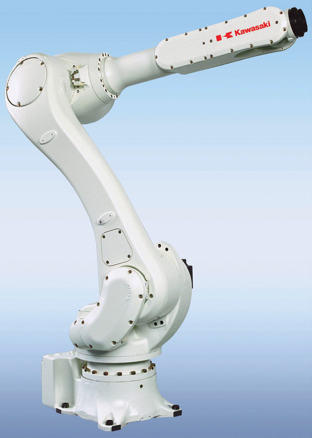

White Kawasaki industrial robot arm.
Kawasaki’s R Series robots are designed for applications requiring a long reach and small- to midsized payloads. Photo courtesy Kawasaki Robotics

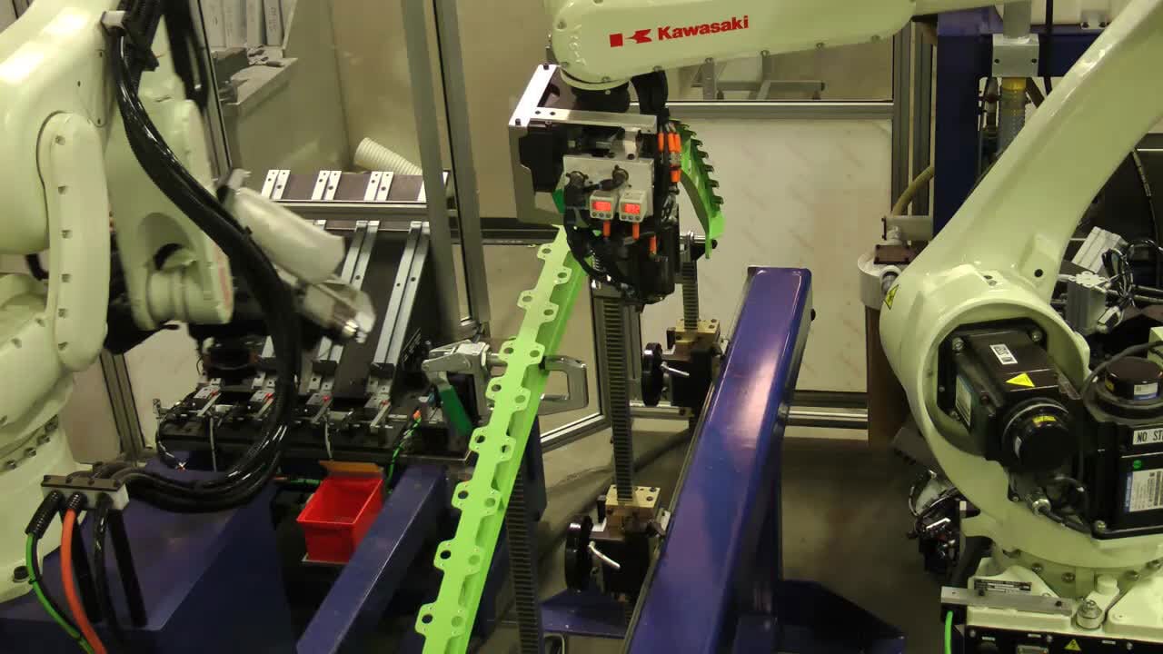

Samuel Automation designed an automated assembly cell featuring three six-axis robots from Kawasaki Robotics. Vision systems locate and identify 225 part types.
At the first station, a Kawasaki RS080N robot determines the position of the base part by scanning three distinctive features using 3D vision and adjusting its position accordingly. The robot is equipped with a multipurpose end-of-arm tool (EAOT). One side is for drilling; the other side is for riveting.
After alignment, the RS080N’s EOAT grips the base part, then drills and countersinks two holes for the rivets that will be used to secure the nut plate.
Next, the robot rotates to retrieve the rivets for the assembly. There are four lengths to choose from, depending on the size of the plate.
While the RS080N is getting the rivets, a second robot—an RS010L—picks up a nut plate. A vision system verifies that it is the correct part. (There are 28 possible types.) The robot then places the nut plate in a special custom fixture. The fixture is designed to help the robot locate the nut plate accurately on the base part. A vision system checks the fixture to ensure it is clear to receive the nut plate.

Next, the RS010L places the nut plate and fixture assembly onto a turntable so a third robot—an RS005N—can apply sealant to help protect against corrosion. The RS005N conducts two vision checks: one before and one after sealant application.
Then, the turntable rotates so the RS010L can pick up the nut plate and fixture assembly and place it onto the base part. Prior to placement, the robot scans the base part to determine its exact position. While the RS010L robot holds the nut plate in place, the RS080N robot enters the area and the two heads marry to install the rivets.
After rivet installation, the robot heads separate. The RS010L safely releases the part and rotates to drop off the fixture. The RS080N rotates its EOAT to the correct position for rivet crimping, which completes the 39-second process.
Each robot has a different reach and payload capacity. The RS080N has a maximum reach of 2,100 millimeters and can carry a maximum payload of 80 kilograms. Positional repeatability is ±0.06 millimeter. The RS010L has a maximum reach of 1,925 millimeters and can carry a maximum payload of 10 kilograms. Positional repeatability is ±0.05 millimeter. The RS005N has a maximum reach of 705 millimeters and can carry a maximum payload of 3 kilograms. Positional repeatability is ±0.02 millimeter.

A unique aspect of this application is how closely the robots work together. The heads of the RS080N and the RS010L must connect without colliding, an action that’s impossible without highly repeatable robots. Kawasaki’s R series of general purpose robots fit this criteria, with repeatability ranging from ±0.02 to ±0.06 millimeter as payload increases (3 to 80 kilograms).
The cell has been a success by many measures. Cycle time was reduced by 26 seconds, and the number of operators reduced from three to one. The cell creates a fully complete assembly; no work-in-progress stations are needed.
