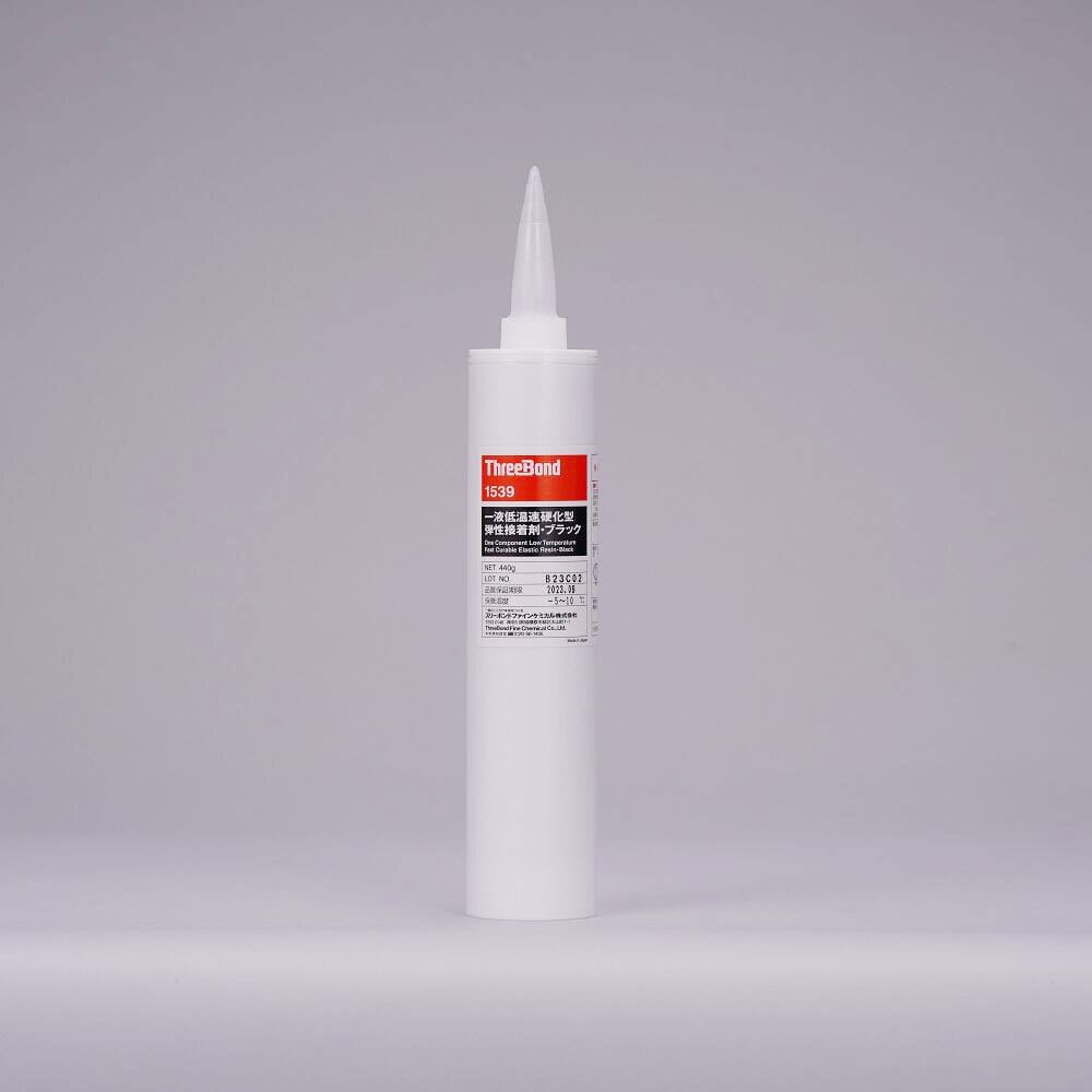

Flexible Urethane Produced From Plant-Based Materials
ThreeBond 1539 is a one-component, fast-curing elastic urethane adhesive for bonding, sealing and potting various materials. The adhesive can be cured by heating at a relatively low temperature (60 C) for a short time and does not require a long-time curing process. It uses a plant-derived polymer as the main component. The cured material is an elastic body, which is resistant to vibration and impact and excels in relaxation of stress caused by expansion and contraction of parts. It is elastic over a wide temperature range (-35 to 100 C).
It has excellent adhesion to various materials, including aluminum, steel, stainless steel, copper, phenolic resin, epoxy, acryl, ABS, polycarbonate, nylon, PET, PBT, PPS, PVC and glass.

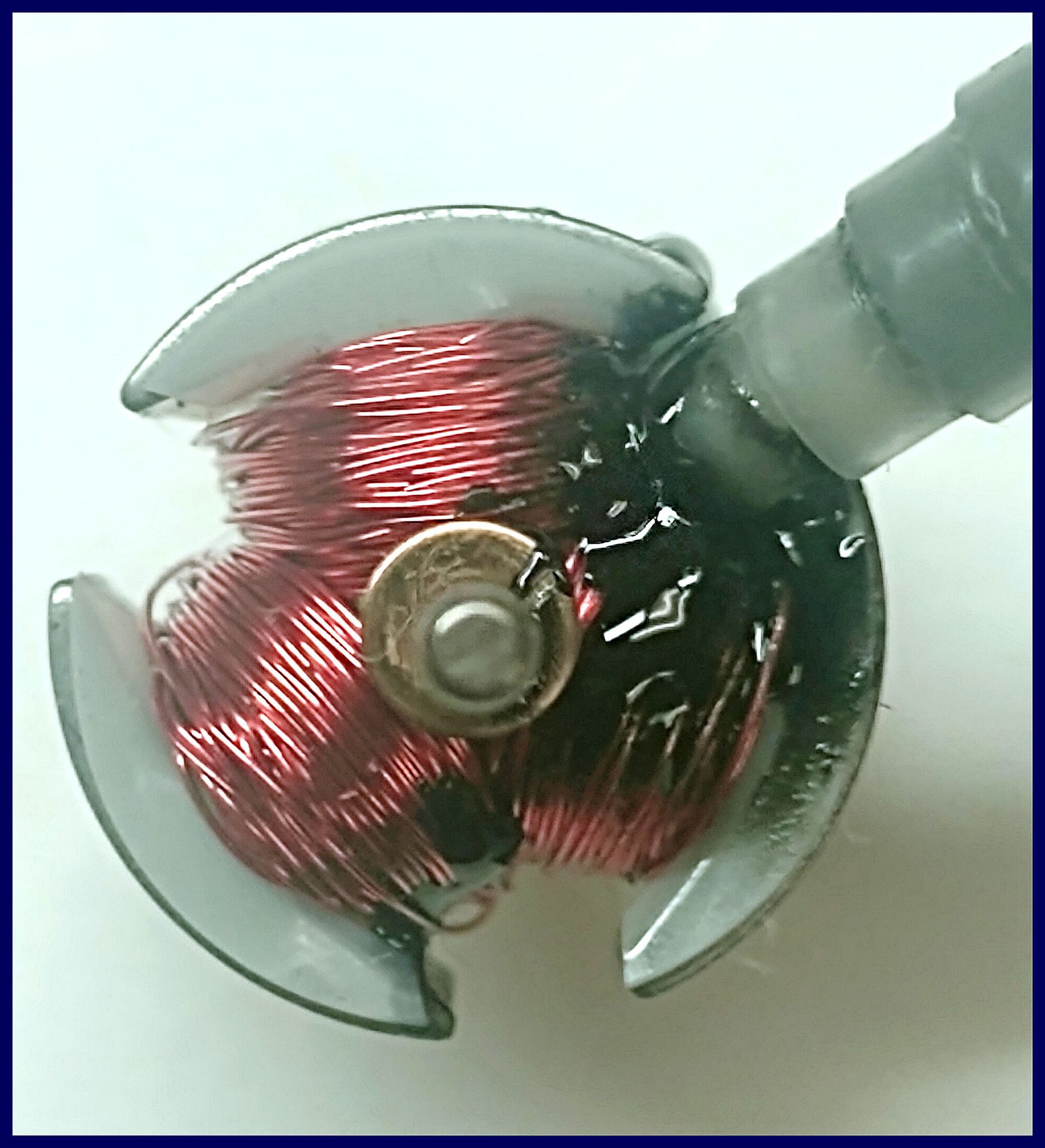

Thermally Conductive Epoxy Resists Cracking
EC-1019 is a thermally conductive epoxy potting compound. The small size of the material’s filler particles (15 microns) allow the compound to penetrate and fill intricate voids. Its thermal conductivity of 2 watts per meter-Kelvin ensures excellent heat dissipation in temperatures ranging from -40 to 220 C.
Its unique chemistry drastically reduces cracking compared with traditional, rigid materials. Its low coefficient of thermal expansion (22 parts per million per C) keeps stresses to a minimum.
It is used for tightly packed windings in motor stators and rotors, transformer coils, power supplies, and elaborate potting applications where thermal strain is a concern.
The epoxy has excellent resistance to moisture and chemicals and is a superior electrical insulator.
