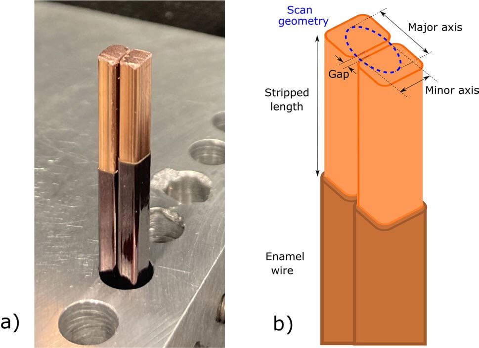

Photo of stripped rectangular enamel wires and diagram of their scan geometry.
These images show (a) the specimens during the laser welding operation and (b) a schematic description of the weld scan trajectory. Photo courtesy Polytechnic University of Milan

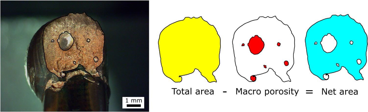

Porous material cross-section and diagram: Total Area - Macro Porosity = Net Area.
After tensile testing, we examined the fracture surfaces to learn more about how and why the joints failed. Photo courtesy Polytechnic University of Milan

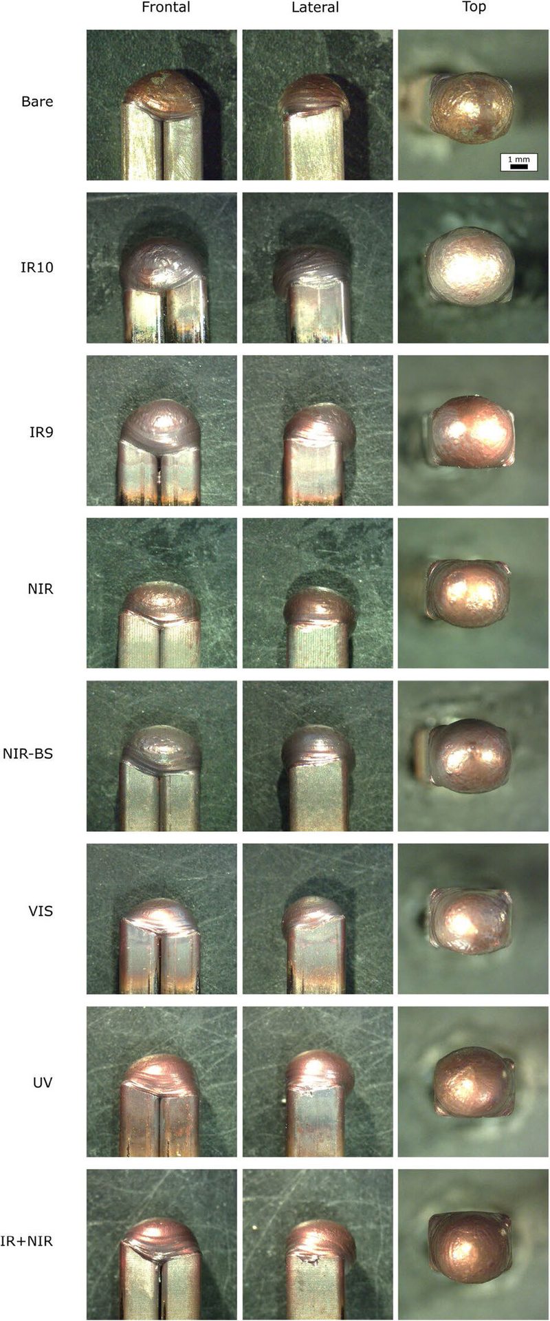

Frontal, lateral, and top views of metal samples with various surface treatments.
These optical microscopy images compare the welded hairpins. The welds are similar, regardless of which technology was used to strip the wire. Photo courtesy Polytechnic University of Milan
The hairpin material was electrolytic tough pitch copper (Cu-ETP) with an enamel coating for isolation. Cu-ETP is a widely used, high-conductivity copper known for its excellent electrical and thermal properties. The material was 3.87 millimeters wide and 2.66 millimeters thick. The enamel coating was polyamide-imide 95 microns thick.
The process parameters were chosen to remove the enamel in the shortest possible time. Each laser was run at its highest power. The spot diameter varied, depending on the laser. For example, with the IR9 and IR10 lasers, the spot diameter was 500 microns, which was ideal given the high absorptivity of the enamel to infrared wavelengths. On the other hand, with the NIR and NIR-BS lasers, the spot diameter was 39 to 50 microns to compensate for the low absorptivity of the enamel to near-infrared wavelengths. Similarly, scanning speed and hatch distance (the space between two passes of the laser beam) also varied, depending on the laser.
After stripping, the hairpin couples were laser welded using a 6-kilowatt fiber laser with a wavelength of 1.07 microns. All the hairpins were welded using the same parameters. As a control, we also welded hairpins made from copper that had never been coated with enamel.

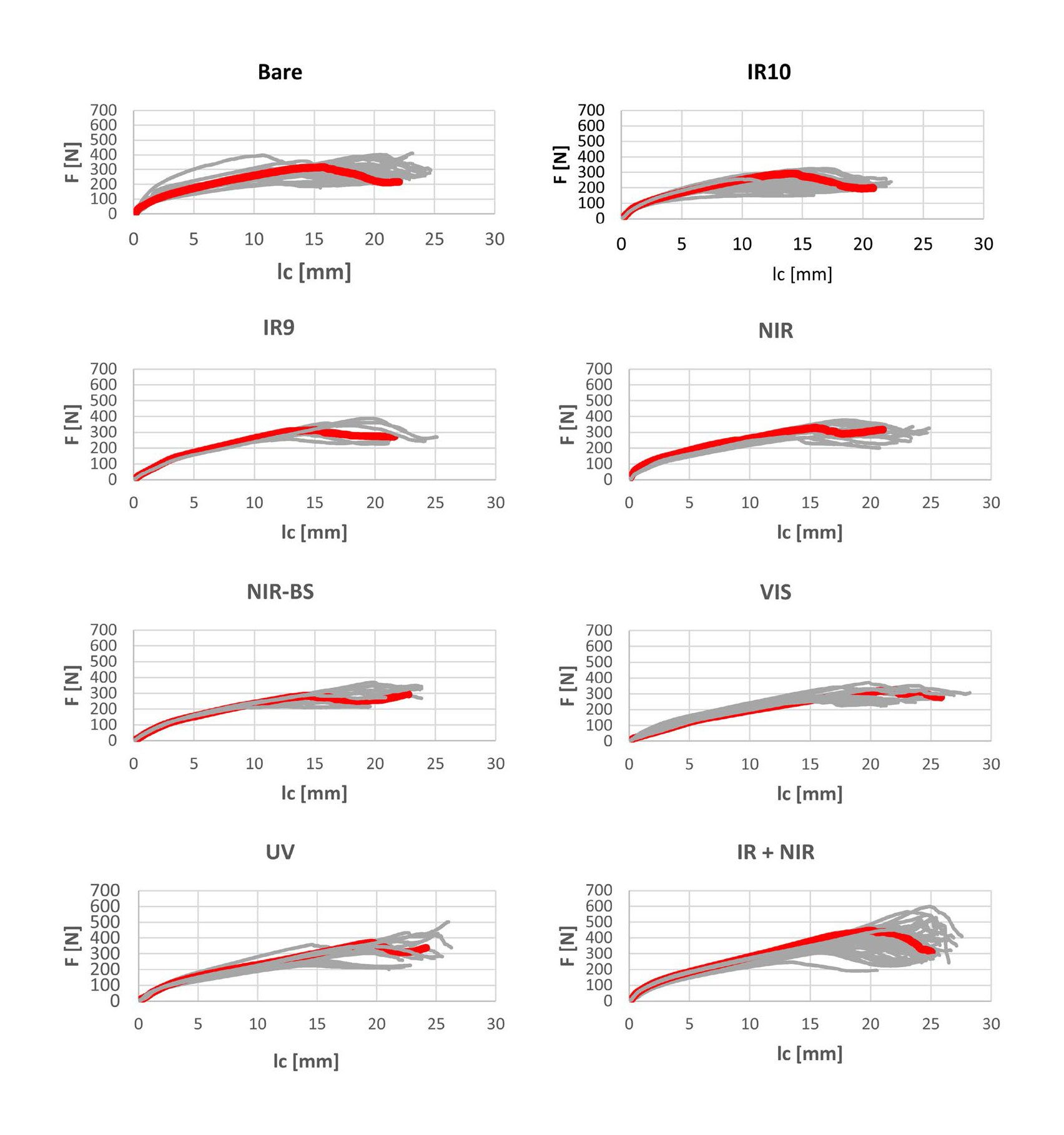

Eight force-indentation graphs: individual (gray) and average (red) curves across various conditions.
The weakest joints were produced with the copper stripped with the IR10 laser. The strongest were produced with the copper stripped by the combination of IR and NIR lasers. Photo courtesy Polytechnic University of Milan
The results of tensile tests on the welds ranged from 150 to 600 newtons, indicating that stripping quality had a direct effect on mechanical strength. Tensile tests on welds made with bare copper averaged 315 newtons. The IR9, NIR, NIR-BS, UV and VIS lasers provided comparable results. On the other hand, the weakest joints were produced with the copper stripped with the IR10 laser (average, 262 newtons). The strongest joints were produced with the copper stripped by the combination of IR and NIR lasers (average, 409 newtons).
When we did a fracture analysis of the joints produced with the copper stripped with the IR10, we found small pores in the fracture surface. These indicate polymer gases trapped in the weld, which reduced the strength of the joint.
