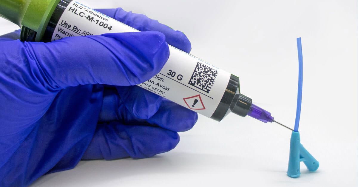

Low-Viscosity Adhesive for Medical Device Assembly
HLC-M-1004 is a low-viscosity light-curing adhesive for assembling complex medical devices. Its hybrid formula enables the adhesive to cure in both light‑exposed and shadowed areas. The adhesive cures on contact in dark areas, and it cures rapidly when exposed low‑intensity UV or visible‑light.
The adhesive is well-suited for applications involving catheters, diagnostic and therapeutic devices, and other parts that incorporate opaque or light-blocking substrates. Its low viscosity facilitates controlled dispensing and penetration into tight bond gaps, enabling consistent bond formation without the need for primers.
The silicone-free formula supports low-VOC production for improved operator safety. In addition, it contains zero isocyanates and PVC, which helps minimize environmental impact and waste.

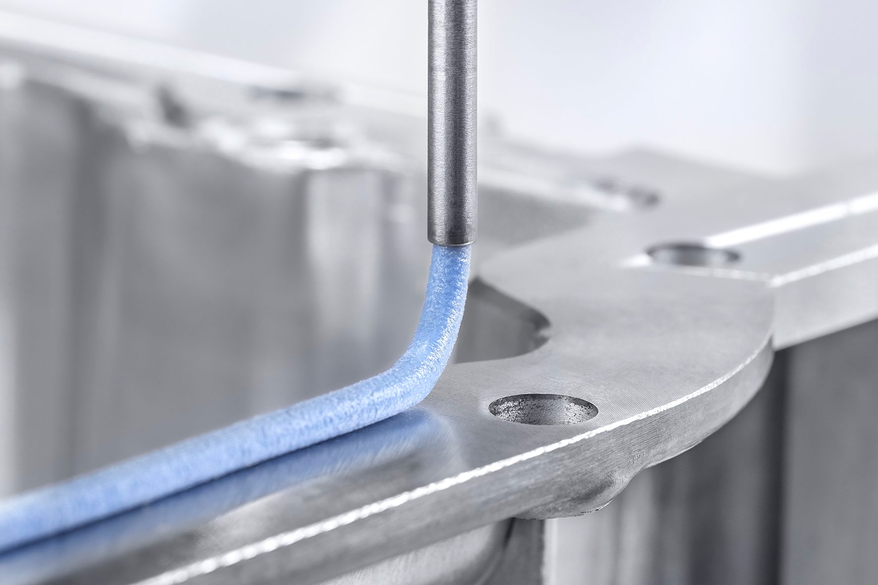

Silicone Seals High-Voltage Battery Housings
Wevosil 23130 is a silicone sealant for creating formed-in-place gaskets on EV battery housings.
The sealant ensures the housing remains airtight by forming a reliable barrier against gases and smoke that may be released during thermal runaway of the batteries. At the same time, the material is highly resistant to both mechanical and thermal stress. It also effectively prevents moisture from penetrating the housing.
Once cured, the material has a tensile strength of more than 2 megapascals. The material is resistant to hot and corrosive gases. It will retain its seal even when gas pressure inside the housing is high.
The sealant has been formulated for automated assembly lines. The filler-free silicone has excellent rheological properties, allowing it to be precisely applied using standard mixing and dosing systems—even on complex 3D geometries. At room temperature, it has a pot life of more than 24 hours. After application, localized infrared heating up to 140 C will cure the sealant in less than five minutes.

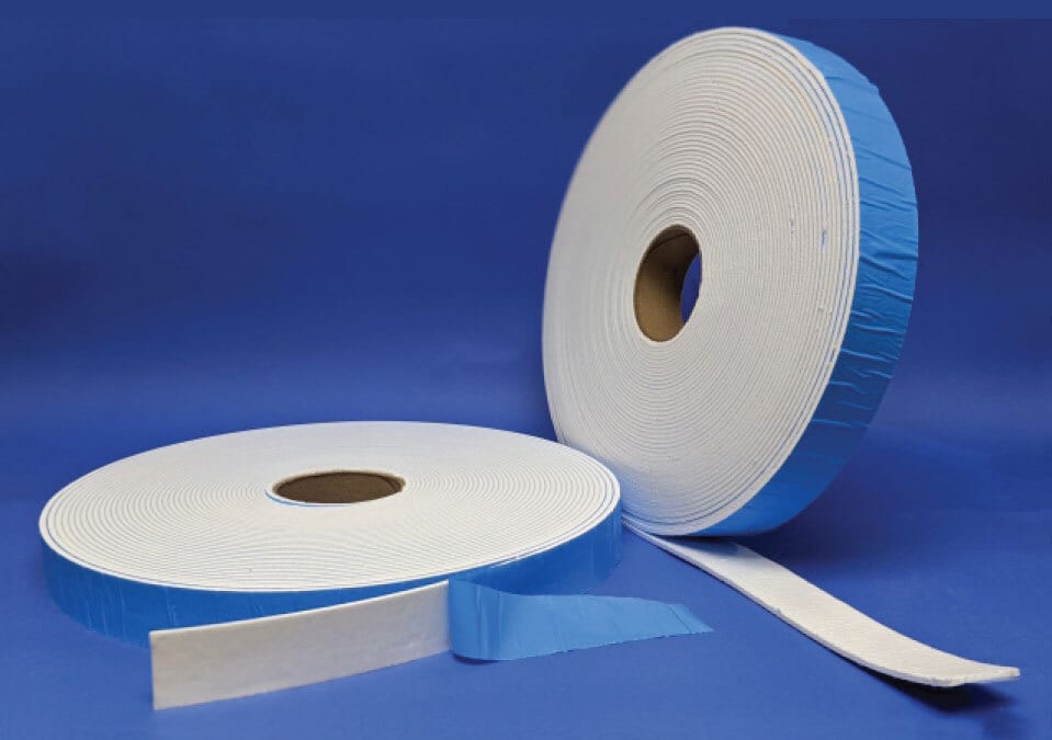

Ceramic Tape Provides Thermal Insulation
Ultra-Temp 390PS ceramic tape can be wrapped around pipes and equipment to provide thermal and electrical insulation to 2,300 F. The tape has excellent adhesion to metals, ceramic and glass.
The tape is available in four widths (1, 1.5, 2 and 3 inches) and two thicknesses (0.125 and 0.25 inch). It is made from asbestos-free, aluminum oxide based refractory fibers. These tapes have low specific heat and low thermal conductivity. They are resistant to thermal shock and offer electrical insulation, good dielectric strength and excellent corrosion resistance.
Applications include high-temperature insulation, furnace linings, mufflers, gas turbines, fans, ovens, chemical reactors, expansion joint packing, high temperature filters, fire protection, sound absorption, stress-relieving insulation and non-contaminating brazing.

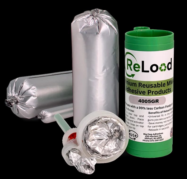

Reusable Dispensing System Reduces Waste
Reload is a reusable adhesive dispensing platform intended to support consistent delivery of two-component structural adhesives while reducing packaging waste. Compared with cartridge-style dispensing systems, Reload provides more consistent metering, less exposure to air and moisture, and less material waste. When combined with foil-based packaging, the system can reduce single-use cartridge waste by up to 99 percent.
The system accurately dispenses two-part adhesives with mix ratios of 1-to-1 and 10-to-1. The flexible foil packaging minimizes trapped air and reduces residual material left behind after dispensing. Isolating adhesive components from oxygen and moisture helps to maintain material integrity during storage and use.
The platform is engineered to work with existing manual and pneumatic dispensing equipment. New dispensing guns or proprietary static mixer tips are not required.
