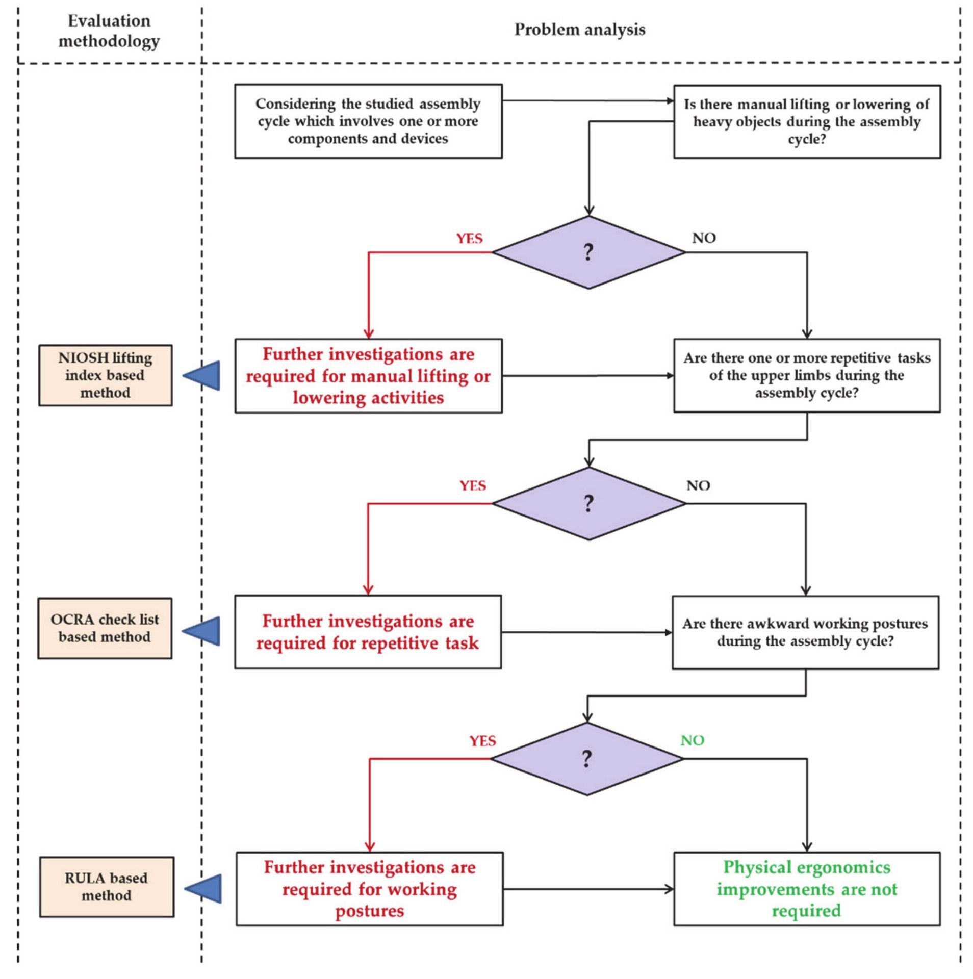

This decision tree provides a framework for identifying nonergonomic tasks that could be improved with the help of a collaborative robot. Source: Free University of Bozen-Bolzano

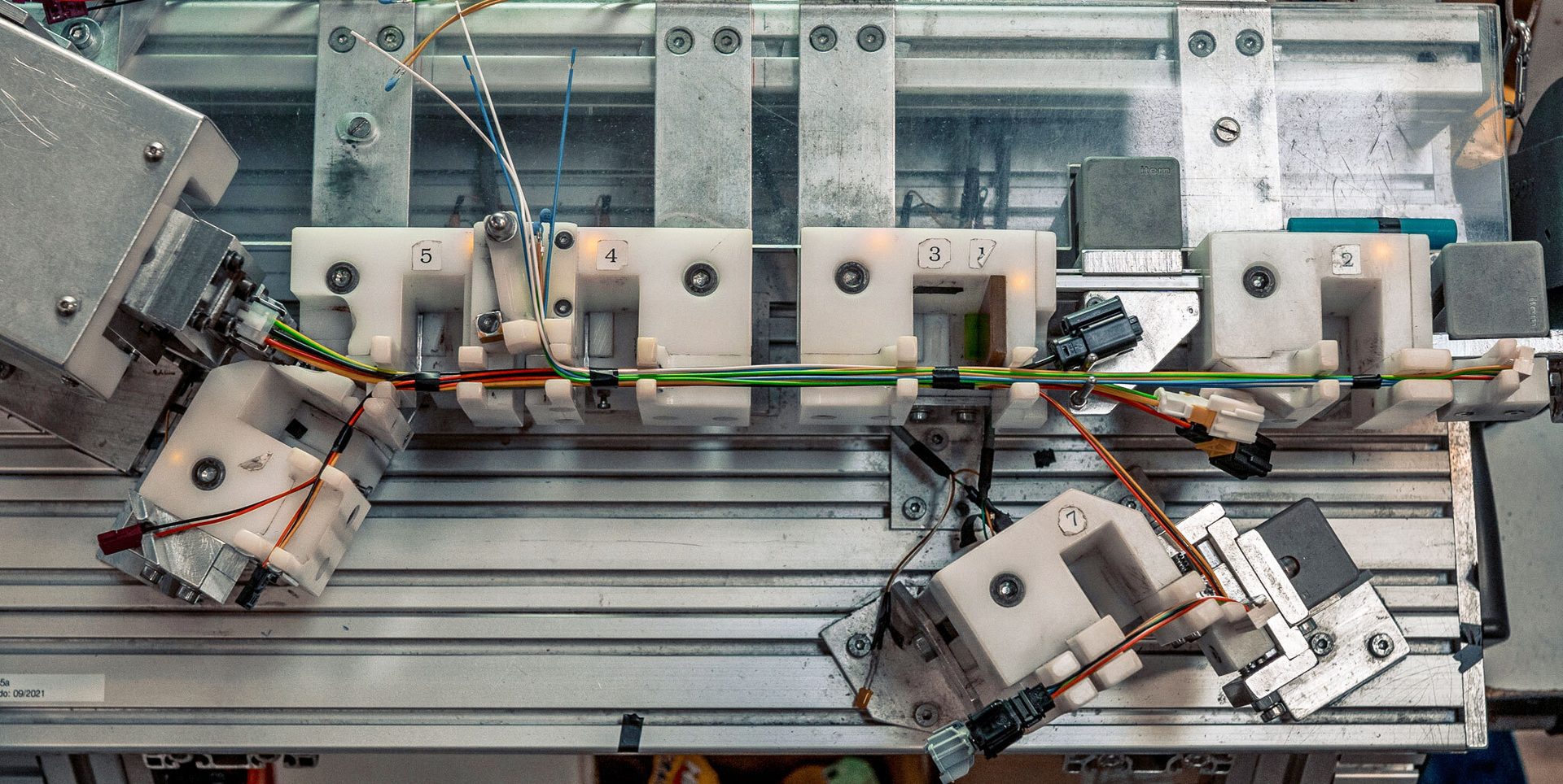

The assembly process requires workers to bundle three wire subassemblies with a taping tool. A worker sequentially inserts the subassemblies into a dedicated jig and then applies tape at seven spots. The process consists of 19 tasks:
    • Picking up the first wire harness (1) and positioning it in the jig (2).
    • Picking up the second wire harness (3) and positioning it in the jig (4).
    • Adjusting the wire harnesses (5).
    • Picking up the taping tool (6), applying tape at one spot (7), and putting down the tool (8).
    • Picking up the third wire harness (9) and positioning it in the jig (10).
    • Picking up the taping tool (11), applying tape at six spots (12-17), and putting down the tool (18).
    • Removing and storing the completed wire harness (19).

Our first step was to assess the ergonomics of the existing assembly process. Ultimately, we would want the cobot to handle the most physically demanding tasks.
To do that, we began with the ergonomic assessment method outlined in ISO Technical Report 12295. We focused primarily on the neck, trunk and upper limbs, concentrating on handling heavy objects, repetitive tasks, and awkward postures.

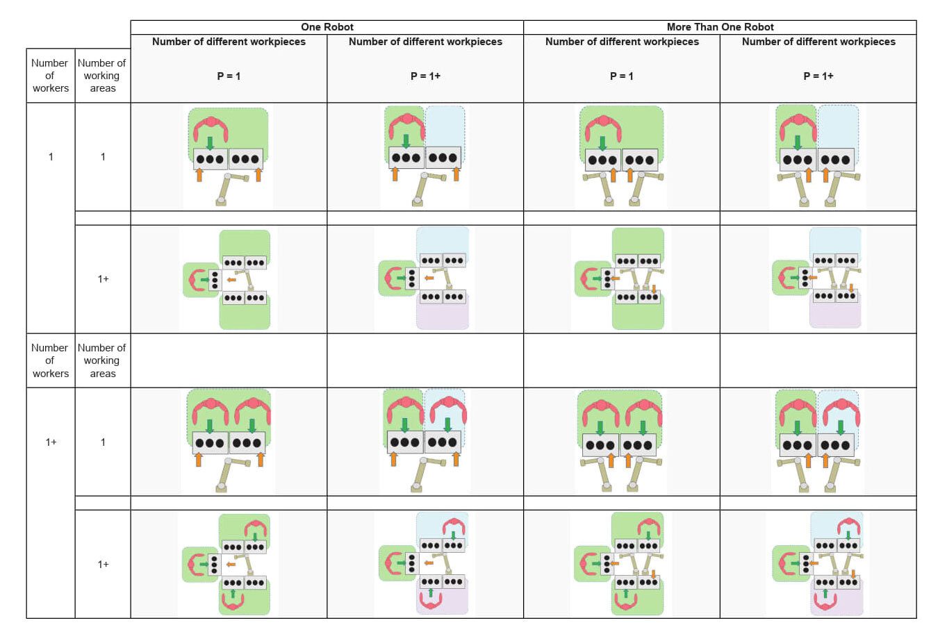

Any new line layout should be designed based on the number of robots; the number of different workpieces; the number of workers; and the number of working areas. By combining these four production variables, it is possible to identify 16 different layouts for a collaborative workstation. Source: Free University of Bozen-Bolzano
We used the following tools in our assessment:
• the National Institute for Occupational Safety and Health (NIOSH) equation for manually lifting objects.
• the Occupational Repetitive Action (OCRA) checklist for repetitive tasks.
• the Rapid Upper Limb Assessment (RULA) for working postures.
Our goal was not to calculate occupational risks, but rather to determine which tasks would be best suited for the robot and which could be left for people.

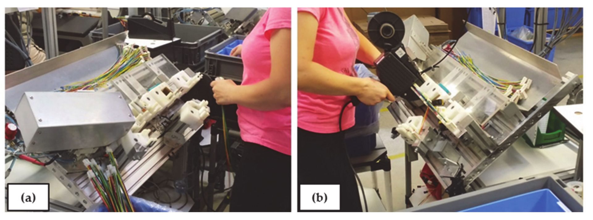

At Elvez, harness assembly tasks can be classified into two groups: insertion (a) and taping (b). Photos courtesy Free University of Bozen-Bolzano

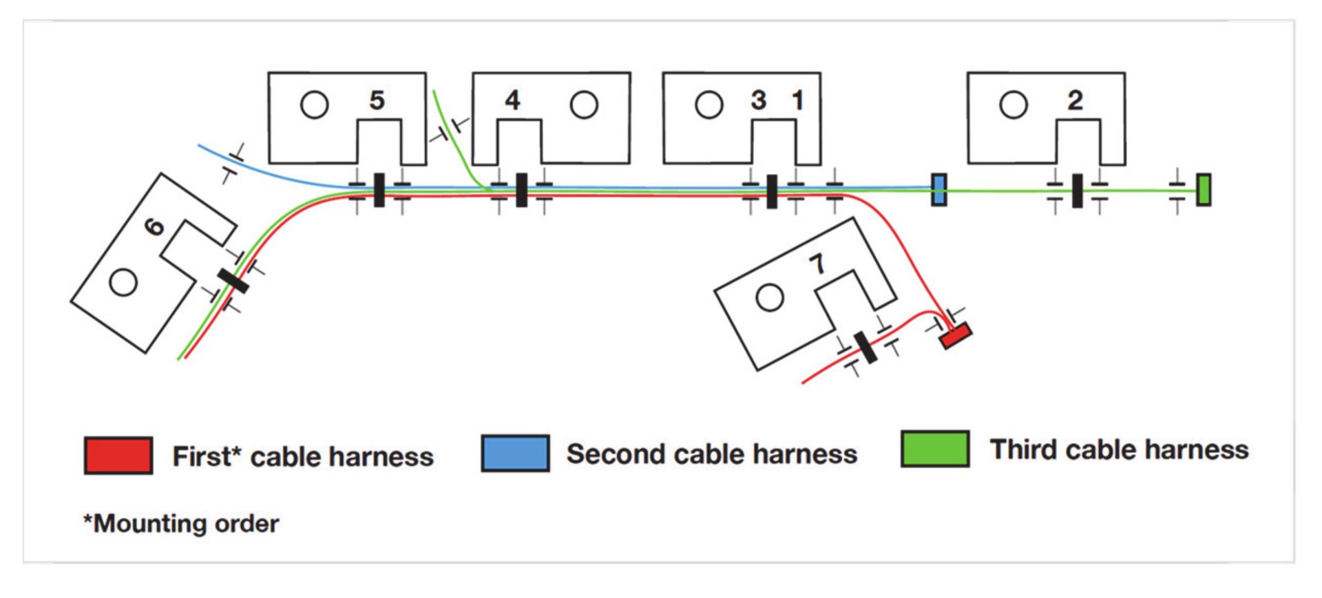

This drawing shows the layout of the assembly jigs, the position of the wires, and the taping spots. Source: Free University of Bozen-Bolzano

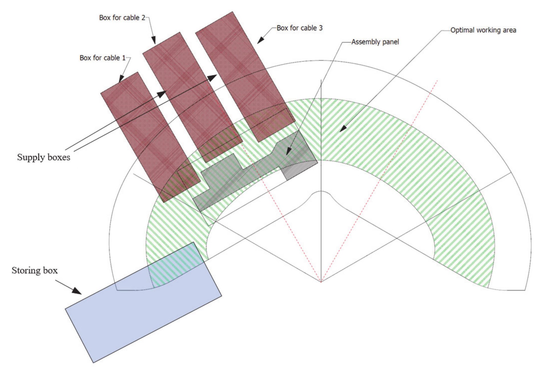

This drawing shows the layout of the new area the assembly station. Source: Free University of Bozen-Bolzano

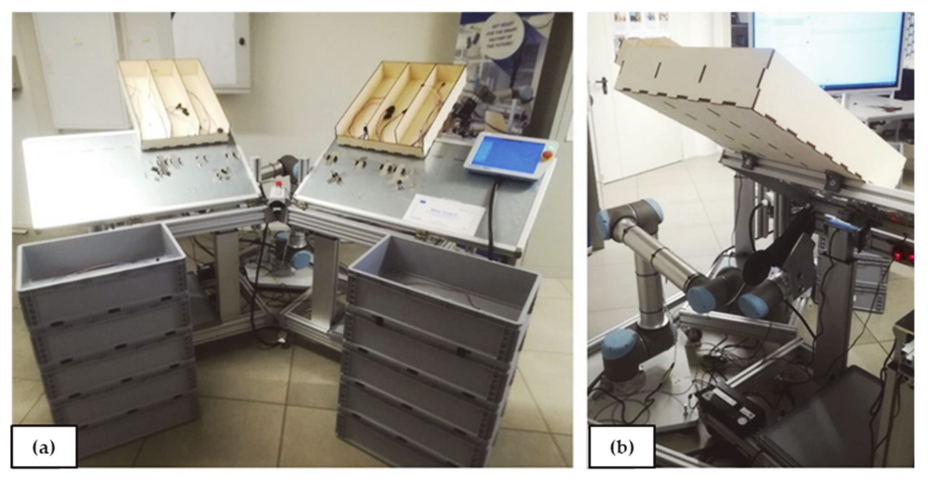

These photos show the front (a) and back (b) of our laboratory prototype for the new collaborative workstation. Photos courtesy Free University of Bozen-Bolzano
When technical feasibility is also factored in, the group 3 tasks—taping—emerge as the clear target for automation.
With that in mind, we redesigned the assembly line so that a person would load and unload the wire assemblies and a cobot would handle the taping. Our layout consists of one cobot, one assembler, and two workstations.

We designed the new workstations according to the guidelines in ISO 14738. Both the assembly areas and the subassembly bins are within easy reach of the operator, which optimizes working postures.

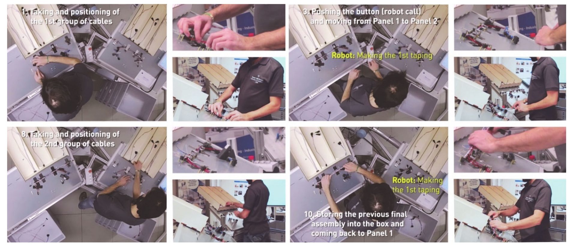

These images show workers interacting with the new layout. Photos courtesy Free University of Bozen-Bolzano
The assembly area is inclined at 30 degrees to the horizontal, to minimize twisting of the assembler’s wrist. The angle with respect to the vertical axis between the two assembly areas is 120 degrees. This allows the assembler to work on both fixtures with a minimal trunk twist and without colliding with the adjacent panel. Finally, the workstation height, as well as the fixture positions are adjustable to fit each assembler.
The cobot is located at the back side of the workstation, while the assembler is at the front. The assembly areas are located between them. The cobot is located on the floor and moves towards the fixture from below.
To reach the taping zones of both fixtures, the robot is located between them. This reduces the possibility of the cobot colliding with the assembler’s head. However, if the assembler is seated, the cobot could collide with his legs. To avoid that, the assembler can sit on a high stool, or he can work standing.
A jig secures wires prior to taping. Photo courtesy Elvez
