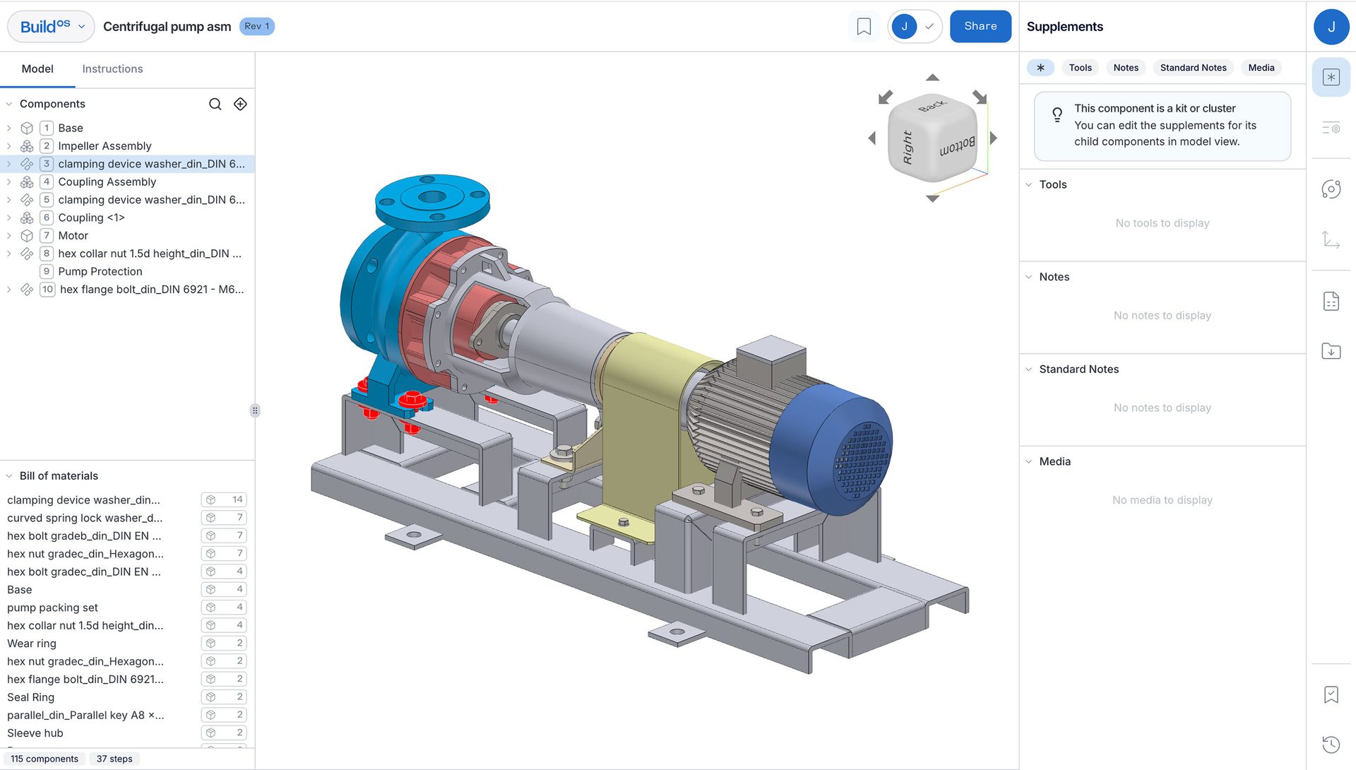

With BuildOS, engineers drop in a CAD file, and the software automatically generates path plans, sequences assembly steps, produces 3D renderings and animations, and generates text for each instruction. Photo courtesy Dirac Inc.

Dirac’s BuildOS platform was implemented at Ancra with an accelerated timeline, moving from initial engagement to full roll-out in just six weeks. With a hands-on approach, Dirac’s team conducted an on-site kickoff to ensure Ancra could realize immediate benefits from the new software. Within the first two weeks, Ancra began generating work instructions and quickly integrated BuildOS into its assembly stations, transforming workflows and reducing reliance on manual processes.
Ten weeks after launch, Dirac’s team returned to assess the impact of the software on the shop floor. The demonstrated results allowed Ancra’s management to triple their seat count, expanding usage across departments.
Ancra’s adoption of BuildOS has transformed its assembly processes, moving from text-based instructions to a model-based system that optimizes and reinforces precision and efficiency. The implementation has delivered immediate operational benefits.
With BuildOS, Ancra reduced the time required to create work instructions from several days to just a few hours, seeing nearly 95 percent efficiency gained in some cases. One engineer noted, “A work instruction that used to take three to four days to generate using traditional methods now takes me one to two hours.”

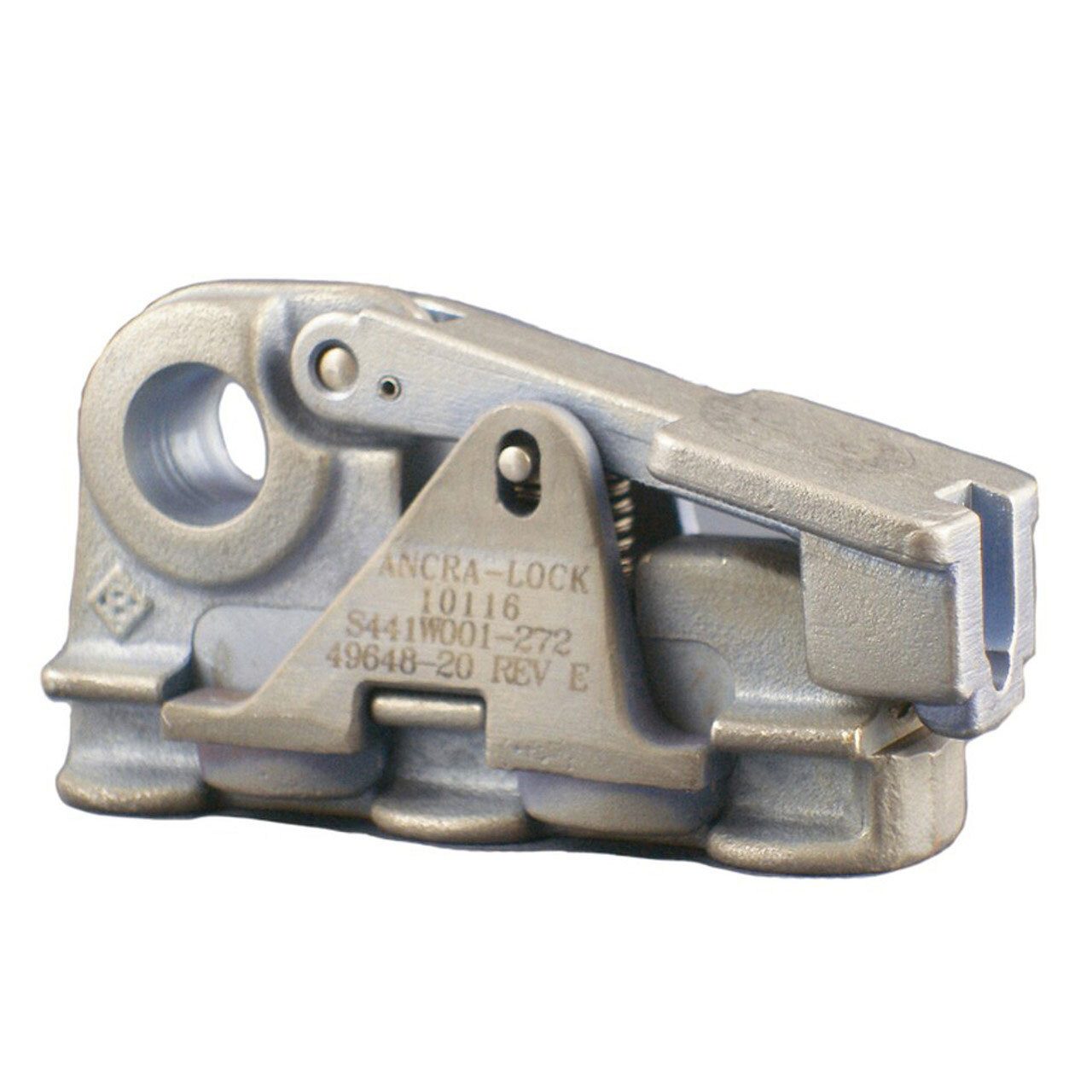

Ancra Aircraft’s products include anchor plates and tracks, galley hardware, panel stanchion fittings, nets and straps, and seat attachments. Photo courtesy Ancra Aircraft
