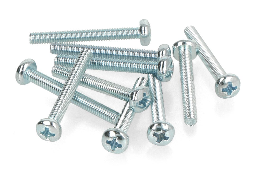

Zinc electroplating is the most common fastener finish. Photo courtesy Bossard

Not Understanding Zinc Electroplating
Zinc electroplating is the most common fastener finish. The bright silver-colored bolts and nuts are easily identifiable in any hardware store. Many engineers specify zinc-plated fasteners without understanding that there are different levels to the finish.
What is the life expectancy of the part? How much corrosion resistance is needed? Determining those factors will help meet the plating requirements that will give you a longer corrosion life.
It’s important to consider the environment where the part will be used. Will the fasteners be exposed to the elements? Outdoors, conventional zinc plating has low corrosion resistance.
It’s impossible to tell by looking at a fastener what level of corrosion protection it has. The amount of protection has to do with the thickness of the zinc, the thickness of the chromate coating on top of the zinc, and any kind of sealers that might have been applied. Manufacturers often do not to specify anything about the plating on the fastener, outside of indicating “commercial zinc.” That can lead to disappointment when the fastener fails quickly due to corrosion.
