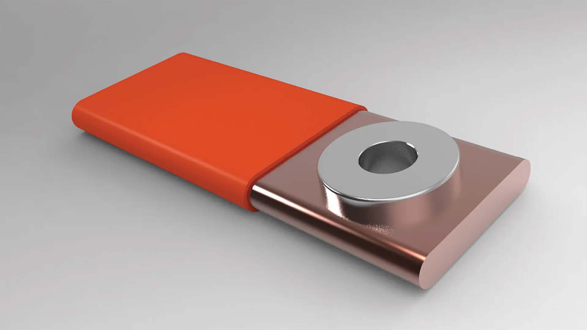

To address this challenge, PennEngineering has introduced the ECCB eConnect contact bushing.
To connect a bus bar to other components, the bushing is intended to work with other fasteners in the eConnect family of products—either a self-clinching nut or a self-clinching stud. Photo courtesy PennEngineering

PennEngineering developed the ECCB eConnect contact bushing specifically to address the conductivity issues associated with aluminum oxide. The bushing is designed to deliver ultra-low electrical resistance connections in aluminum bus bars, effectively overcoming the challenges of the oxide layer. Serrations under the head of the bushing break through the oxide layer with any need for surface preparation.
Designed for easy installation, the bushing creates a secure, durable joint that resists loosening or performance degradation over time. This reliability is essential for EVs, where high vibrations and temperature fluctuations can otherwise compromise weaker connections.
The bushing’s unique design disrupts the aluminum oxide layer, allowing for a direct, high-quality metal-to-metal connection. This ensures low electrical resistance.
