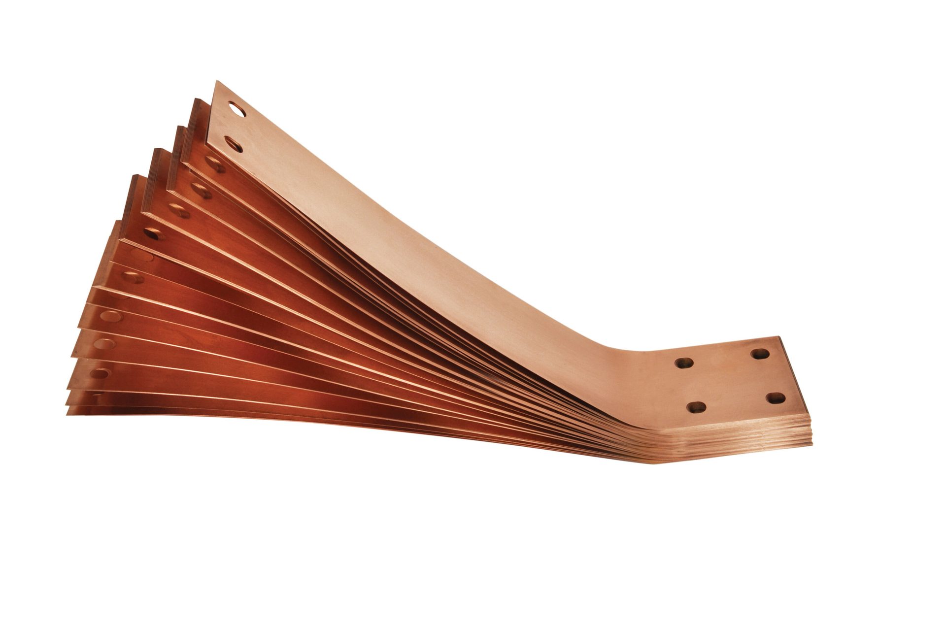

Unlike traditional welding, diffusion bonding does not melt the materials or require filler metals, making it ideal for complex applications that demand precision and structural integrity. For example, the flexible shunt for a spot-welding system consists of many thin layers of laminated copper. This assembly can get very hot while transmitting electric current. A shunt assembled with diffusion welding will typically operate 30 degrees cooler than shunts assembled with other methods. This means improved performance and electrical efficiency, as well as better safety for the operators.

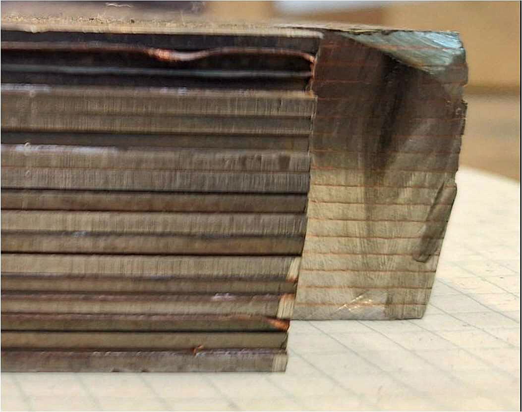

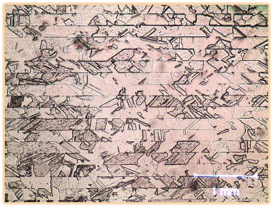

The photo (left) and micrograph (right) show multiple layers of stainless steel and copper welded into a single solid block of material. Photo courtesy TECNA USA Inc.

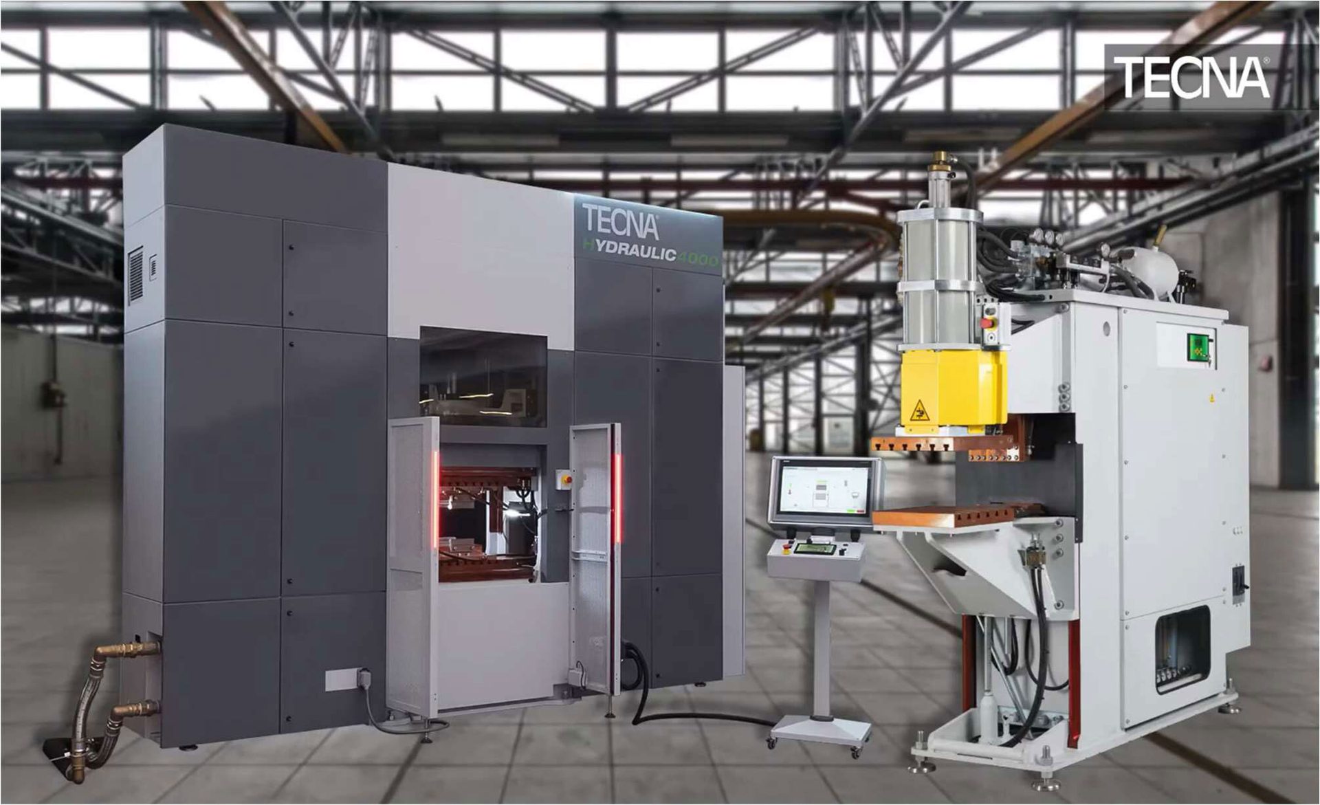

Modern resistance welding systems, such as C-frame press welders or larger portal frame models, have introduced a new level of efficiency and precision to the process.

A flexible shunt for a spot-welding system is an ideal application for diffusion welding. Photo courtesy TECNA USA Inc.

Advanced welding systems, like TECNA’s large-area portal frame welder, combine hydraulic circuits with servomotors to apply force precisely. These systems can deliver the necessary force—over 80,000 pounds for a 20- by 15-inch welding area—while maintaining rapid positioning and movement.

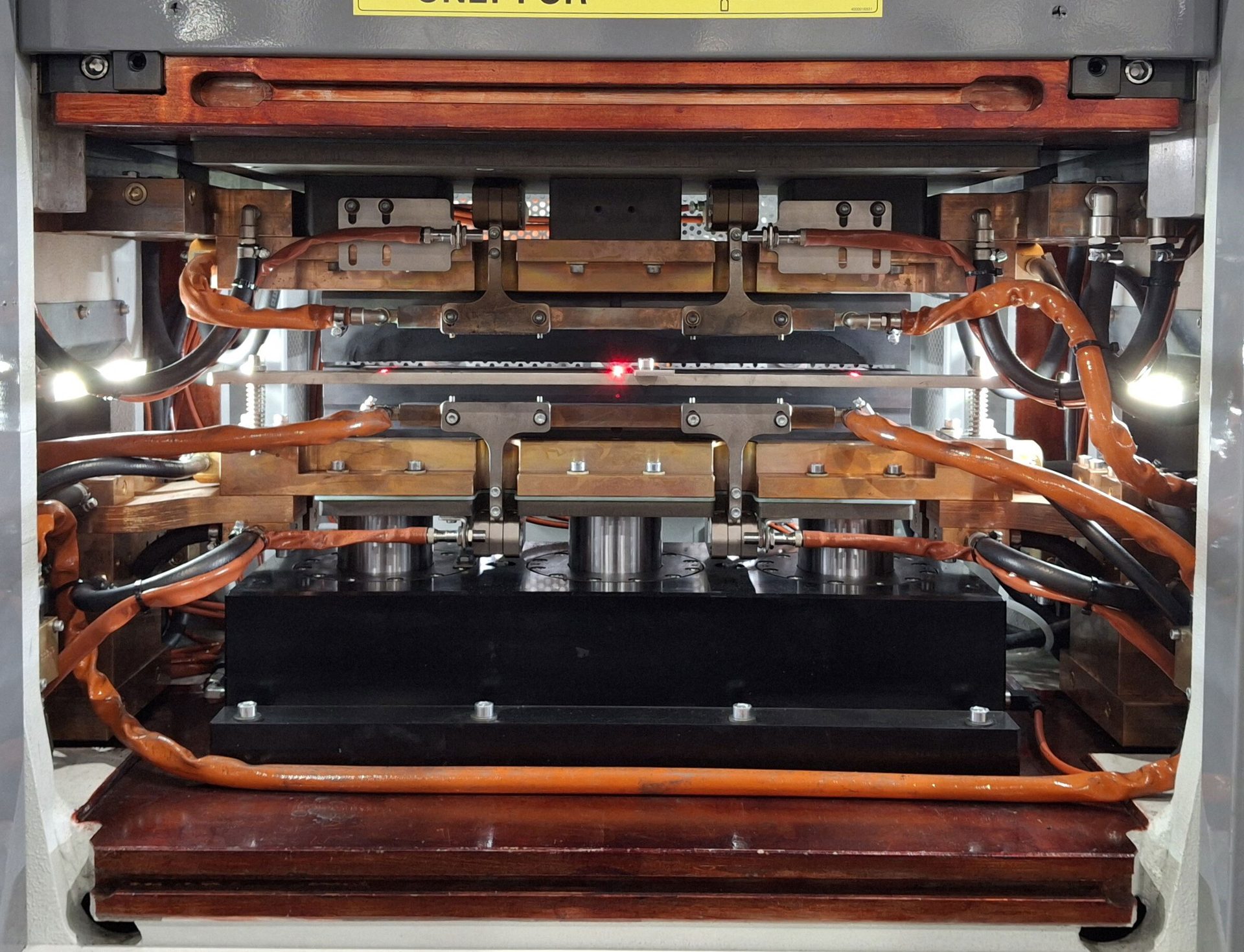

TECNA’s hydrostatic cushion system employs hydraulic compensation cushions to dynamically adjust for pressure imbalances caused by heat expansion during welding. Photo courtesy TECNA USA Inc.

However, innovations such as TECNA’s patented hydrostatic cushion system have overcome this barrier. This system, derived from press technology, employs hydraulic compensation cushions (hydrostatic planes) to dynamically adjust for pressure imbalances caused by heat expansion during welding.
This adaptive system ensures that the welding area remains flat within a tolerance of 0.02 millimeter, even over extended surfaces. The cushions balance local pressure variations, preventing deformations and ensuring consistent force and temperature distribution. This innovation enables large-area diffusion welding to be performed quickly and accurately, making it possible to weld laminated copper packs up to 20 inches wide in less than 30 seconds. This system is particularly valuable for manufacturing components like bus bars, shunts and heat exchangers.
