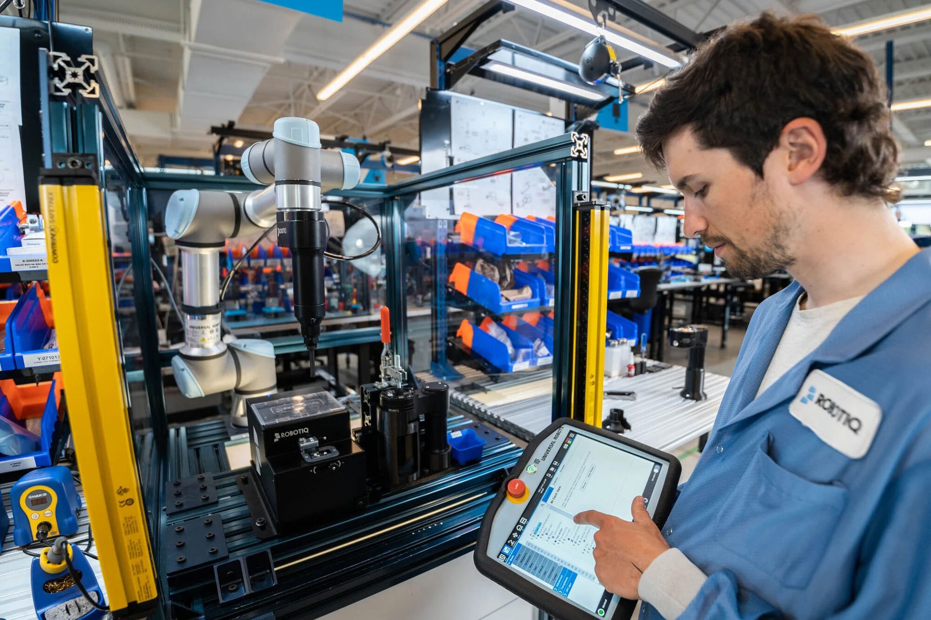

Engineers can program the screwdriver directly with the cobot’s teach pendant. Photo courtesy Robotiq

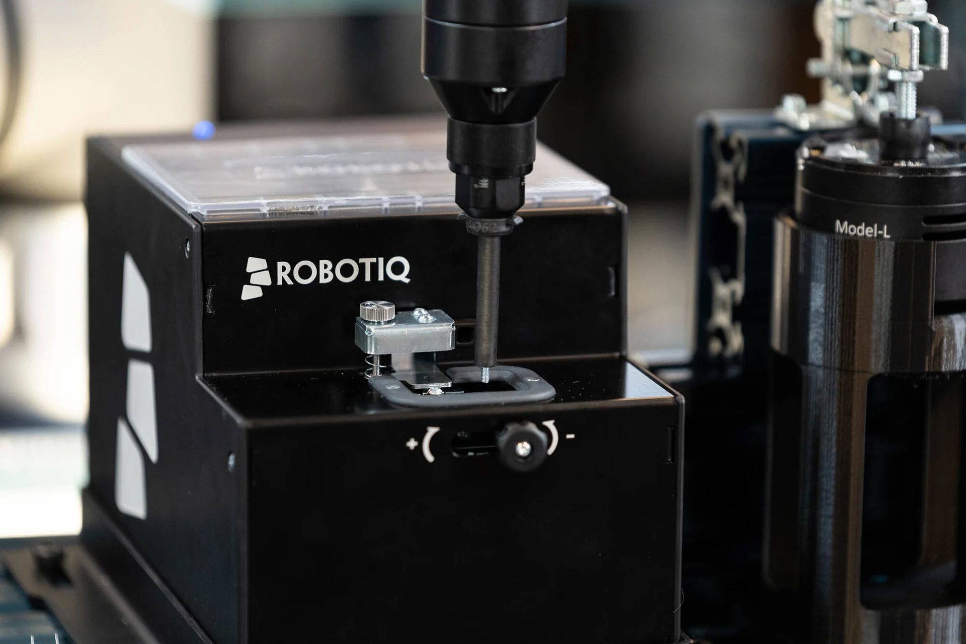

The cobot retrieves a fastener from a screw presenter. A vacuum bit ensure the screw stays put as the robot travels to a fastening location. Photo courtesy Robotiq

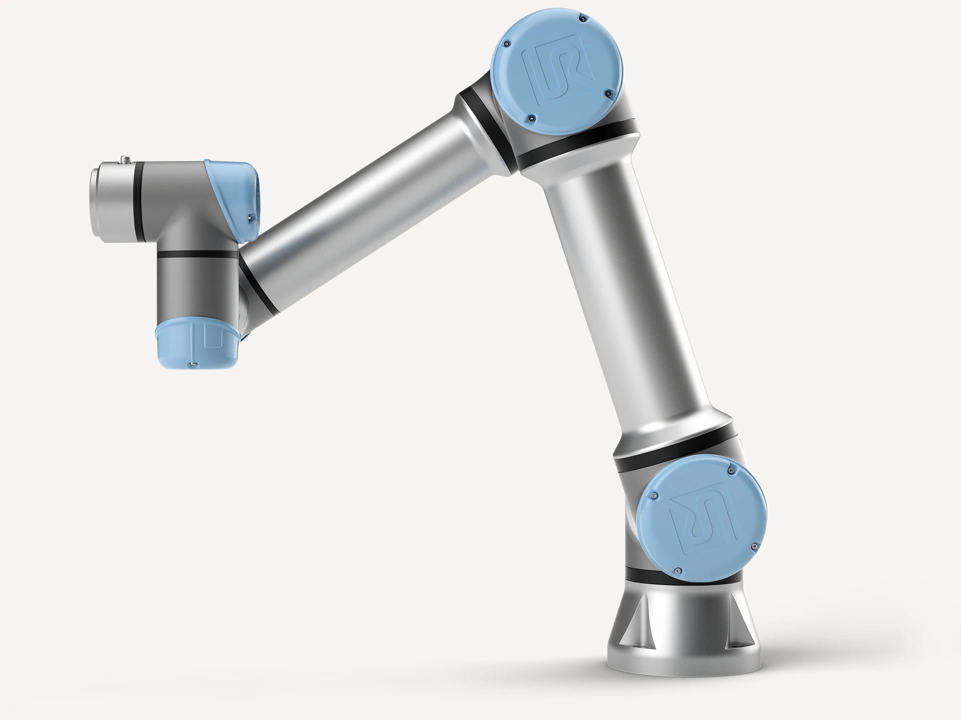

The UR5e is the second smallest model in Universal Robots’ portfolio of six-axis cobots. With a payload capacity of 5 kilograms and a maximum reach of 850 millimeters, the UR5e is ideal for low-weight collaborative processes, such as pick-and-place or screwdriving. The robot’s small footprint makes it easy to integrate into existing production setups.
Robotiq offers kits for a range of robotic applications including sanding, palletizing, machine tending and screwdriving. Robotiq’s Screwdriving Solution is a UR+ certified automatic screwdriving system for cobots. The system includes an SD-100 screwdriver, an SF-300 screw feeder, vacuum sleeves, driver bits, Force Copilot software, and screwdriving application software. Changeover from one application to another can be accomplished in 5 minutes. Engineers can program the screwdriver directly with the cobot’s teach pendant. The system provides precision fastening to torques of 1 to 4 newton-meters. It also has error-proofing features for uninterrupted screwdriving, such as screw presence detection, torque control and position monitoring.

With a payload capacity of 5 kilograms and a maximum reach of 850 millimeters, the UR5e is ideal for low-weight collaborative processes, such as pick-and-place or screwdriving. Photo courtesy Universal Robots
