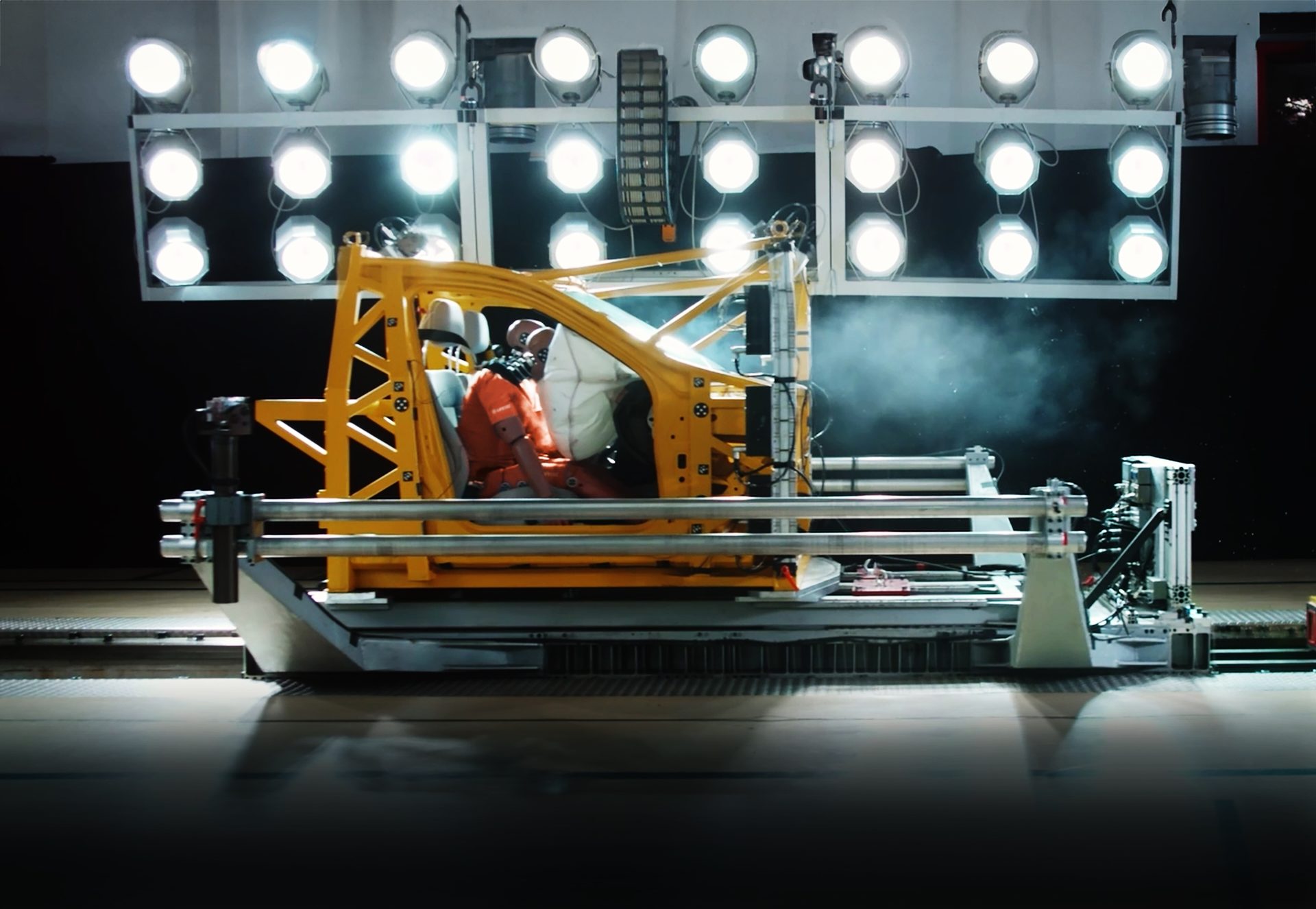

Crash tests have been standard practice in the automotive industry since the 1970s. Photo courtesy ZF Lifetec
Worldwide Dynamic Tests
Dynamic testing assesses how safety components, such as seat belts and air bags, behave both individually and as a complete system during crash simulations. ZF Lifetec has crash-test sleds in five markets (U.S., Japan, Italy, China and Germany). All tests are conducted in accordance with local and global automotive safety standards, such as Euro NCAP, China NCAP, U.S. NCAP, and the Federal Motor Vehicle Safety Standard.

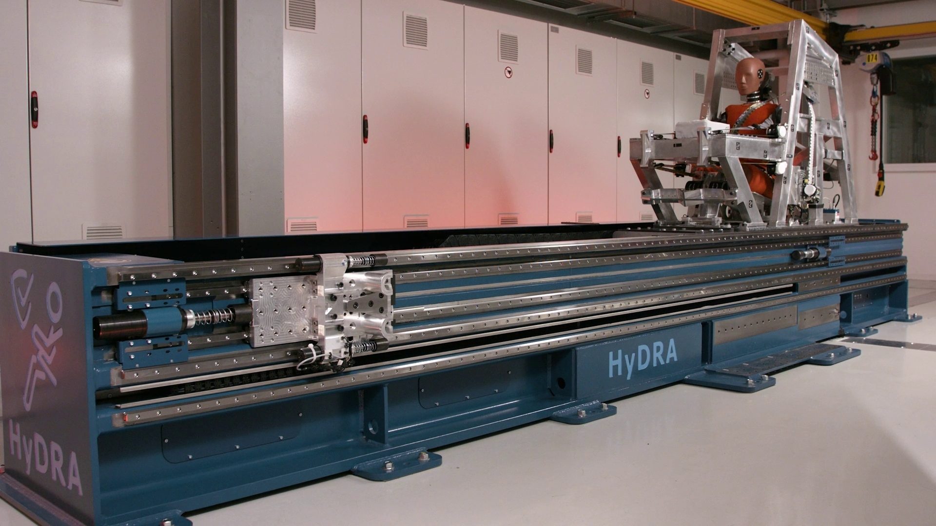

A basic requirement for virtual testing is the validation of the underlying assumptions. This is the only way to ensure that virtual tests match reality. To guarantee this, ZF Lifetec has developed the hyper dynamic response actuator (HyDRA). This test bench, which is unique in the industry, enables a quick and precise comparison with reality. It validates a digital twin that enables significantly shorter development cycles and serves as an enabler for “real-life safety.”
The HyDRA is an electric mini-sled for highly dynamic tests on seat belt systems with velocities up to 144 kilometers per hour and accelerations or decelerations up to 70 g. HyDRA is equipped with precise measurement technologies. For instance, inductive displacement sensors can capture every shift at specific measurement points during the crash sequence up to a thousandth of a millimeter. Integrated load cells precisely record the dynamic load on the seatbelt during the crash phases.
All these sensors generate data to create a digital twin of the simulator that runs in parallel with the physical test from the very beginning. With a digital twin, physical tests (expensive and slow) can be replaced by a multitude of virtual tests or simulations (efficient and fast).
“Usually, during seatbelt development, complex system tests are performed for each model of a vehicle manufacturer,” explains Machens. “With HyDRA, we could generate many of these test results with high accuracy through virtual testing. This enables us to speed up our response time to customer inquiries.”

The HyDRA is an electric mini-sled for highly dynamic tests on seat belt systems with velocities up to 144 kilometers per hour and accelerations or decelerations up to 70 g. Photo courtesy ZF Lifetec

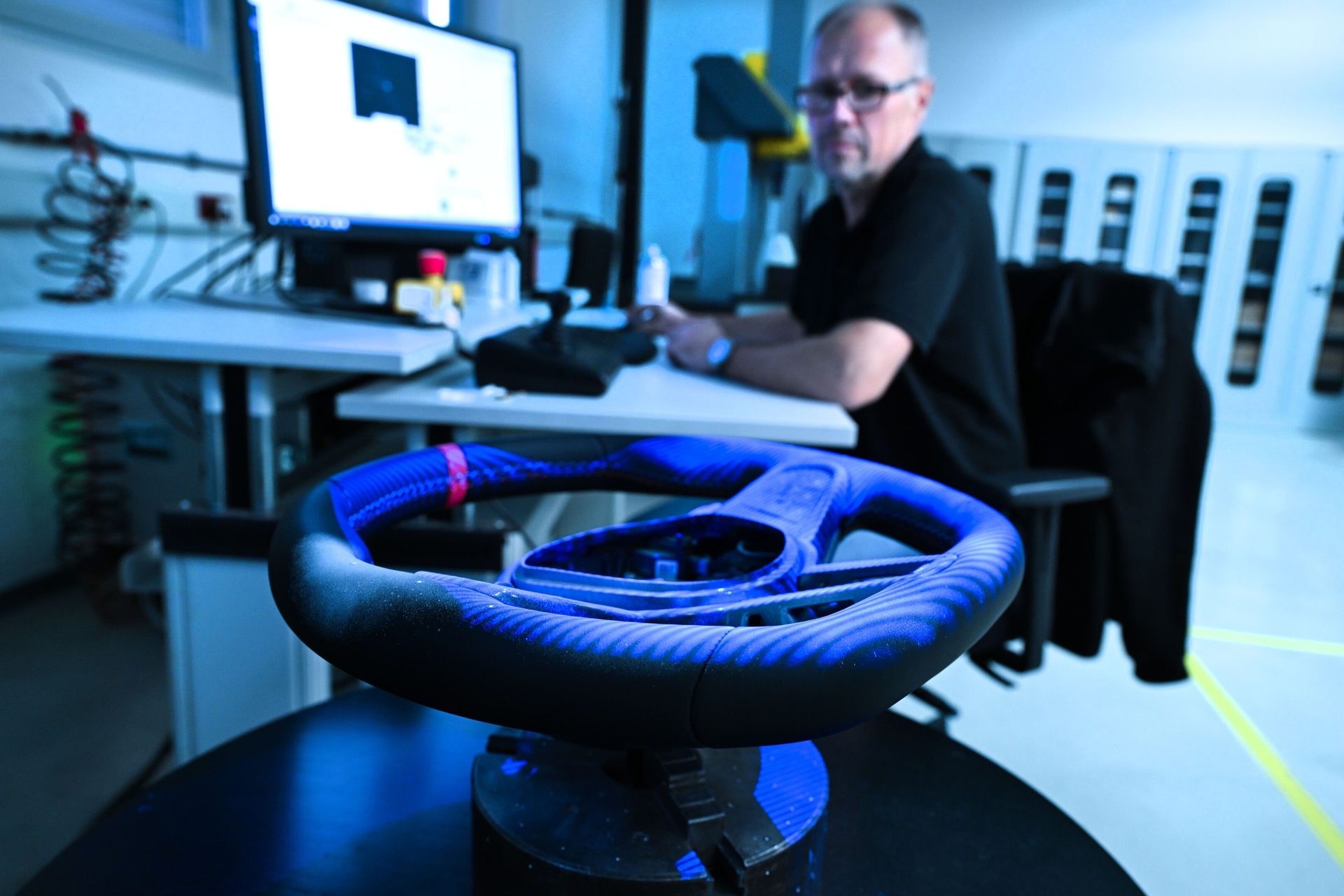

All systems must also be tested for electromagnetic compatibility. In the case of steering wheels, for example, this is important for ensuring that new functions, such as hands-on detection, are fail-safe.
