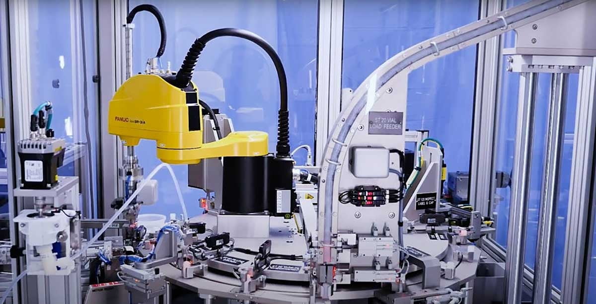

Last year, Dynamic Automation and Robotics, a systems integrator in Simi Valley, CA, designed and built a system to automatically fill vials with a medication for treating COVID-19.
Starting with bulk parts, the system automates everything from beginning to end, including assembly, filling, labeling and inspection. Operator interaction is required only for parts replenishment, allowing one operator to run several machines simultaneously or to perform other tasks in parallel. The machine can fill 50 vials per minute and run uninterrupted for more than an hour. Each machine can produce more than 20 million vials per year.
To maximize speed, the machine controls every aspect of part orientation. The process begins with the empty vials. Once the vials have been loaded into nests on an electromechanical rotary indexer, they are weighed using the first of two high-precision Mettler-Toledo scales. From there, they are filled using servo-controlled pumps that can be adjusted and programmed from the HMI. The vials are then weighed again to verify that the correct amount of medication has been dispensed. A Fanuc SR-Series SCARA robot loosely caps each vial, and a SMAC moving-coil actuator tightens each cap to a preset torque.

This machine can fill 50 vials per minute and run uninterrupted for more than an hour. Photo courtesy Dynamic Automation and Robotics
