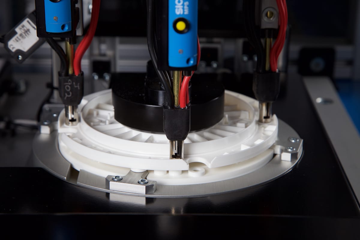

The PulseStaking process does not produce vibration, burning smells, particulates or burn marks. Photo courtesy Branson at Emerson

Staking is a more cost-effective alternative to clamping. In staking, a part with one or more holes in it is slipped over corresponding posts on a base part. A tool mounted on a press is then used to form a head on each post, trapping the top part securely against the base part. The base part must be made of a formable thermoplastic, but the entrapped part can be made of any material: sheet metal, FR4, glass, rubber, thermoset plastic or another thermoplastic.
There are several ways to head posts for staking. Emerson has developed a new, cost-effective approach for the process: Branson PulseStaking technology, a variant of traditional “hot-tip” thermal staking processes. PulseStaking employs a patented tip that precisely manages the temperature to melt the plastic and form a head. The temperature is controlled with pulses of heating and cooling. As a result, this process can stake or swage complex, closely spaced studs singly or in multiples, depending on tooling, without the risk of melting nearby structures. Thus, PulseStaking can handle a range of densely featured assemblies that ordinary hot-tip processes cannot.
The PulseStaking process does not produce vibration, burning smells, particulates or burn marks. The process can be used on delicate and sensitive parts, and it produces consistent, strong, aesthetic joints.
