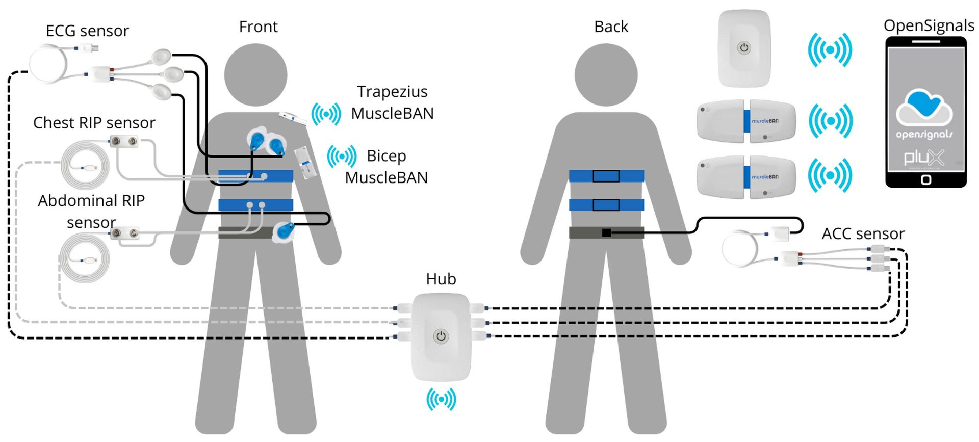

This diagram shows where wireless sensors were placed on workers to collect cardiorespiratory data. Source: Volkswagen

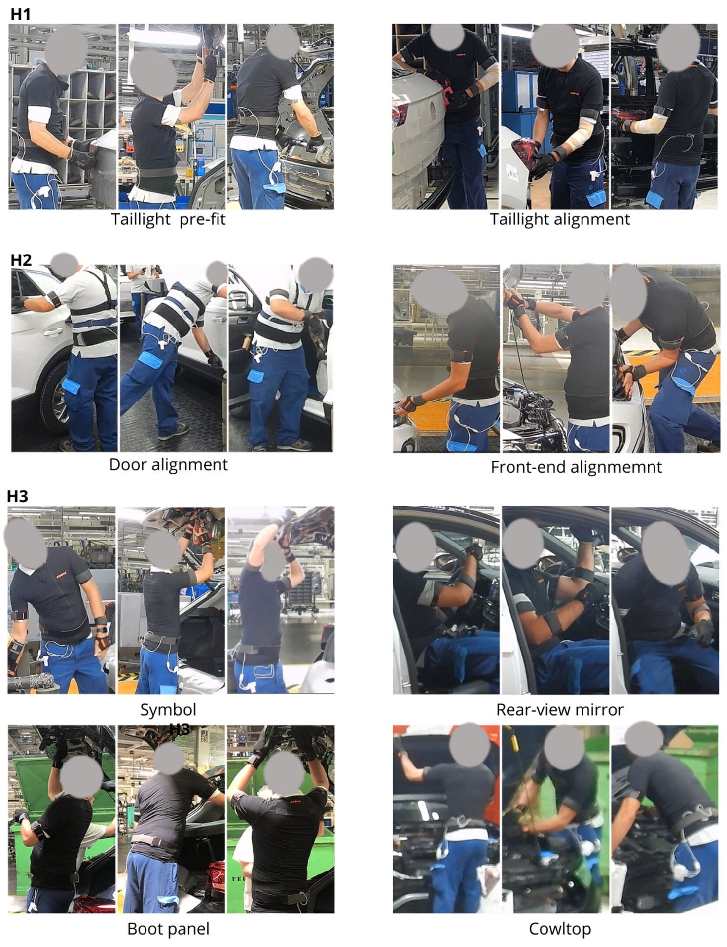

These images show the sequence of movements performed for each task and the specified workstation. Source: Volkswagen

Our research focused on three workstations that rely on manual processes:
• H1—tailgate and taillight alignments and attachment of the taillights, involving arm movements in front of or along the upper body.
• H2—alignment of the side doors, rear end and front end, involving upper body bending and applying body weight onto the car.
• H3—mounting of the rearview mirror, cowl, boot panel and trunk symbol, which entails multiple overhead movements.

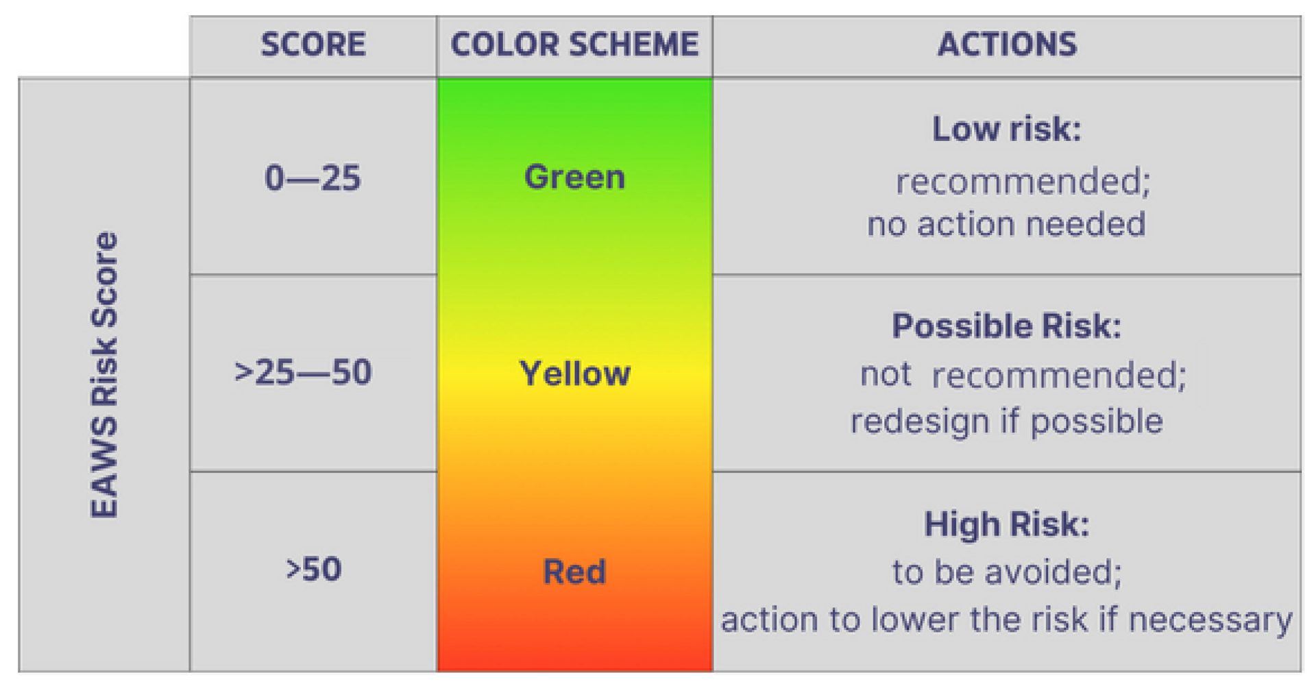

Each task was given an ergonomic risk score by an ergonomist. We used the European Assembly Worksheet. It includes whole-body and upper-limb assessment of risk factors. To analyze the cardiorespiratory response associated with the ergonomic score, tasks were considered to be low risk with a score equal to or less than 25 (green), moderate risk with a score between 25 and 48 (yellow), and moderate-high risk with a score of 48 or higher (orange).
Wireless sensors were used to collect ECG; respiratory inductance plethysmography (RIP), and accelerometer (ACC) data from workers during their shifts. The ECG is a noninvasive way to measure the electrical activity of the heart. Cardiovascular load indicators were extracted from these signals, based on reserve heart rate, cardiovascular strain (CVS), and cardiovascular load (CVL). RIP is a noninvasive method of monitoring lung function. The accelerometers provided a measure of effort and workload.
