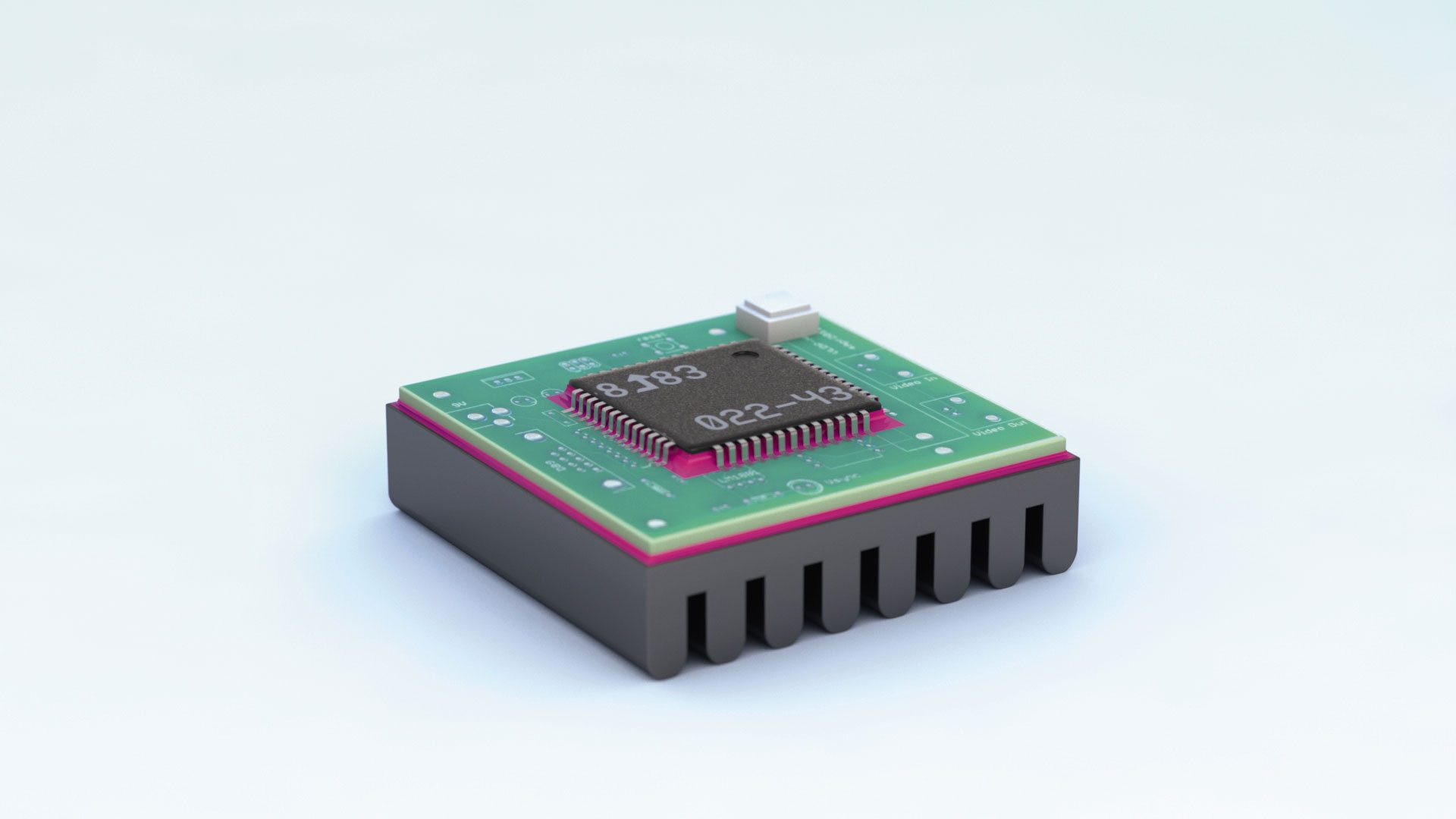

Thermal interface materials improve heat transfer between two surfaces, typically a heat source, such as a computer processor, and a heat sink or other cooling system. They fill the small gaps and imperfections between surfaces, reducing thermal resistance and increasing heat transfer efficiency.
In addition to cooling components that generate heat, thermally conductive adhesives help reduce weight by eliminating the need for space-restrictive mechanical fasteners such as screws or clips. They are available in many types of resins, including epoxies, polyurethanes and silicones. And, the adhesives come in various forms, including films, liquid metals, pads and pastes.

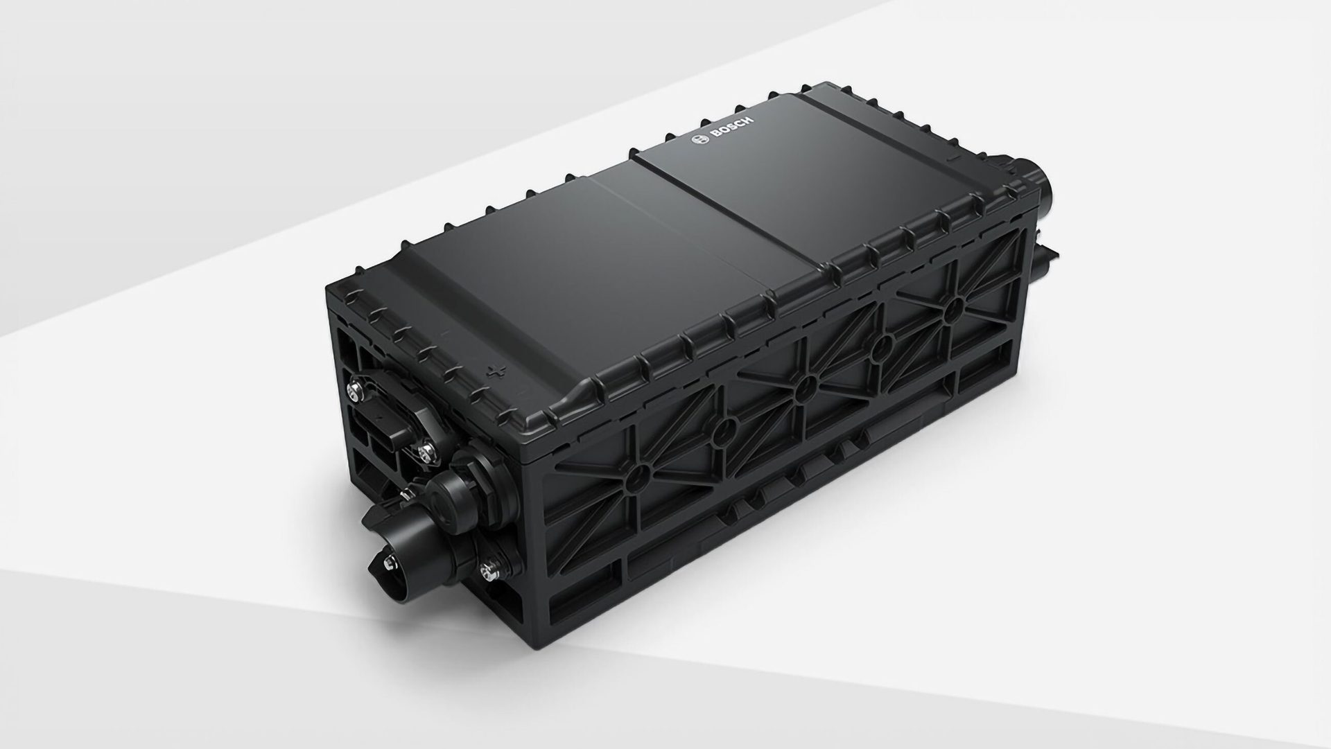

Engineers at Robert Bosch GmbH recently decided to use thermally conductive adhesives when developing a 48-volt lithium-ion battery for mild hybrid applications. The compact battery is only 5.5 inches tall, which enables maximum flexibility during installation in vehicles. It can be placed in discreet places such as under the front passenger seat.
The key to the compact design lies in its thermal efficiency. DELO Duopox TC8686 thermally conductive adhesive not only bonds the battery cells within the housing, but also efficiently dissipates operational heat.
“This adhesive combines structural bonding and thermal conductivity in one step, eliminating the need for mechanical fixation and separate gap fillers,” explains Bauer. “By removing an entire step, thermally conductive adhesives streamline the manufacturing process.”

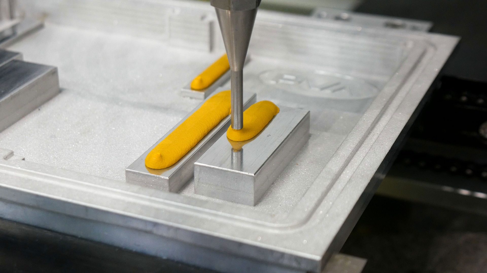

Thermally conductive materials contain fillers that are typically metals of some sort. Higher thermal conductivity leads to a higher percentage of fillers, which are abrasive. That can wreak havoc on a dispensing system if it’s not set up properly using the right type of components.
As with thick and thin materials, the need to automatically dispense filled materials depends on production volume and the need for accuracy.

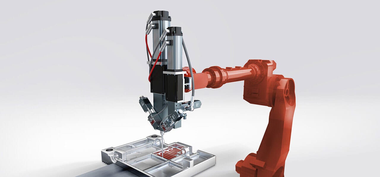

A fully automated setup incorporates a robot, automation equipment or conveyor to move each part to the nozzle for dispensing and then past it for further production work. Automated systems also include wired or wireless connections between the dispensing motor and pump, HMI and PLC.

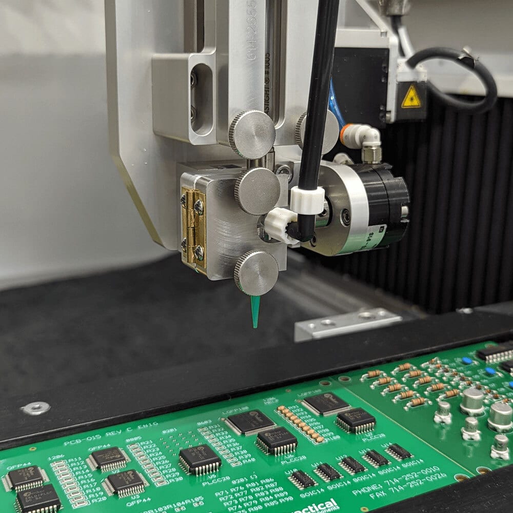

“Different types of dispensing equipment are required for thermally conductive materials,” says PVA’s Urquhart. “For instance, everything has to be abrasion-resistant. A lot of systems use carbide steel or ceramic-coated components to hold up to abrasive materials. Fittings such as needles, nozzles and valves have to enable optimum flow paths and withstand high wear.
“Today, we’re seeing more demand for materials such as thermal grease and liquid metal,” Urquhart points out. “They flow well and enable thin bond lines. We also see conductive encapsulants used for potting applications associated with control modules, power electronics and other enclosed devices.”

“Due to the high viscosity of the fluids involved, the best approach is process control and mechanical components designed for silicones and abrasive fillers such as alumina, silver and zinc oxide,” claims Gorman. “A mixing tank can be used to maintain fluid uniformity, directly feeding the dispenser.
“Filled materials are abrasive, due to the conductive particles suspended in fluid,” says Gorman. “Challenges with getting material break-off from the nozzle require the capability to move the material from a container, and through fluid system components and a dispense valve and nozzle. The dispense mechanism can be a jetting or needle dispensing method, with linear piston pump or progressive cavity valves.”
Jetting material involves a piston contacting a surface opposite an orifice (nozzle). This mechanical interaction causes the piston and the contact surface to abrade more quickly. As such, the dispenser must be capable of generating high forces for closing the piston to achieve break-off of the fluid from the dispense nozzle.

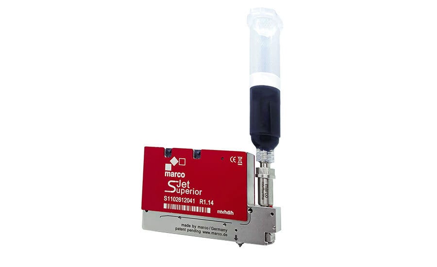

Marco offers a dispensing product called SuperiorJet. It can be configured across a wide variety of materials, including thermally conductive adhesives. Using a piezo-based dispenser offers the ability to apply higher forces vs. pneumatically actuated valve products, leading to better break-off.
“Additionally, our modular valve seat (nozzle) offers the ability to replace the seat piston—the source of highest wear—instead of needing to replace the entire seat, leading to lower cost of ownership,” says Gorman. “[Our] follower plate system allows high viscosity thermal materials to be moved mechanically rather than relying on compressed air to move.
“Reducing the air-gas content dissolved in materials leads to more predictable material compressibility, which leads to lower variance in dispensed volumes,” explains Gorman. “The S Jet Superior modular dispensing valve is versatile. The connection of the valve drive and the dosing needle via a ring spring limits the media contact to the dosing unit. This can be replaced quickly and at will.
This modular valve is ideal for dispensing abrasive media with short processing times. Photo courtesy Marco System Analysis & Development LLC
“The modular valve is ideal for dispensing abrasive media with short processing times,” claims Gorman. “Frequencies of up to 1,000 hertz with a service life of more than 1 billion cycles are possible without maintenance, thanks to the piezo drive. The exchangeable dosing units print dots or lines between 50 and 3,000 microns wide. In addition, heat-conducting plates can be attached to ensure temperature control of the media.”

“Our proven system for applying thermally conductive materials comprises the A280 material feed system, a DosP DP803 TCA dispenser and the DC803 DispensingCell,” says Blaser. “The material feed and dispenser are specially designed for processing highly abrasive materials.
“The extremely viscous thermally conductive material is fed from the material drum via material feed lines to the dispenser,” adds Blaser. “This then applies the material on the component in the form required. Precise material application in three dimensions is ensured by installing the dispenser on the CNC axis system of the dispensing cell.”
A special TCA (Thermally Conductive Adhesive) version of the DosP DP803 016 is available for thermal management applications. “This model has been optimized for the fast and precise application of thermally conductive materials with a viscosity of more than 150,000 millipascal seconds (mPa-s),” claims Blaser.
“Thanks to design adaptations and the integration of new, particularly robust high-performance components, this version offers significantly improved wear resistance and an optimized material flow,” Blaser points out.
“The DosP DP803 also offers the well-known advantages of the proven volumetric Dos P piston dispensers from Scheugenpflug,” says Blaser. “Exactly dimensioned dispensing cylinders enable the application of precise, reproducible material volumes or, in the case of 2K media, a constant mixing ratio at all times.”
