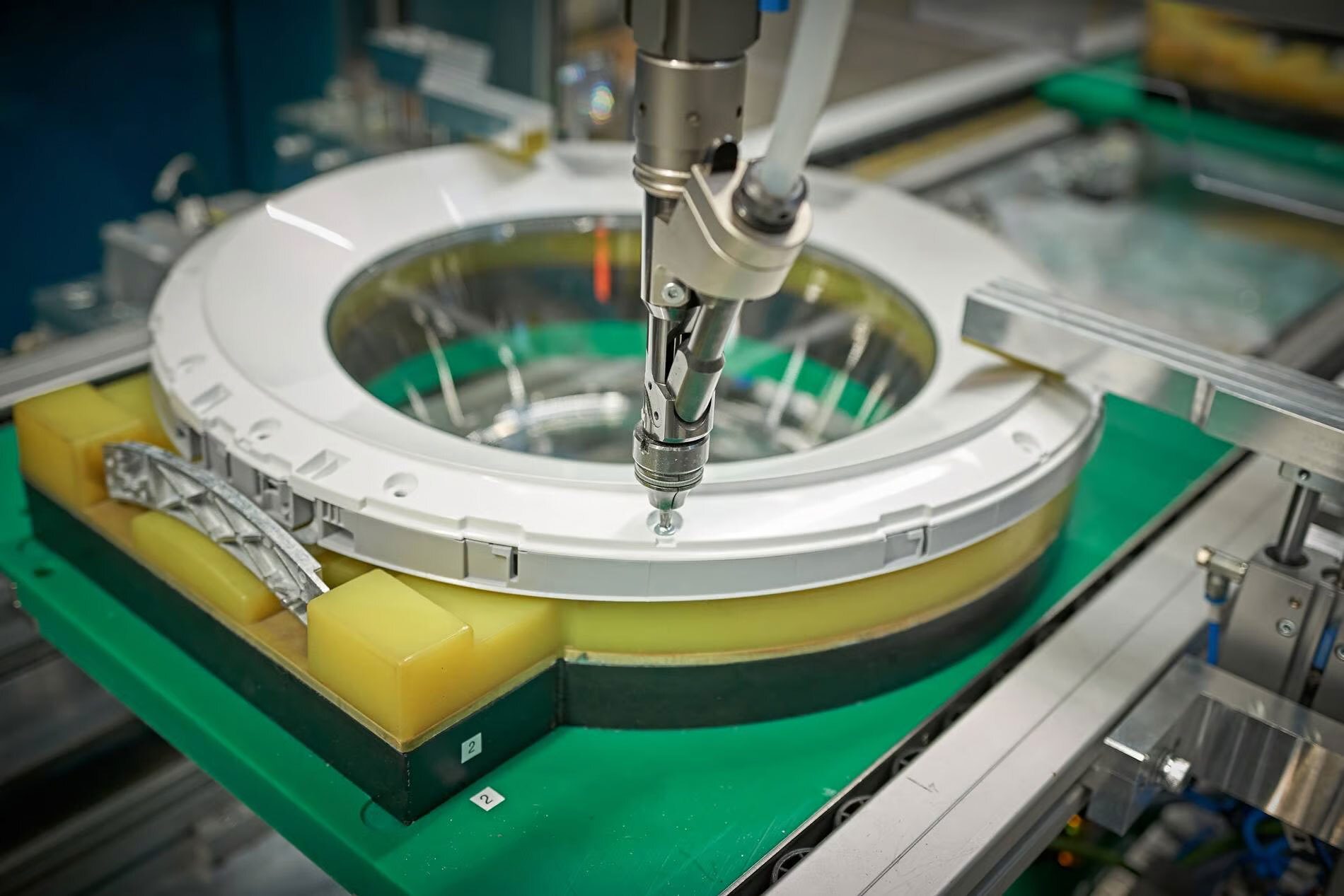

With robotics, assemblers can ensure that a fastener isn’t missed or installed in the wrong area. Photo courtesy Kuka

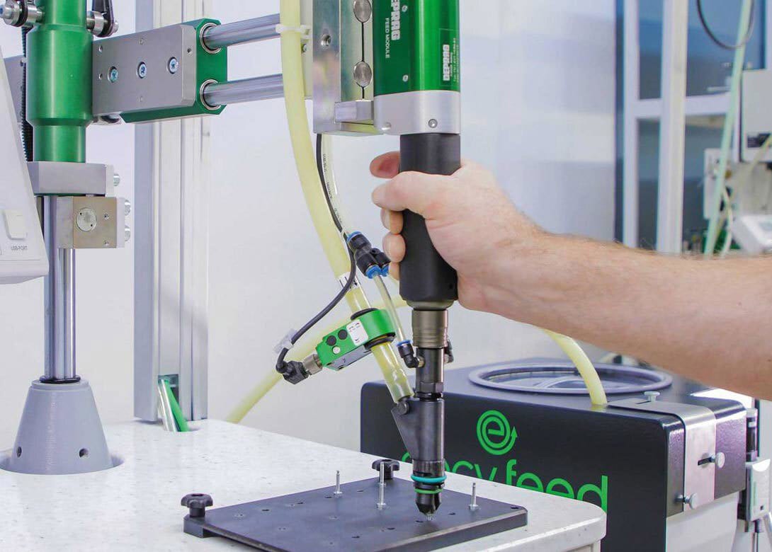

As for drive style, suppliers of automatic screwdriving equipment recommend fasteners with self-centering drives, such as Torx, Phillips and hex screws. Cam out—the tendency of the bit to slip from the fastener head during rundown—is less of a problem with these types of fasteners. Slotted screws are difficult to use with automated equipment because the bit picks up the fastener only once every 180 degrees. In addition, Torx and other internal drive styles require less downward force from the operator.

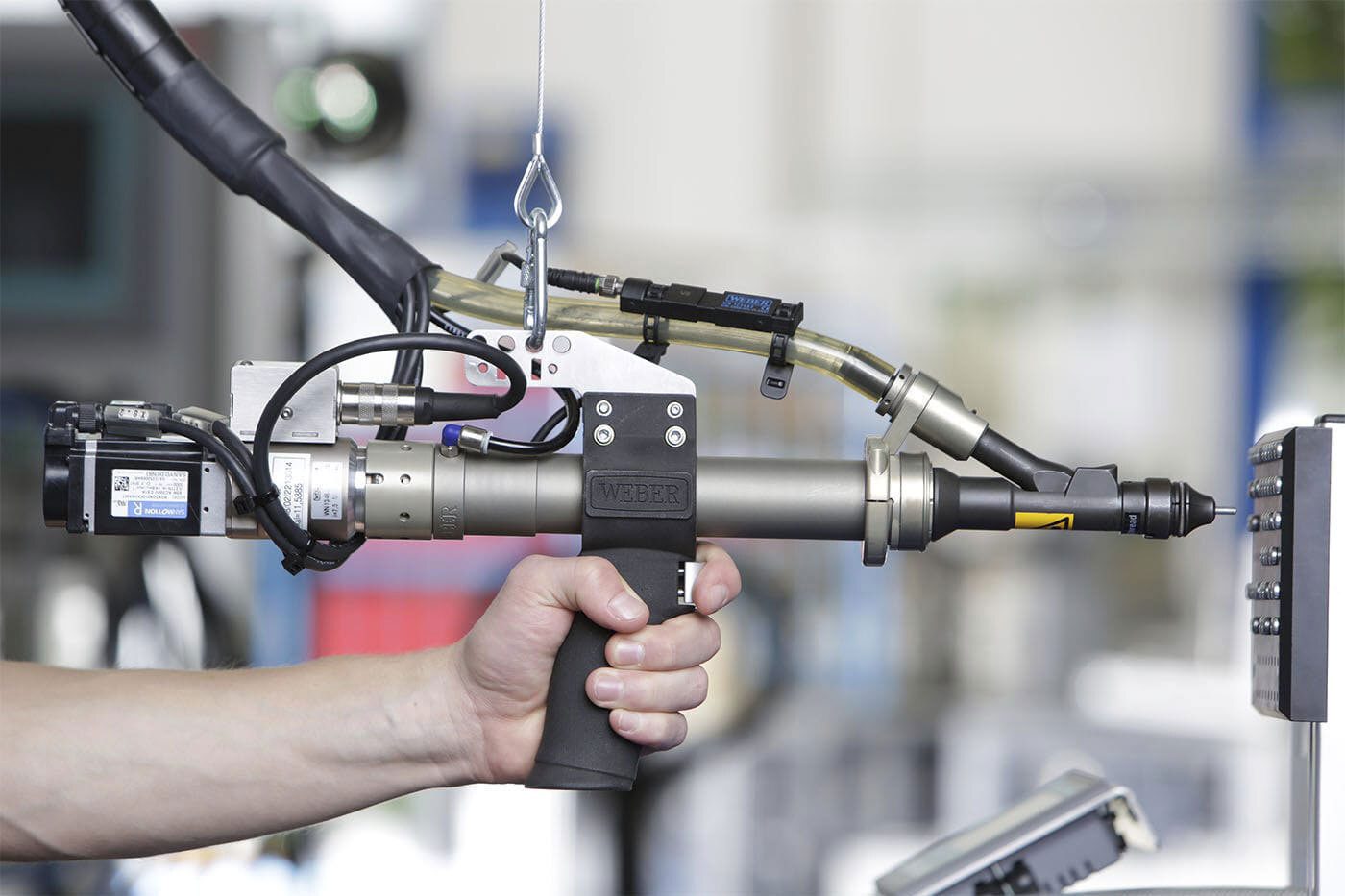

Small fasteners require special equipment to feed them, hold them in place on the bit, and limit the amount of torque applied. Photo courtesy Deprag

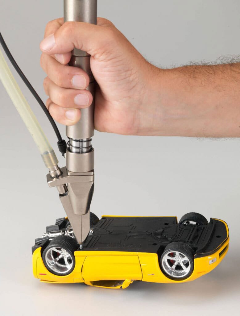

The simple action of picking a screw out of a bin, sticking it at the end of a bit, and driving it into the part is not that simple with small fasteners. As a result, automation engineers recommend automatic screwfeeders. Vibratory bowls are the most popular choice for feeding small screws. With a #10 pan-head screw, a vibratory bowl can feed as many as 80 screws per minute. That’s important, because an experienced operator can install 60 screws per minute.
The escapement for the screws can be shorter with feeder bowls than with other types of feeders. This decreases the overall footprint of the automated fastening system.
But, using vibratory bowls to feed small screws is not without problems. For example, the weight of the fastener is very low in relation to the intensity of the vibration. Screws are literally jumping all over the place and often won’t make it to the top spiral and the separator. To solve this problem, it’s best to use a feeder bowl with small diameter.

Suppliers of automatic screwdriving equipment recommend fasteners with self-centering drives, such as Torx, Phillips and hex screws. Photo courtesy Weber Screwdriving

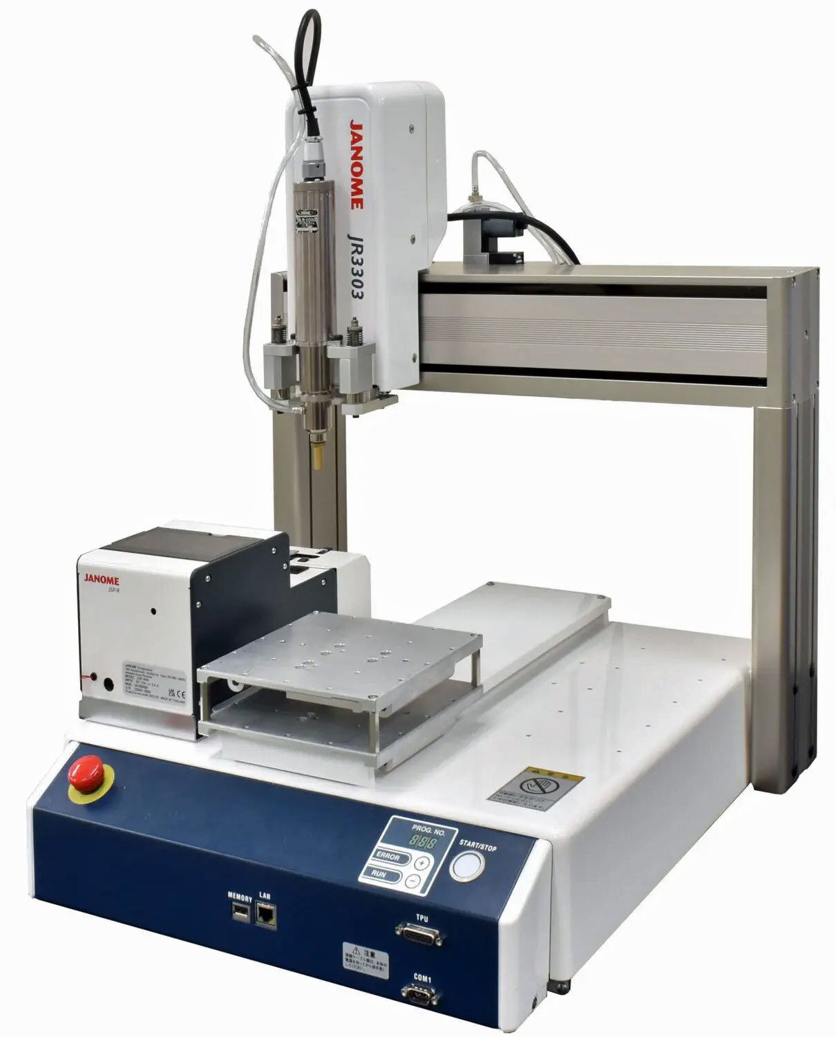

For automated fastening, many manufacturers prefer semiautomatic robotic workcells over in-line, fixed automation. Photo courtesy Janome

In blow feeding, the screws are blown through a flexible tube to the drive head. For optimal feeding, the length of the screw should be at least 1.5 times the width of the head. Shorter screws tend to tumble in the feed tube, causing jams. Pointed screws usually can’t be blow-fed, because the points can stick in the soft material of the tube.

Torque control is another issue. It’s not difficult to strip or even break a small-diameter threaded fastener with a hand tool, much less with a pneumatic or electric tool. Suppliers have answered this need with screwdrivers that can drive fasteners with torque as low as 2 newton-centimeters.
In-line torque monitoring for small screws is tricky. The torque that is being verified might be smaller than the tolerance of the available test equipment. At the same time, if the test equipment is too sensitive, it can easily be damaged during use, or its readings can be thrown off by environmental conditions.

Deciding to automate the process of driving small-diameter threaded fasteners is more than just an issue of meeting production rates. With manual fastening, changes in downward pressure or the orientation of the driver can affect the quality of the joint. A robot automatically determines how fast the screwdriver needs to descend to stay in contact with the screw during tightening.

For automated fastening, many manufacturers prefer semiautomatic robotic workcells over in-line, fixed automation. If a hard-tooled line goes down, production stops. But, if assembly is being done by six robots, even if one robot goes down, the company still has five others working. Robots can also be retooled more easily than fixed automation. With robotics, assemblers can ensure that a fastener isn’t missed or installed in the wrong area.
