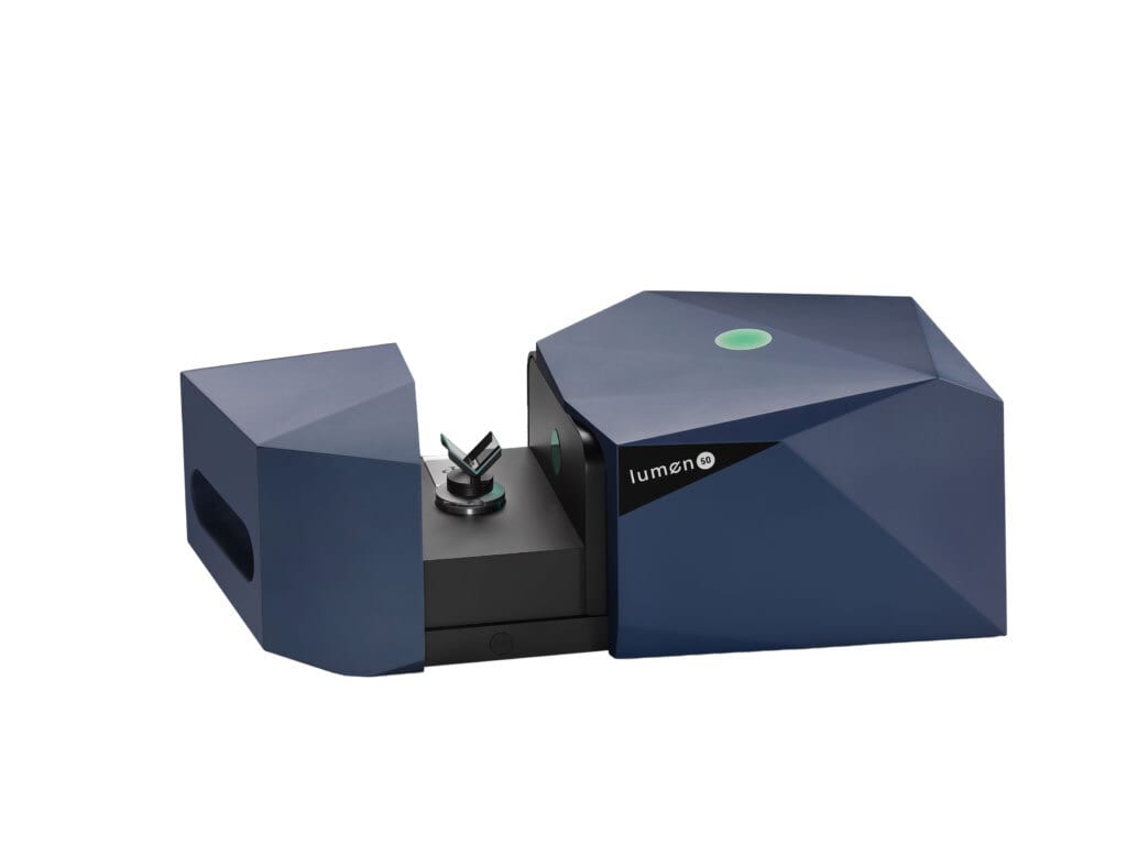

The system implemented by Petitpierre combines two of the company’s products, Drop and Lumen, and empowers them with machine vision. Drop is a device that automatically cleans and dries precision parts. Lumen is a telecentric optical device for the intelligent, automatic and accurate measurement of precision micromechanical parts. Compact, lightweight and easy to operate, it was developed specifically for use in production environments.
The combined system cleans and measures micromechanical parts one by one. The operator first places the components into a container in the Drop machine and starts the cleaning processes. The system then cleans both the first part and a vacuum gripper. Once the part is clean and dry, it’s transferred to the Lumen system. Cleaning and drying cycles are configurable: solvent volume, cleaning time, drying time, and the number of cycles can be adjusted by the operator.
Once the part has been transferred to Lumen, the vision system detects it automatically and starts the measuring process. The measuring is performed with just one “start” click by the operator who does not need to make any manual adjustments. The measurement is then repeated with the other components.

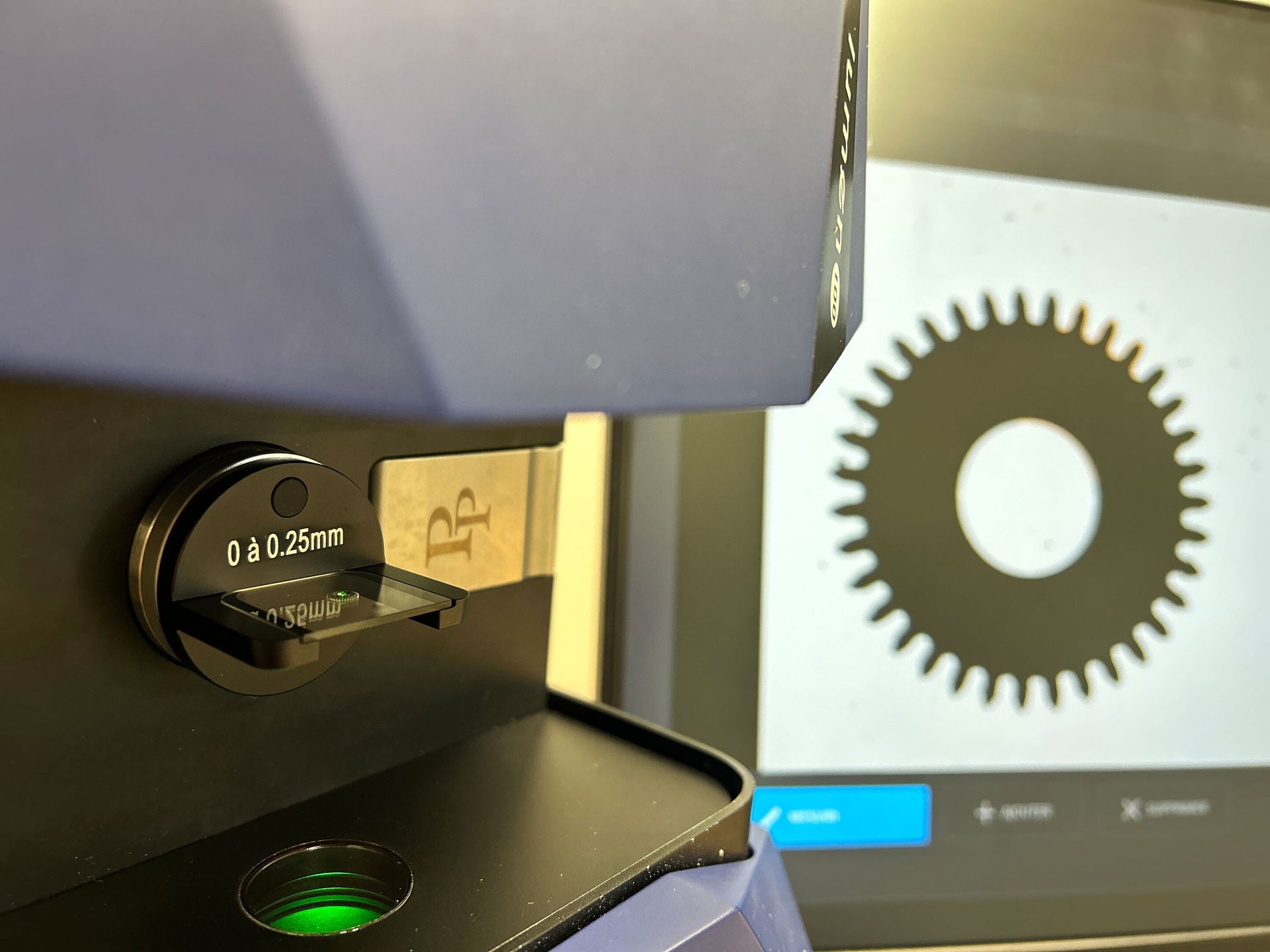

The optical measuring line in the Lumen system consists of a telecentric lens, lighting, a V-shaped device for correct placement of the parts, and two prisms for reflecting the image onto a telecentric optical sensor. The setup also includes a motorized drawer to protect the measuring area from dust and oil, as well as an LED to indicate the system is functioning properly.

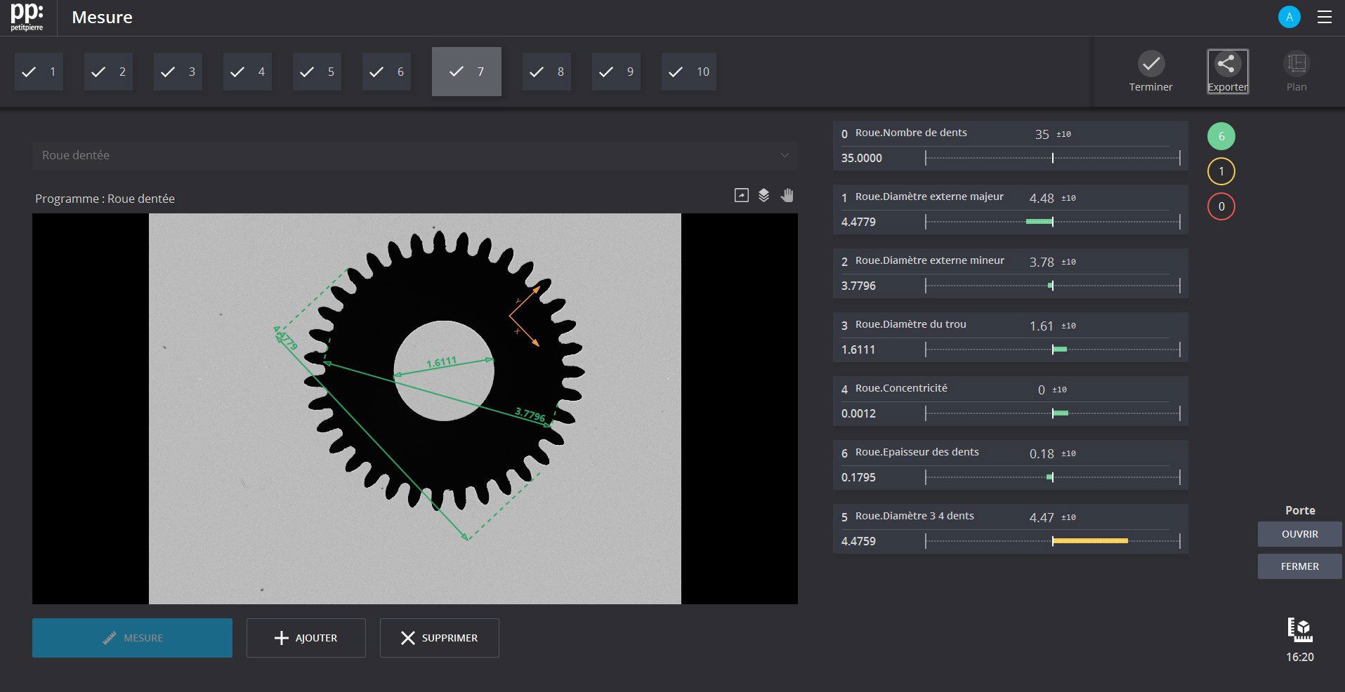

Halcon vision software from MVTec Software GmbH in Munich, Germany, is the brain behind the system.
“We opted for Halcon because it offers all the functions we needed for this application,” says Majoulet. “Besides, its features are robust and, in many cases, ahead of other providers.”
For example, its shape-based 2D matching tool can identify and locate the tiny parts precisely so they can be picked up with a vacuum gripper and measured with submicron precision. The software detects even the smallest contours and inspects them reliably. Specifically, the software measures diameters, lengths, concentricity, radiuses and angles with subpixel accuracy, using a technology known as “subpixel threshold.”
The Halcon software also facilitates the precise camera calibration of the Lumen system.
Another advantage of the Halcon software is its ability to meet the special requirements of telecentric optics, as used in Petitpierre’s Lumen system, with precision right out of the box. The 360-degree measurement of the object means that there is no perspective distortion that would involve time-consuming corrections afterwards. This paves the way for a particularly high level of measurement accuracy.
