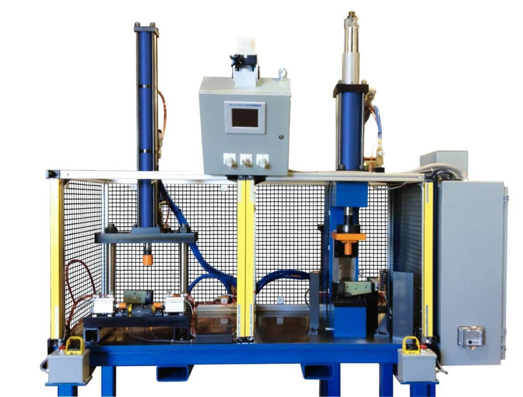

In this system, hydropneumatic presses insert bearings and studs into an automotive component.Photo courtesy Aries Engineering Co. Inc.

These were the choices faced recently by a major U.S. manufacturer of braking and suspension components. The company contacted Aries Engineering Co. Inc. to increase the quality of its finished products and free up floor space for a new assembly line.
The OEM was experiencing persistent interruptions of an assembly line consisting of a rotary indexing dial and hydraulic presses. The presses are used to install bearings and studs in a component. The system was unable to monitor and relay actual insertion forces and distances. Additional floor space was also necessary to make room for a new assembly line, so removing the noisy pumps, bulky accumulator tanks, high-heat motors and leaking hydraulic lines associated with the hydraulic presses was essential.
Aries Engineering retrofitted the indexing table, removing all the hydraulic cylinders and replacing them with IntelliCyl hydropneumatic cylinders operated by simple pneumatic valves. Each pressing station now includes an integral linear variable displacement transducer, a load cell, and a HyperView signature analysis monitor.
The new system actively measures stud and bearing insertion depth by establishing a series of “windows” around two critical points of the press-fit operation: the contact point and the final depth. Only when the correct stack-up height was confirmed would high pressure then activate to press the bearing or stud into the component. This ultimately reduced in-process part non-conformance to near-zero.
