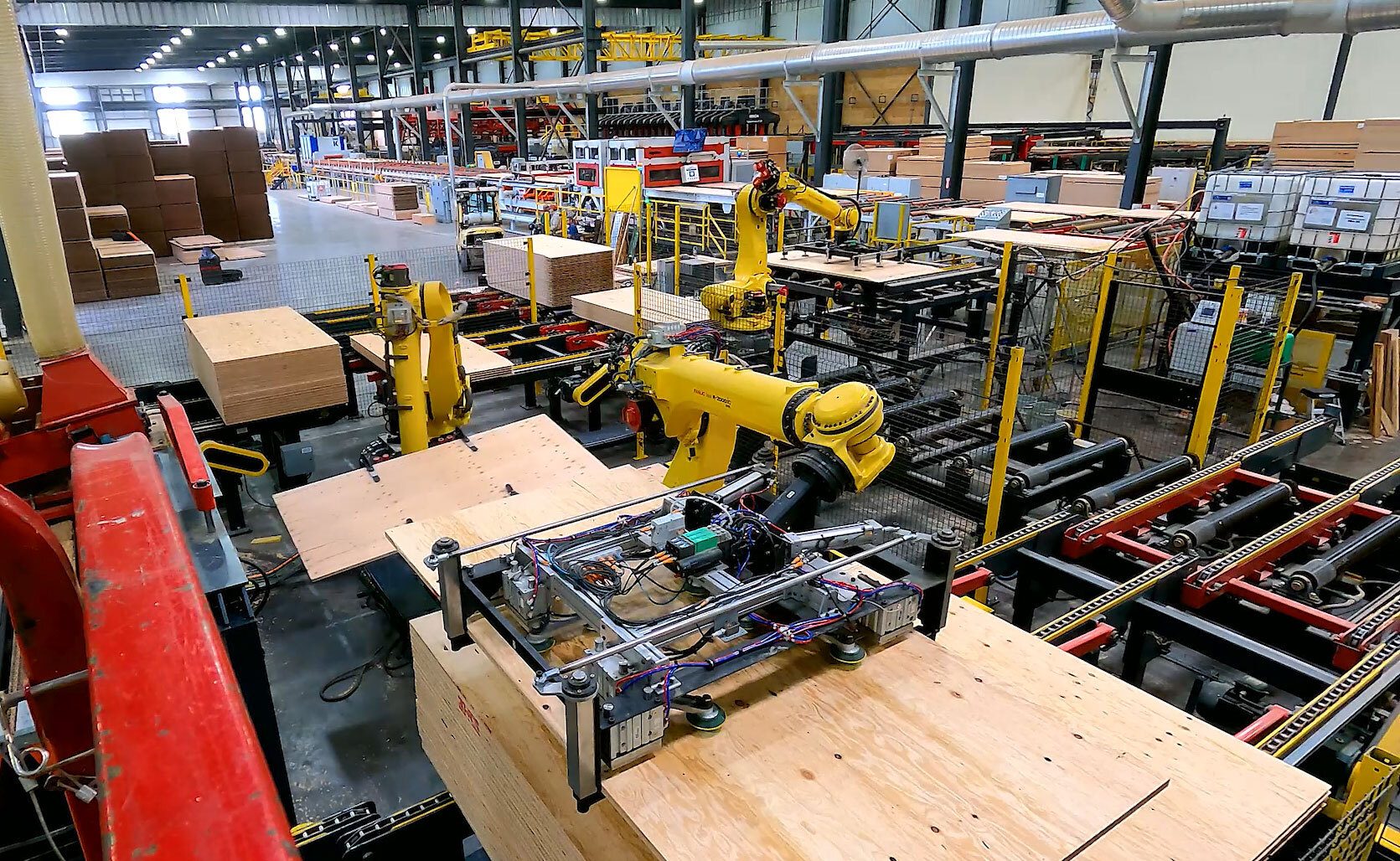

Manufacturers are deploying robots at a record pace. Advances in motion control, vision guidance, artificial intelligence and collaborative technology are making robots easier to implement than ever. Here’s a look at some of the latest in robotic technology. Photo courtesy FANUC America Corp.
