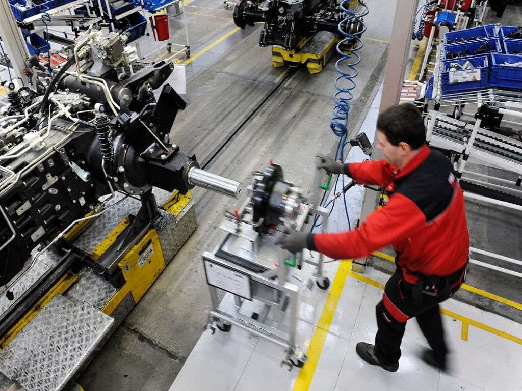

Since each tractor contains thousands of threaded fasteners, CNH engineers must ensure that every screwdriver and nutrunner in the plant is performing perfectly.
In the past, the evaluation of tightening data was done manually, which was time-consuming and error-prone. To live up to the plant’s motto “solve problems before they arise,” engineers wanted to adopt a proactive approach to the assembly process. The goal was to detect anomalies and negative trends in the tightening data automatically, in real time, and thereby prevent defects from occurring.
The factory had been using Atlas Copco fastening tools for many years, so it was the first company CNH engineers turned to when they wanted help with data analysis. Atlas Copco recommended its Alture software.
Alture enables CNH to capture and analyze all tightening data. The software monitors all the technical parameters set on the tool controllers, including torque and angle of rotation. Engineers determine a standard range for each parameter, and these ranges serve as the basis for analysis of assembly quality. Algorithms in the software detect anomalies in the data and determine if they are the beginning of a trend or just one-off occurrences. The software even goes one step further and formulates potential causes for the trends in real time. Accordingly, the user is provided with several recommendations to take action, so that corrections can be made early on.

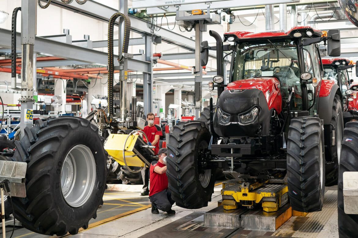

Software informs the assembly team immediately when predefined fastening parameters are exceeded or not met. Photo courtesy CNH Industrial
Thanks to Alture, CNH is now harnessing the full potential of data analysis on the assembly line. Now, the assembly team is informed immediately when the predefined parameters are exceeded or not met. If there are too many deviations in the values, the software communicates precise recommendations to the user. For example, it might advise engineers to inspect the coating on parts or to check the screw threads for lubricant.
Thanks to these sorts of suggestions, the assembly team detected new components with modified materials that would have affected the parameters of the fastened joint. By adjusting the technical parameters in good time, it was possible to avoid faulty assembly and the reworking of numerous tractors.
Thanks to the sensitivity of Alture to deviations in the tightening data, CNH can intervene in the assembly process at an early stage. For the first time, CNH can be proactive instead of merely reacting to situations. This has improved initial production quality, increased productivity, and reduced scrap.
