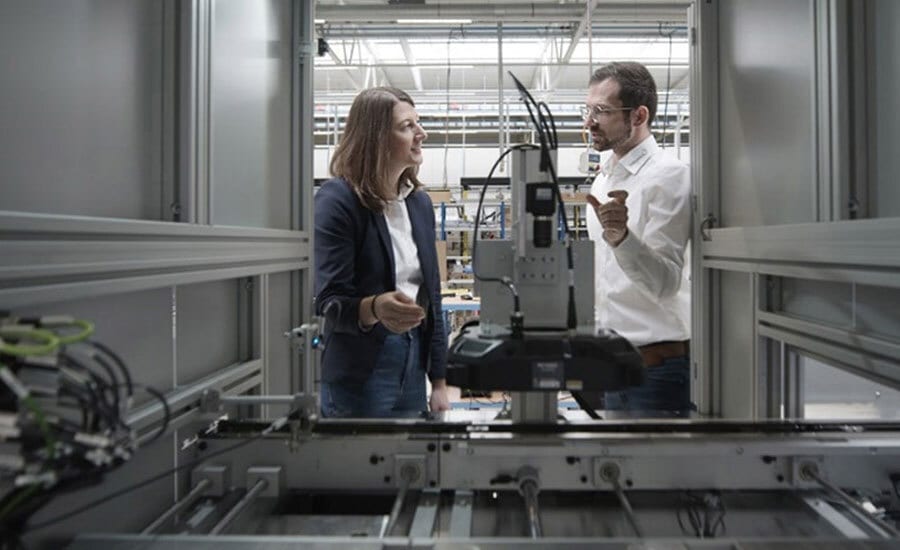

White-collar worker, Technology, Machine, Engineering, Job
In the final step, all parts undergo an optical inspection to ensure the quality of the seals. Photo courtesy Dr. Hönle AG UV Technologie
