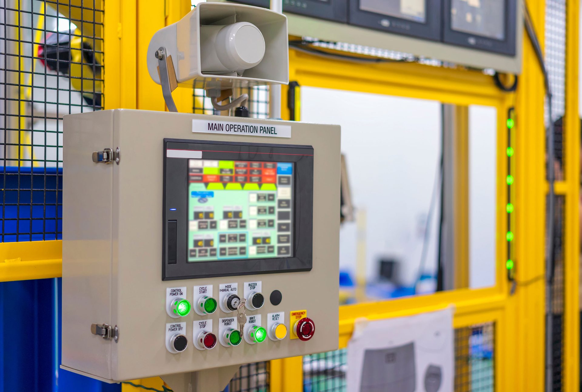

Robots, AGVs and other automation systems can create dangerous workspaces—without the proper safeguards. Photo courtesy DigiKey

As manufacturing becomes increasingly automated, manufacturers must find ways to protect their most important asset: their workforce. Robots, autonomous vehicles, material handling equipment, and more complex systems can create dangerous workspaces—without the proper safeguards installed on the production floor.

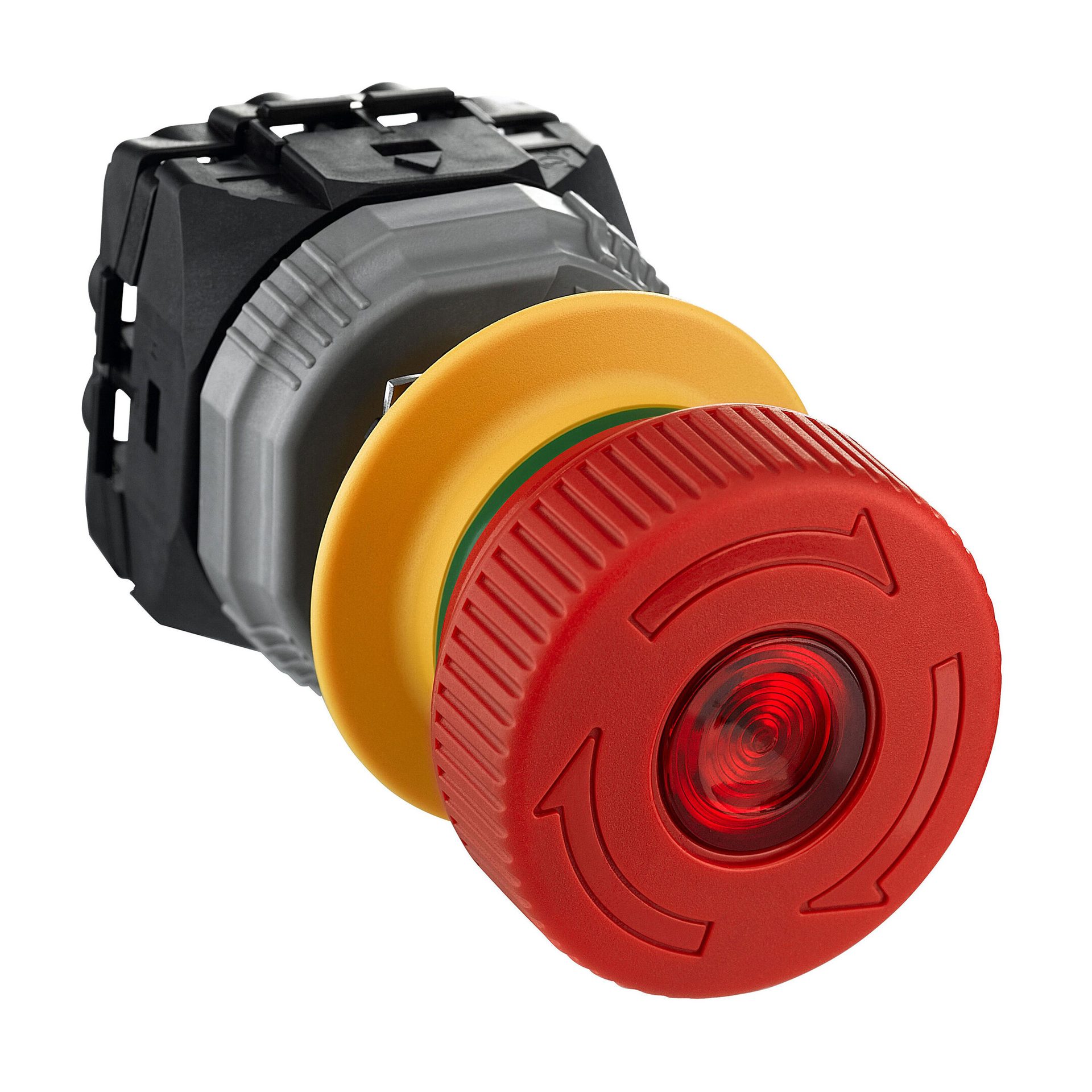

E-stops are one of the most recognizable and most thought-of safety devices on the production floor. Think of them as the immediate interface to stop a machine. The e-stop is typically in a normally closed position within a circuit that, when pressed, opens the circuit and cuts power to the device. To re-engage the circuit, the e-stop must be pulled out or in a twist to the open configuration, returning the circuit to operational.
According to OSHA, ANSI, NFPA79, ISO 13850 and IEC 60204-1, e-stops are required to be installed where they are easily accessible to the operator. Resetting the e-stop should not allow operations to resume. A second redundant action is required, such as an all-clear function through a circuit on the programmable logic controller (PLC).

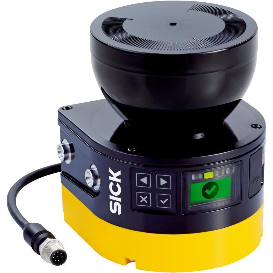

Laser safety scanners have become very popular with the rise of cobots. Photo courtesy DigiKey
The e-stop is typically in a normally closed position within a circuit that, when pressed, opens the circuit and cuts power to the device. Photo courtesy DigiKey

Laser safety scanners have become very popular with the rise of cobots. The scanner uses a 360-degree beam to determine how close a worker or an object is in relation to the robot. The scanner will tell the robot to decrease its speed depending on the closeness of the individual or object. The scanner is usually programmed with preset zones. In the orange or yellow zone, the robot is slowed to collaborative speed until the object or person has exited. If the red zone is triggered, the robot will then slow even further or even stop completely until safe.
