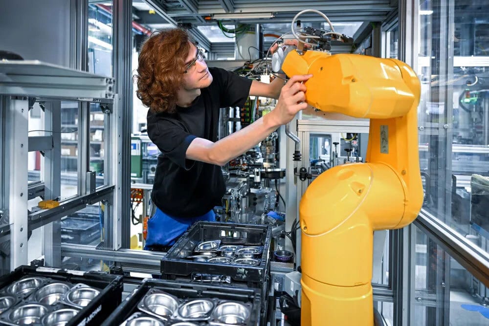

ZF engineers and assemblers quickly got up to speed on managing the new line, which was running 24 hours a day, six days a week, within its first seven months. Photo courtesy ZF Friedrichshafen AG

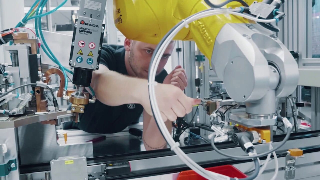

The new assembly line consists of several cells connected in series, all of which are equipped with Stäubli robots. In the first step, two Stäubli TS60 SCARAs insert a metal contact into a printed circuit board. This is followed by the soldering of electrical contacts on the board. During the subsequent quality inspection, another SCARA TS60 manipulates the components.
Technology
The next stage is the over-molding of the PCB. This is carried out by two six-axis RX160 robots, which were chosen for their range and dynamics.
After over-molding, the robots transfer the module to the final quality assurance station, where it is tested for correct triggering in case of an accident. To pass the test, the response time for the air bag signal must not exceed 19 milliseconds.
Due to the flexibility of the line, different variants of the air bag module can be produced. Shortly after the line went into operation, ZF already had 12 models in production. Compared to the manual system, the automated line gets by with 12 fewer people.
