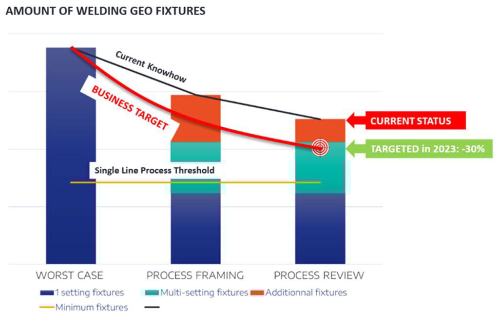

During the process review phase for a recent model change, we determined that we could further reduce costs through optimization activities, thus decreasing the number of additional fixtures required on the body-in-white (BIW) line. Our target was to reduce the number of unique fixtures by 30 percent by the end of 2023.
Diagram
This graph compares the overall costs of geometric fixtures for assembly: worst case (only unique fixtures), process framing phase (some multi-use fixtures and some unique fixtures), and process review phase (minimal number of unique fixtures). Our goal was to reduce the number of unique fixtures by 30 percent. Source: AutoForm Engineering GmbH

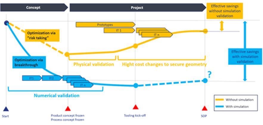

Simulation proves invaluable in reaching our business objectives. Without simulation, we face limitations in the number of possible validation loops for our assembly processes, and each loop typically consumes a substantial amount of time as it relies on physical validation. By that point, it’s often too late for significant product changes, and any geometry optimization necessitates costly mechanical corrective actions that also adversely affect time to market.
Assembly simulation allows us to evaluate concepts early, reduce validation loop durations, and increase their frequency, significantly influencing the product and process during a phase when optimization possibilities abound and ultimately reducing production risks.
Without simulation, process optimization becomes less ambitious since the opportunities to mitigate risks during physical validation are limited. Actual gains remain marginal because the few optimization loops secured during validation come at high costs to minimize time to market.
Text, Font, Diagram
This graph shows the benefits of using simulation for assembly processes assessment. The yellow line shows the process without simulation. Corrective actions occur during tryout when change costs are high. The blue line shows the process with simulation. Corrective actions can be evaluated during engineering, when change costs are lowest, resulting in greater savings overall. Source: AutoForm Engineering GmbH

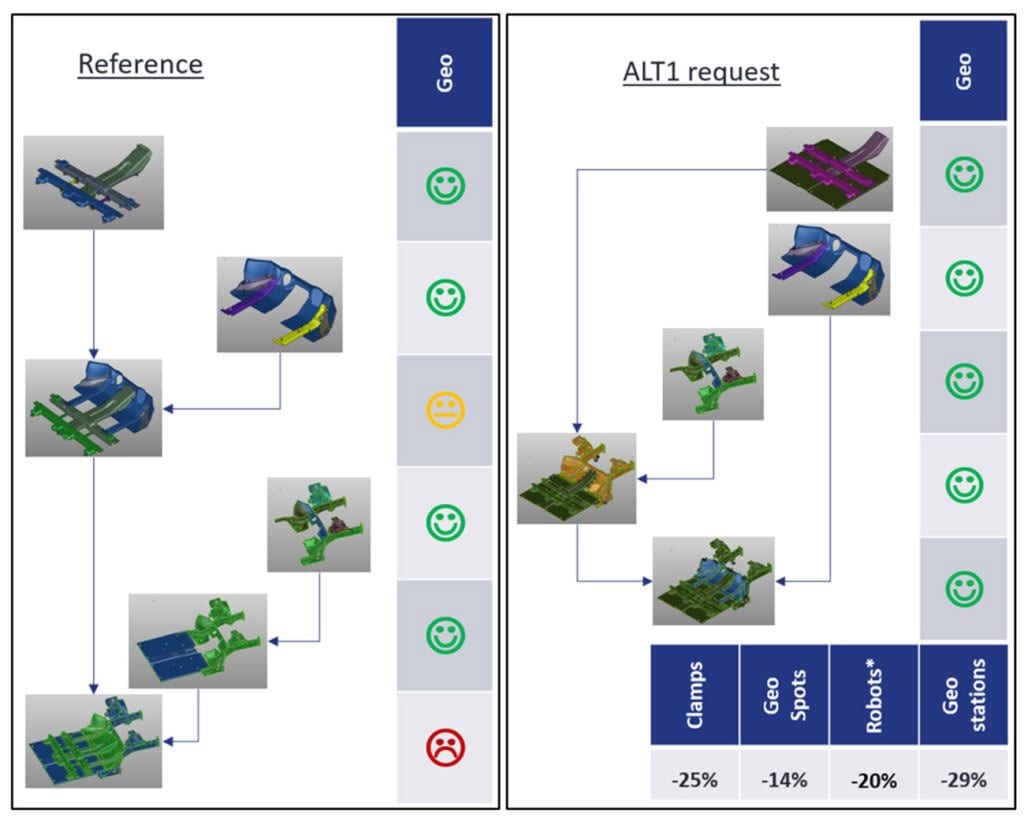

Thanks to AutoForm’s assembly simulation software, we discovered innovative and daring solutions for one of our assemblies that would never have materialized without simulation.
We managed to reduce the assembly sequence from six steps to five. This yielded several benefits, such as a 14 percent reduction in the number of “geospots” (welding points for geometric conformity) and a 20 percent decrease in the number of robots, all while enhancing the overall assembled geometry. Such a drastic process optimization would have been unfeasible after concept freeze without introducing time-to-market delays and significant cost overruns.
The use of assembly simulation is a game-changer for process optimization. We found that product conception and assembly sequence definition often led to an excess of clamps and geospots, occasionally surpassing what robots could handle, resulting in inadequate cost efficiency during the design and test phases. Additionally, we found significant transfer issues between our assembly posts, which could be resolved by strengthening subassemblies.
Through our study, we improved geometry cost efficiency by reducing the number of geospots and enhancing subassembly stiffness, all accomplished via sequence and product changes conducted within the simulation.
