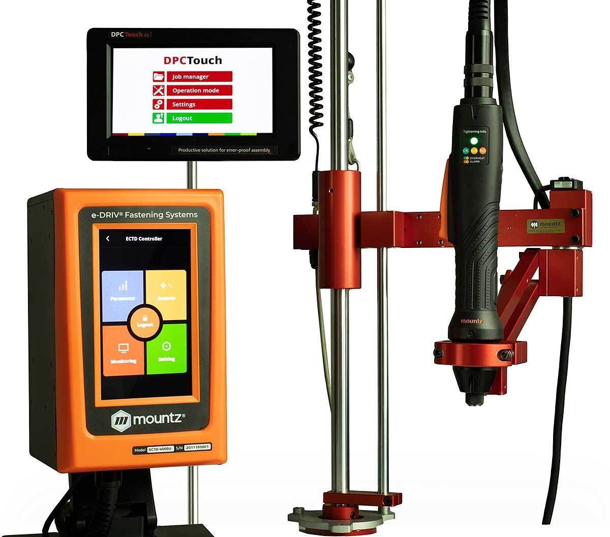

Manufacturers are increasingly using EC and ECT-Series smart screwdrivers with the DPC-Touch Posi-Control system, consisting of a touch-control device and a position-control torque arm. Photo courtesy Mountz Inc.

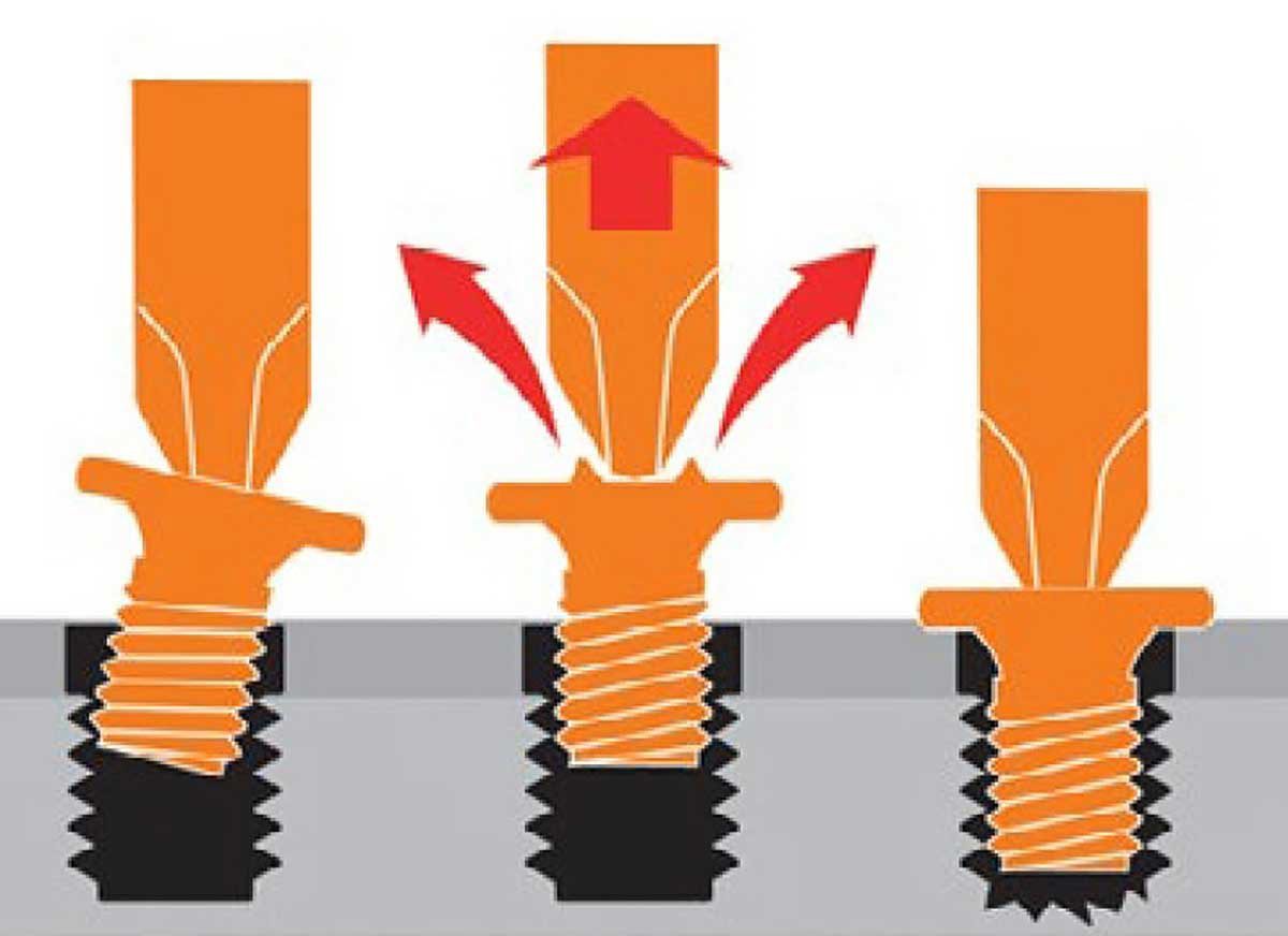

A common fastener-related error during assembly is cam out, which is when the driver bit is forced back out of the screw recess under torsional load. Most of the time, this event reduces the amount of torque used to tighten a screw.

Cross-threading is a common error that happens when screw threads do not properly align with those in the threaded hole of the mating material. Sometimes the problem is remedied by re-engaging the parts at a different angle. But, if left unfixed, the fastener may not properly seat and its threads will be unable to sustain the clamp load.

Three common fastener-related errors during screwdriving are cross-threading (left), cam out (center) and stripped hole threads. Graphic courtesy Mountz Inc.
Pistol-grip, right-angle and inline EC and ECT-Series smart screwdrivers from Mountz feature a built-in sensor that continually measures torque in real-time and provides data feedback. Both series are corded tools, but the latter are also transducerized. They work with ECD and ECD-T controllers, respectively, which expedite all aspects of the automation process, and can be used with up to 15 fastening profile presets.
Cash says manufacturers increasingly use these screwdrivers with the company’s DPC-Touch Posi-Control system, consisting of a touch-control device and a position-control torque arm. Built-in encoders in the arm send positioning data to the device, where it is saved along with the time it took to complete the screw rundown. During subsequent fastening operations, the device only clears a sequence when it has been completed within the preset parameters.
“With these smart screwdrivers and controllers, an operator can quickly determine if a cross-threading or stripped-thread problem has occurred during fastening,” concludes Cash. “Reaching the proper preset torque value requires a screw to rotate a specific number of degrees, say 4,000 [i.e., 360 degrees by 11 rotations]. A too-low number usually indicates cross-threading, whereas a too-high-number indicates stripped hole threads that prevent interlocking with fastener threads.”
