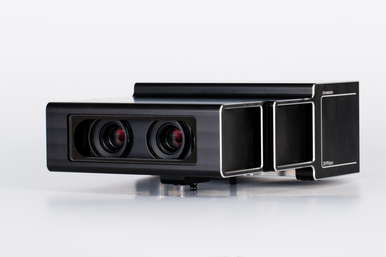

The Chromasens 3DPIXA dual 30µm combines line-scan camera technology with fast 3D stereo computation on graphics cards. The stereo line-scan camera delivers 3D data and color images at the same time. Photo courtesy Chromasens

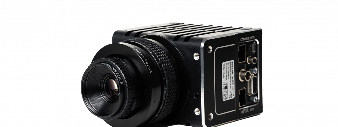

The allPIXA evo 8K offers CMOS performance with CCD image quality. The novel multiline CMOS sensor features TDI options for color and monochrome images at high speed. Line rates up to 90 kHz in full color are possible with the fast and cost-efficient Dual 10 GigE interface. Photo courtesy Chromasens

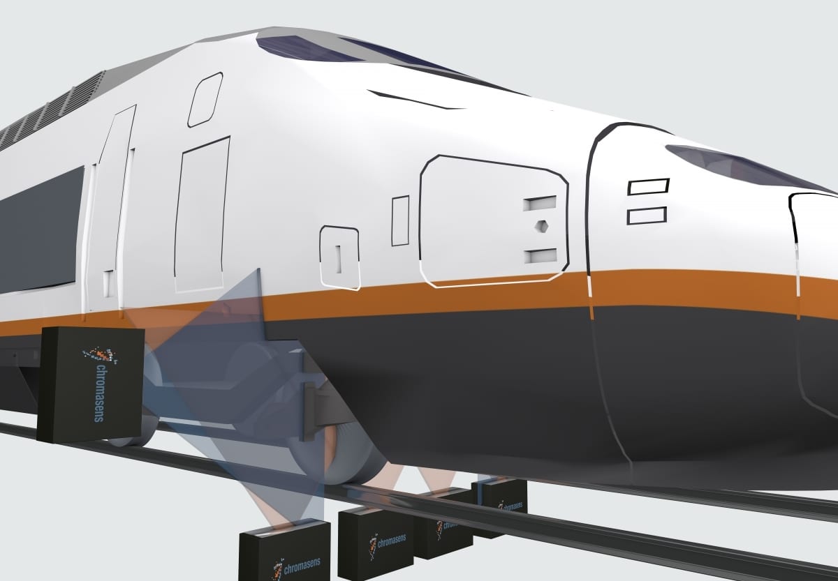

Line-scan cameras are ideal for inspecting objects moving at high speed, such as rail cars. Illustration courtesy Chromasens

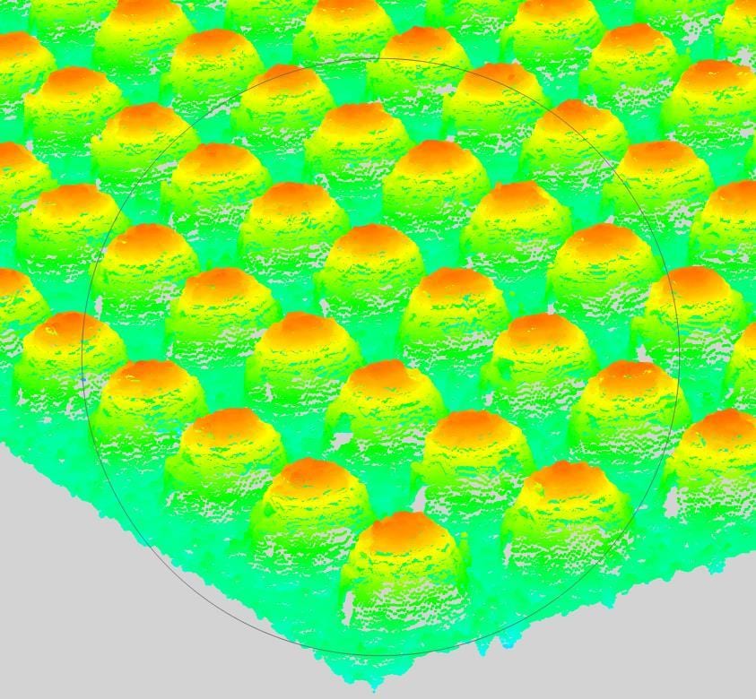

Over the past few years, vision system manufacturers have introduced a variety of 3D imaging methodologies, ranging from time-of-flight analysis and projected pattern correlation to laser triangulation measurements and stereoscopic technologies. Of these, stereoscopic, or just “stereo,” systems have gained the most traction, particularly in the semiconductor industry. Components, such as solder balls or pins used to connect wafers and dies, must be inspected with 3D methods to precisely measure the height of the conducting elements. The typical dimensions of such components are around 50 microns, which means the inspection system must have optical resolution of at least 5 microns.
The basic concept behind stereo 3D vision systems resembles that of human vision. Two image sensors in a stereo configuration are combined into one camera, resulting in two images being acquired of the same object from slightly different perspectives. This serves as the basis for triangulation, which involves an object point projected in both stereo images, and two image points that are the positions of the right and left cameras.
Vision system suppliers are now combining the best of both worlds: line-scan with stereo. These cameras have linear sensors up to 8,000 pixels in RGB to provide both high resolution and a large field of view. Fine structures on the surface of the object under inspection are resolved using high-resolution images, which is an advantage for the passive stereo approach. Because of this improved accuracy, they open up new 3D applications that are not possible with other approaches to detect the most minute of defects. Another advantage is speed. Linear sensors have line rates of up to 50 kHz even at extremely high resolutions. Finally, this approach results in less occlusions: The stereo line-scan cameras are oriented perpendicular to the object surface, and there are no occlusions in transport direction.
Organism
Components, such as solder balls or pins used to connect wafers and dies, must be inspected with 3D methods to precisely measure the height of the conducting elements. Photo courtesy Chromasens
