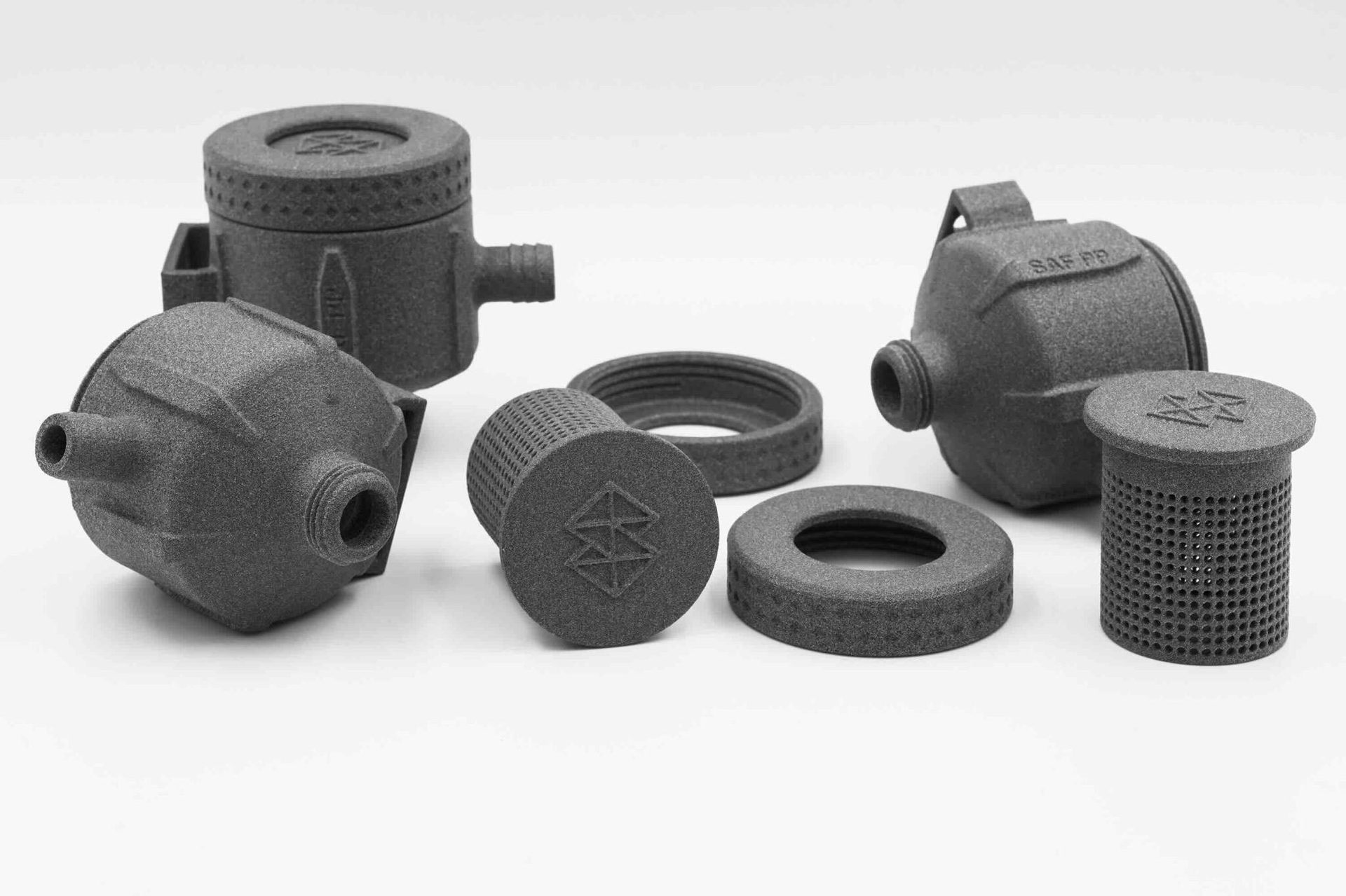

Approximately one-fourth of today’s plastics applications involve polypropylene (PP), a popular choice because of its strength, durability, moisture resistance, and relatively low cost. But with such advantages comes a challenge: PP has low surface energy (LSE), making it difficult to use adhesives for bonding. That means engineers often opt for more costly joining methods, such as welding or mechanical fastening.
Now, however, advances in adhesive chemistry have spawned a new generation of adhesives designed specifically for bonding LSE materials like PP, giving engineers new options for adding value to their product designs and making life easier for assemblers across many industries.
Polypropylene has a low surface energy, which means its molecules do not readily attract or adhere to other substances. This property is due to its non-polar molecular structure, composed mostly of carbon and hydrogen atoms without polar functional groups like hydroxyl (OH), a structure that offers fewer sites for the hydrogen binding, which is necessary for adhesion to many surfaces.
PP is chemically inert and resistant to many solvents, acids and bases. This resistance also reduces its reactivity with adhesives and coatings, making it challenging to establish strong bonds. Polypropylene often has a semicrystalline structure, where polymer chains are arranged in ordered crystalline regions. This structure reduces the surface area available for bonding, as compared to materials with an amorphous structure.

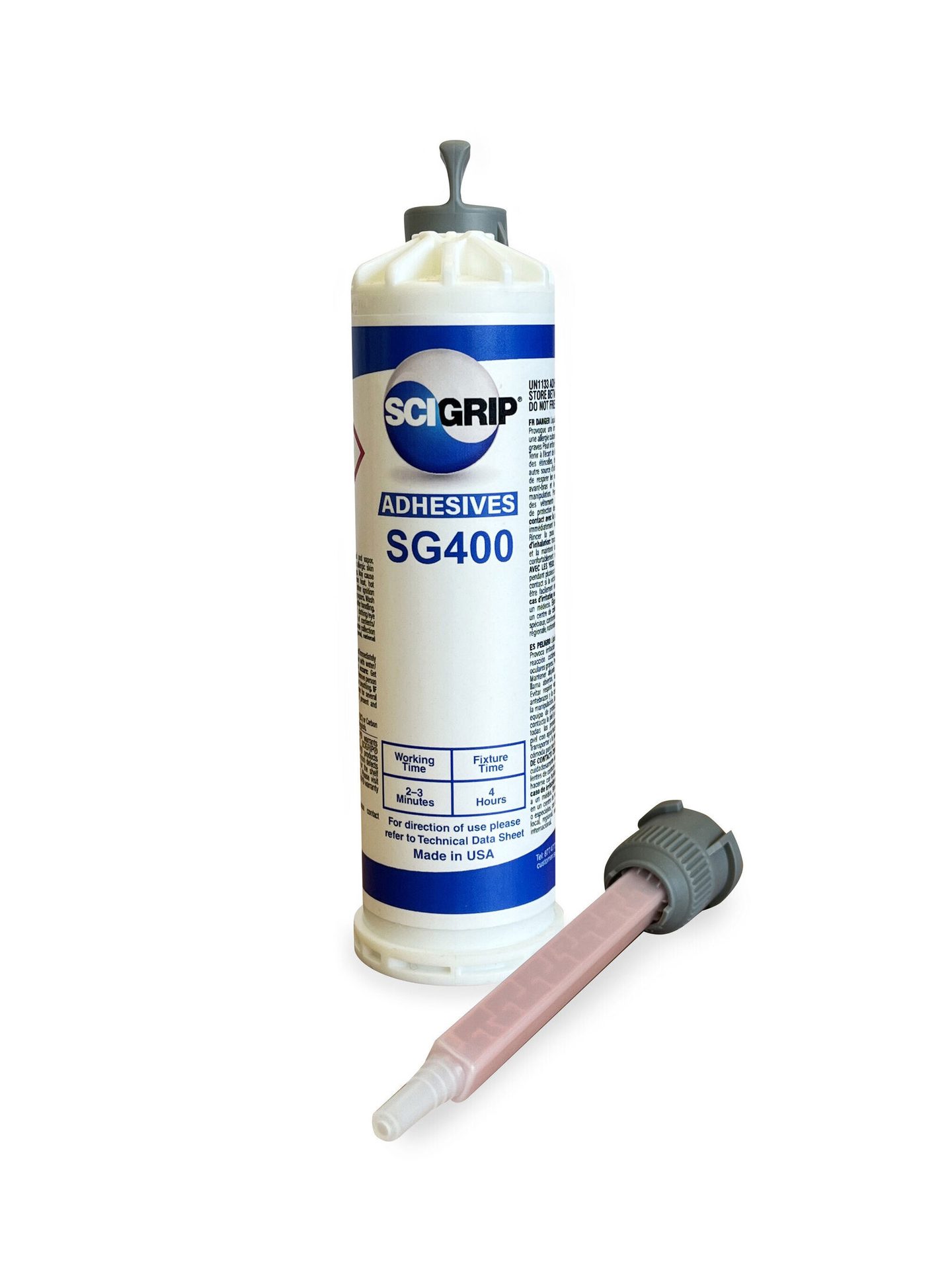

Selecting an Adhesive for LSE Materials
Adhesives for LSE materials differ regarding what they can bond, surface treatment requirements, test data, environmental resistance characteristics, curing and set times, and sag performance. When evaluating adhesives, consider the following:
    • Surface compatibility. Read the fine print. While many packages say they bond plastic, some work well with certain plastics, but not others due to differences in surface characteristics. Surface preparation requirements may also be stated. If PP must be bonded, be sure it is specifically mentioned.
     Implementation. Review and follow vendor guidelines closely. LSE bonding can be tricky, and there is little tolerance for variation from the established procedure.
     The curing and setting time. How long does it take the bond to set initially and finally cure? Most LSE adhesives will set within about six hours and cure fully in about 24 hours. Be wary of any process that claims faster or significantly longer duration.
     Test results. LSE adhesives are relatively new on the market, so many companies may still be testing their adhesives on various materials, but some results are emerging. Most vendors will publish what they have tested and will provide samples so you can do your own testing.
     Low Sag. Low sag is the ability of the adhesive to resist flowing or slumping when it is applied to a substrate vertically or overhead. This property is valuable, particularly when bonding two surfaces that are not in a horizontal position. A low-sag adhesive will not drip or run, enabling more precise application. More precision improves bonding by maintaining a consistent bonding surface. It also saves money by reducing waste and improves overall productivity by ensuring consistent application.
     Bond strength: After allowing the adhesive to cure fully according to the manufacturer’s instructions, test the bond strength. Try to peel or stress the bond to see if it holds up to normal use conditions. It is important to do this 24 hours, and then maybe each month. If you get past three months, you can be confident that you have a permanent bond. (Note that it is often the case that the substrate will fail before the adhesive.)
     Environmental stability: Review environmental factors such as temperature variations, moisture, UV exposure, and chemicals, depending on where the plastic will be used.
     Support: Vendors are anxious to expand applications for their products, so most will be more than happy to work closely with manufacturers to understand how their adhesives can achieve new bonds.

SCIGRIP SG400LSE is specifically formulated for strong, reliable bonding on LSE materials, such as PP and polyethylene. The new adhesive requires no surface preparation and has low sag. Photo courtesy IPS Adhesives
Designers of consumer products often start out using fasteners. Adhesives, however, offer advantages in terms of aesthetic appeal (no visible fasteners), structural integrity, and simplification of assembly processes. For instance, one manufacturer needed a smooth PP surface for a product that required a particular touch and feel. However, the plastic part also had to be joined to an aluminum backing to provide structural integrity. An adhesive that could bond PP to aluminum was perfect for this application.
