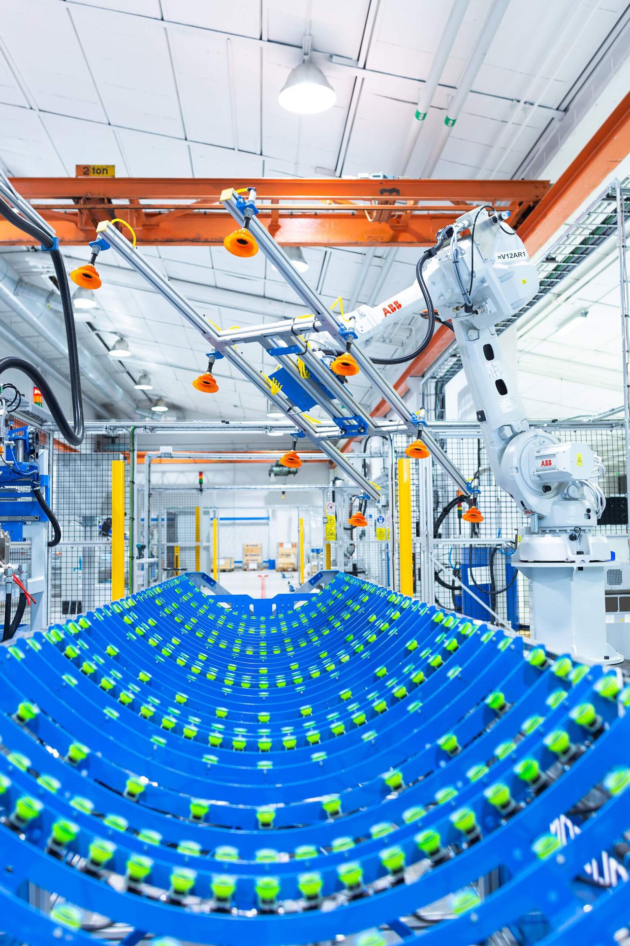

This robot applies the reflective material to the base of the collector. Photo courtesy Absolicon

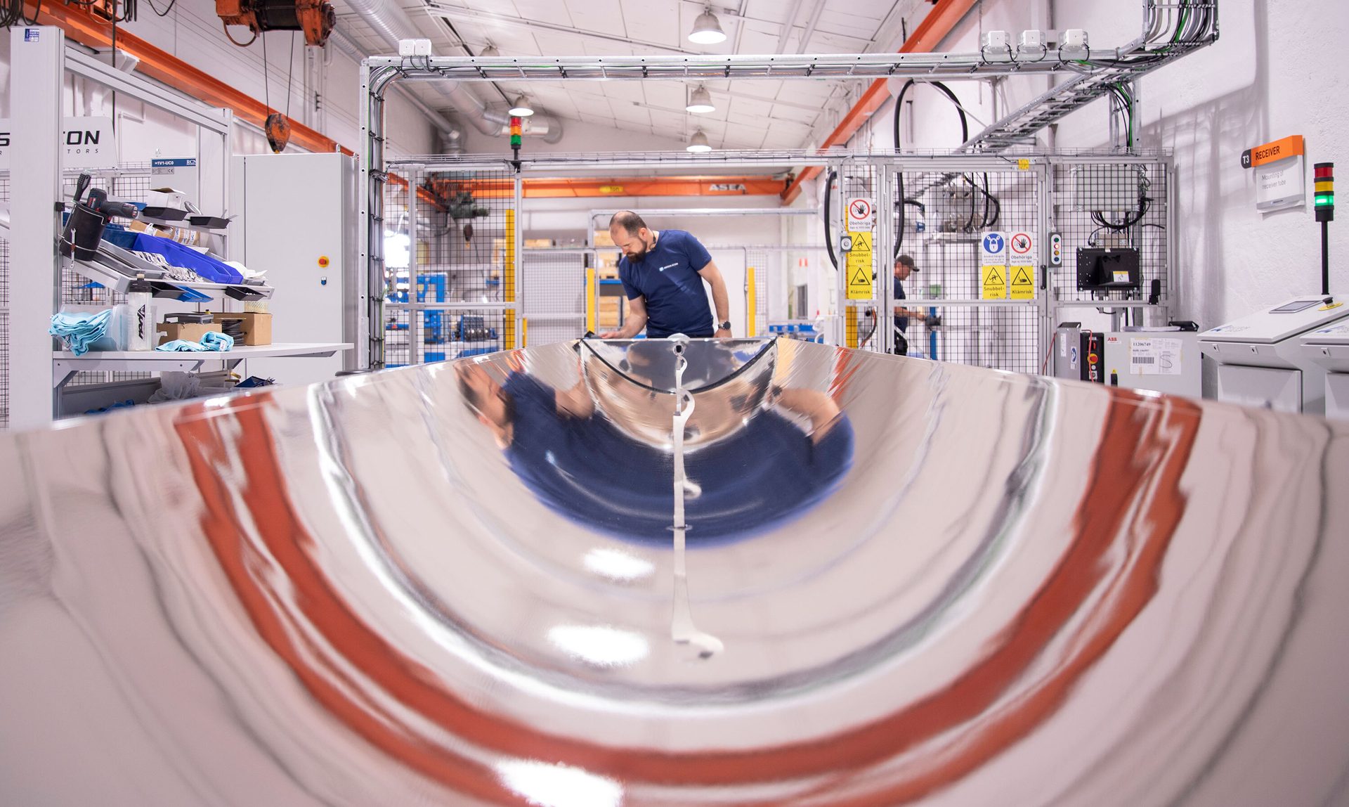

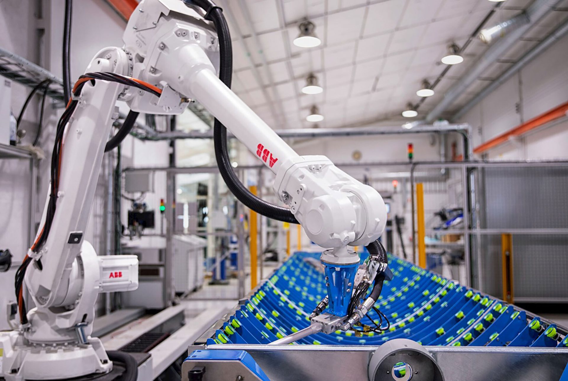

Assembling the collectors, which measure 18 feet long and 3.5 feet wide, requires accuracy and repeatability. A pair of six-axis robots from ABB are enabling the company to meet growing demand for its products without compromising on quality.
At Absolicon’s factory in Härnösand, Sweden, the degree of automation has increased production drastically. Where previously Absolicon was able to assemble three collectors per day using manual production methods, the robotic production line can assemble a collector in as little as six minutes.
The automated line significantly reduces the skilled labor requirements and cycle time for each collector, substantially reducing the overall unit cost. The consistent performance of the robots also enables each collector to be assembled in the same way, ensuring that the highest levels of quality are maintained throughout production and that the collectors will perform optimally once installed.

This robot dispenses adhesive to bond the reflective material. Photo courtesy Absolicon
