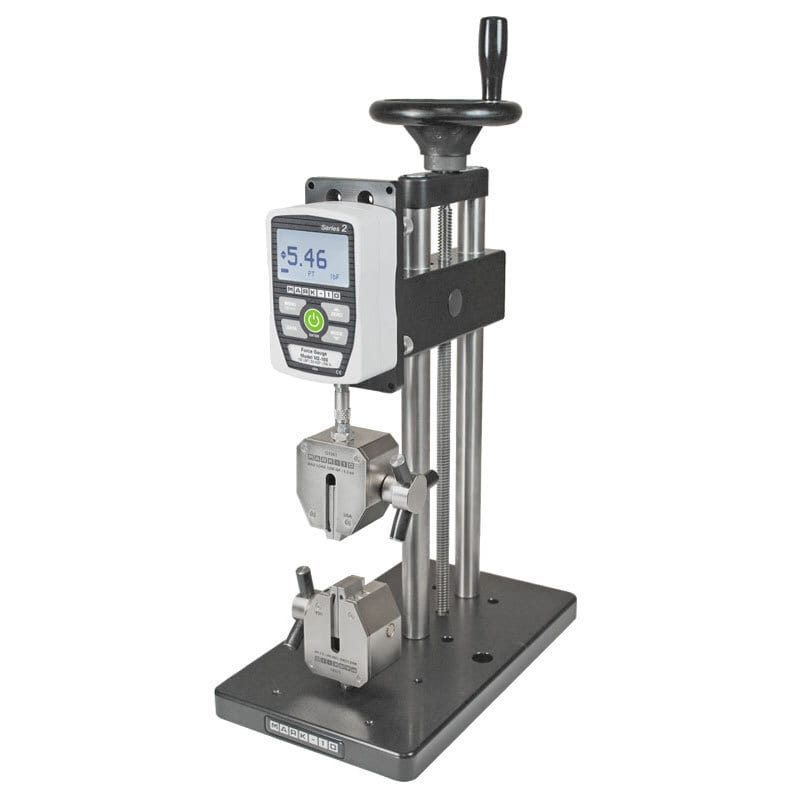

In the test, a sample is placed between a load cell and a fixed base plate, and a beam moves the sample. The load cell records the force on the sample, and an extensometer measures the strain.

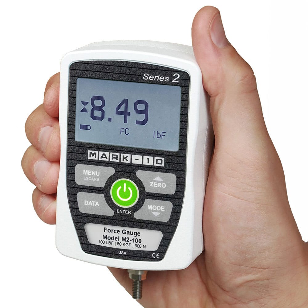

The Series 2 digital force gauges are designed for basic tension and compression force testing applications up to 500 pounds. Photo courtesy Mark-10 Corp.

The gauges are compatible with a variety of test stands and grips. Photo courtesy Mark-10 Corp.
The Series 2 digital force gauges from Mark-10 Corp. are designed for basic tension and compression force testing applications up to 500 pounds. Peak tension and compression readings are reliably captured via the gauges’ ±0.5 percent accuracy and 500 hertz sampling rate. Results can be displayed in one of three units of measurement.
A backlit graphic LCD displays the current, peak tension, or peak compression reading. A USB output is provided for data collection.
These compact gauges are overload protected to 200 percent of capacity. An ergonomic, reversible aluminum housing allows for handheld use or fixture mounting. It is rugged enough for applications in both production and laboratory environments. The gauges are compatible with a variety of test stands and grips.
