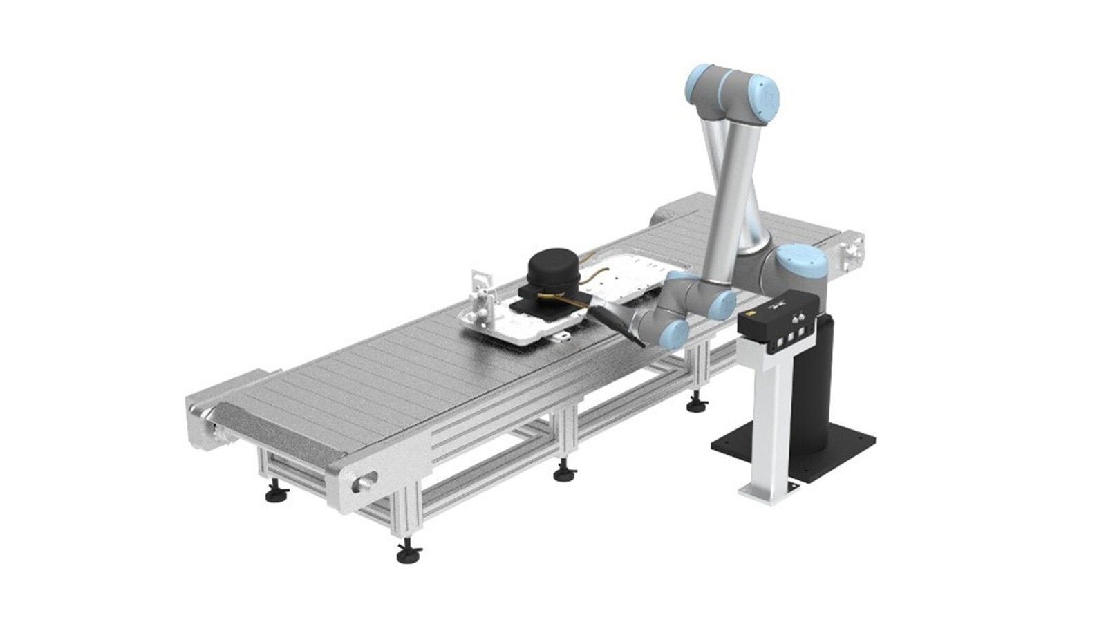

A collaborative robotic arm on a conveyor belt system for automated material handling.
The Mech-Eye camera is in a fixed position across from the workpiece. It takes images of weld joints and maps the surroundings. Photo courtesy Mech-Mind Robotics Technologies Co. Ltd.

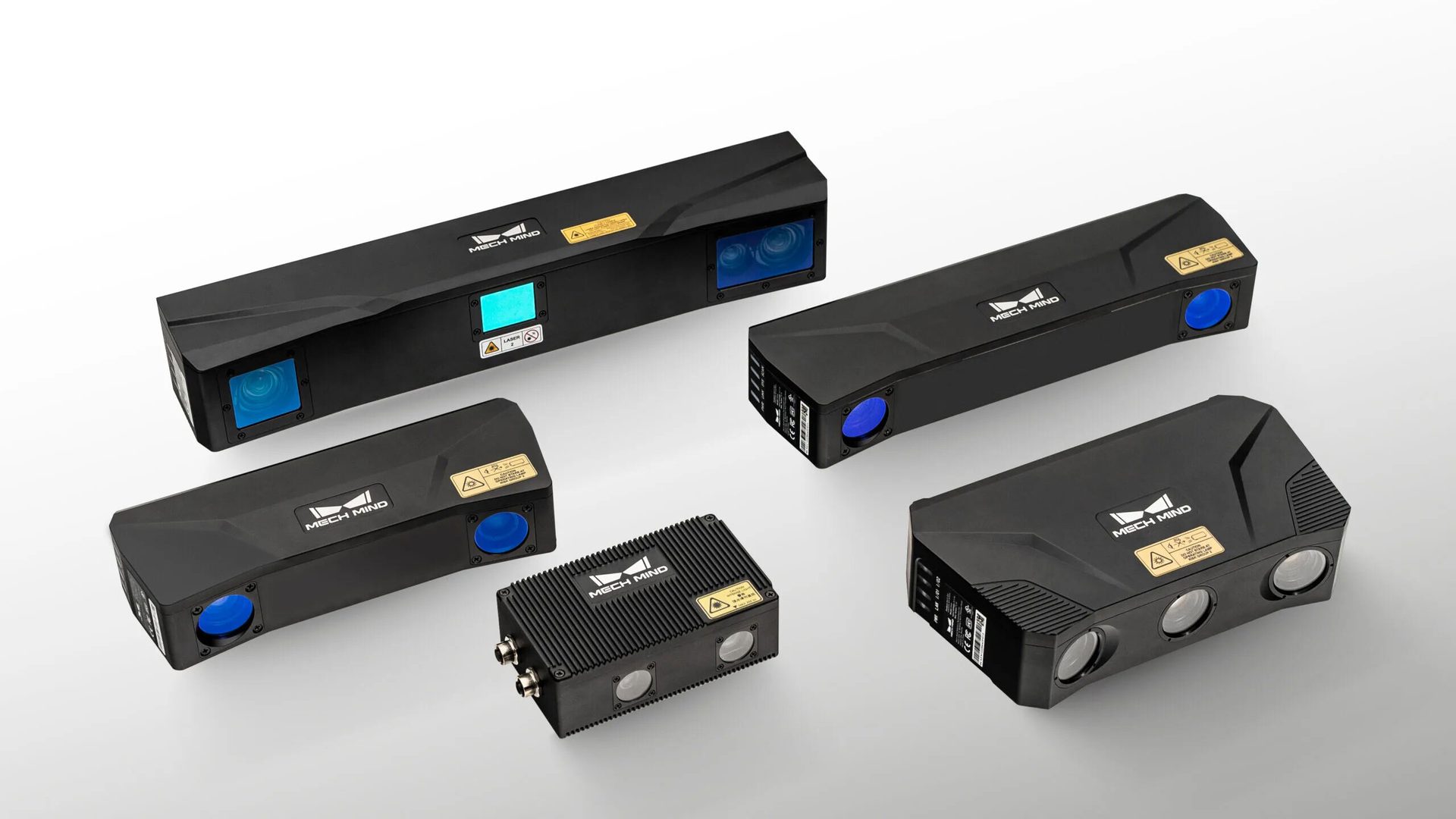

Several black Mech-Mind industrial 3D sensors with blue lenses on a white background.
Mech-Eye vision cameras provide high-resolution, detail-rich 3D images for inspection and robot guidance applications. A variety of models are available to satisfy diverse needs, such ambient light resistance or high scanning speed. Photo courtesy Mech-Mind Robotics Technologies Co. Ltd.

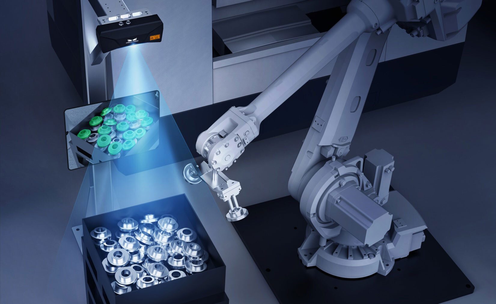

Automated robot arm uses an overhead vision sensor to pick parts from bins.
Mech-Eye vision systems can be used for complex robotic applications, such as bin picking. Photo courtesy Mech-Mind Robotics Technologies Co. Ltd.

At the factory in Gebze, the Mech-Eye camera is in a fixed position across from the workpiece. It takes images of weld joints and maps the surroundings. Mech-Vision provides the robot with the location of all the weld joints at one time and guides the robot which spot to check first. This ensures that the robot can test all the joints one after another with only one data capture, optimizing efficiency. The software excludes the high-pressure joint and only includes the low-pressure joints.
