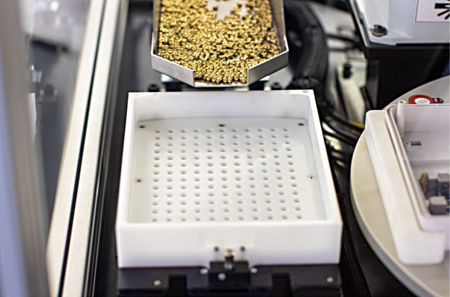

A chute deposits threaded brass inserts into a custom-made vibratory table, which orients them for pick-up by a SCARA robot. Photo courtesy Epson Robots

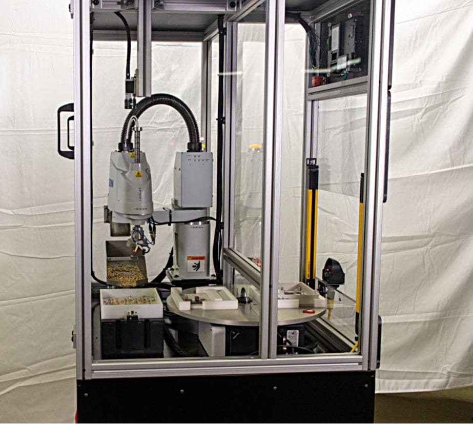

The workhorse of the Flex-Bot system is Epson Robot’s T3 all-in-one SCARA robot with built-in controller. Photo courtesy Epson Robots

Recently, Medbio needed a more efficient way to install threaded brass inserts into injection-molded bosses. Operators were performing the assembly manually and found it challenging to complete accurately and consistently because the inserts are small, and the top and bottom diameters of the inserts are similar. Moreover, the work was repetitive and dull, and Medbio wanted to use its skilled operators more effectively.
The problem, however, was that the company had been unable to find an effective way to automate the process of feeding the inserts, since it was a high-mix operation. In past projects, engineers encountered jamming issues when using bowl feeders to supply the inserts.
Engineered Vision, an Epson Automate Elite Gold partner in Plain City, OH, solved the problem with its Flex-Bot flexible feeding and assembly system.
Unlike bowl feeders, which are designed to feed one part in a high-volume operation, Flex-Bot can accommodate multiple parts and orientations using robots for the pick and place operation. The versatile system can feed metal, plastic or rubber parts. It handles simple and complex parts, ranging from 5 to 40 millimeters in size. Multiaxis vibration technology optimizes part control, singulation and part flipping.

The workhorse of the Flex-Bot system is Epson Robot’s T3 all-in-one SCARA robot with built-in controller. Compact and lightweight, the T3 offers a variety of integrated options, including vision guidance and the IntelliFlex Feeding System, which enables the Flex-Bot system to seamlessly and effectively singulate parts for pick-up.
Flex-Bot is also fully integrated with the intuitive Epson RC+ development software, which makes setup and configuration easy. The point-and-click software interface minimizes program development time from weeks to only days.
