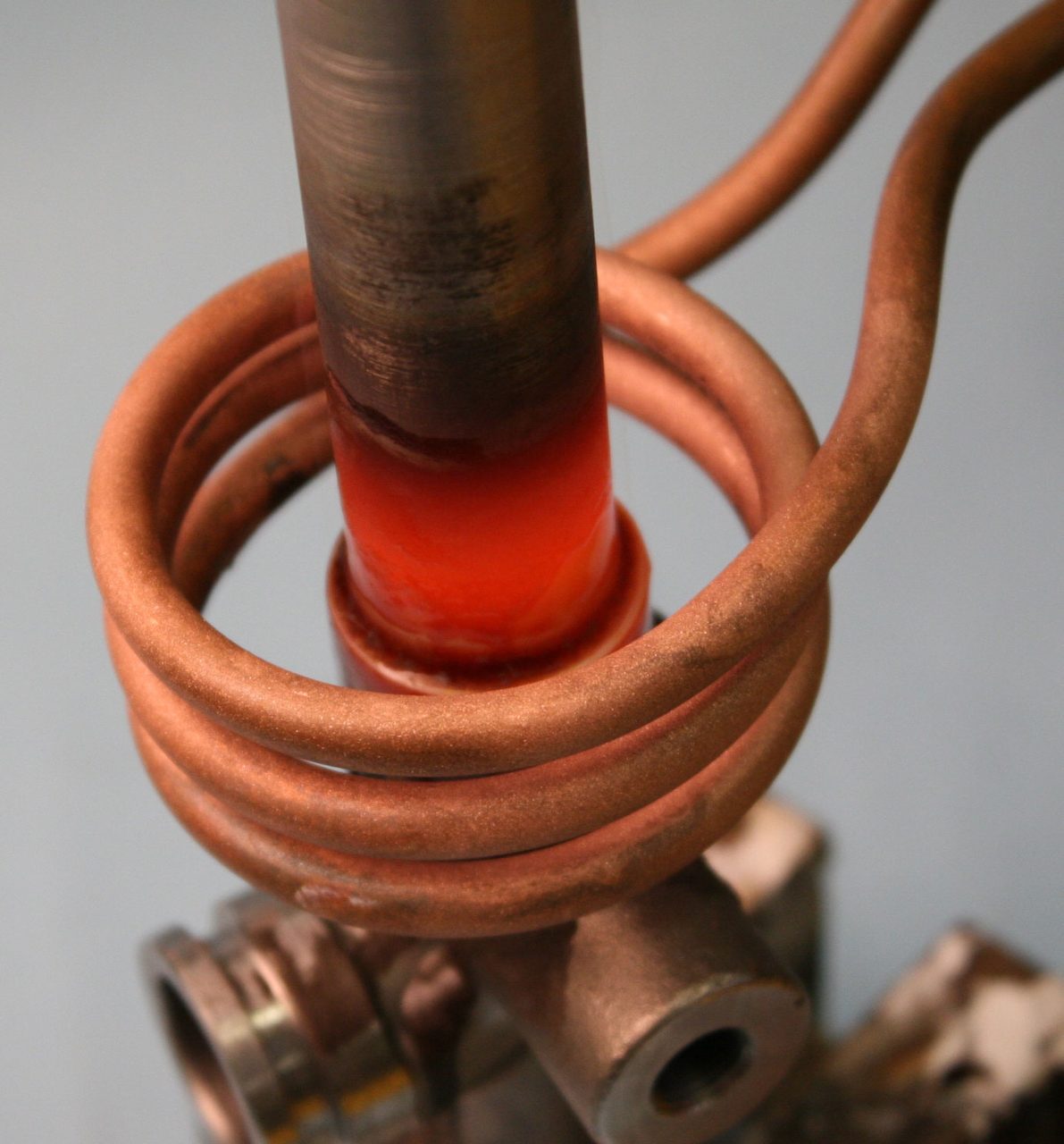

The heat for brazing can be supplied by a torch, a furnace or an induction coil. During induction brazing, an induction coil generates a magnetic field that heats the base materials to melt the filler metal. For a growing number of assembly applications, induction brazing is proving to be the best option.

During induction brazing, the induction coil generates a magnetic field that heats the base material to melt a filler metal. Photo courtesy Ambrell Corp.

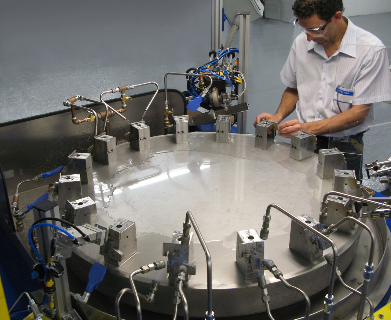

An operator loads fixtures on the Fusion Rotary 200 machine with parts prior to automatically induction brazing them. The custom machine welds 50 parts per hour. Photo courtesy Fusion Inc.

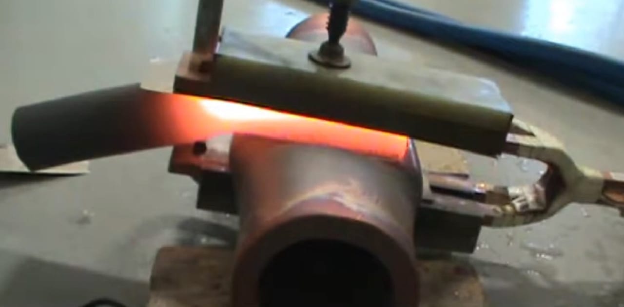

The operator then positions the induction coil, which comes in many designs. A helical coil is round or elliptical and fully surrounds the part, whereas a fork (or tong) coil is positioned down each side of the joint, and a channel coil hooks over the part. Other coils include internal diameter (ID), ID/outer diameter (OD), pancake, open-ended and multi-position.
Uniform heat is essential for a high-quality braze joint. To achieve this, the operator needs to make sure the vertical distance between each induction coil loop is small, and the coupling distance—the gap width from the coil OD to ID—is kept even.
Next, the operator turns on the power to begin the process of heating the joint. This involves the rapid transfer of a medium- or high-frequency alternating current from the power supply to the inductor to create an alternating magnetic field around it.

Recently, a manufacturer used the ECO LINE MF 100-kilowatt generator to induction braze a copper circuit ring to a copper tap connection for a generator at a hydro-electric dam. Photo courtesy eldec LLC
The magnetic field generates an induced current in the surface of the joint, which generates heat to melt the filler metal so it flows and wets the metal parts’ surfaces, resulting in a strong bond. With a multi-position coil, this process can be simultaneously performed on multiple parts at the same time.

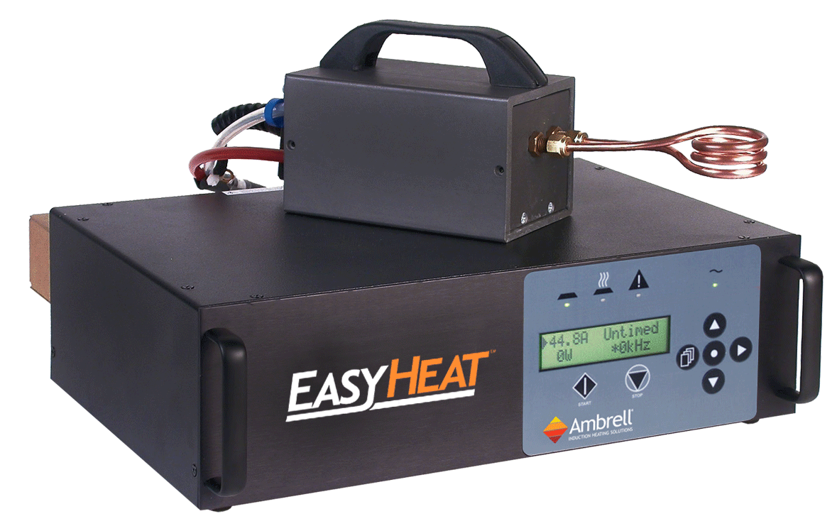

EasyHeat systems have a frequency range of 150 to 400 kilohertz, making them ideal for induction brazing of small parts with various geometries. Photo courtesy Ambrell Corp.

All six EasyHeat systems from Ambrell have a frequency range of 150 to 400 kilohertz, making them ideal for induction brazing of small parts with various geometries. The compact models (0112 and 0224) offer power control within a 25-watt resolution; models in the LI series (3542, 5060, 7590, 8310) provide control within a 50-watt resolution.
Both series have a movable workhead that can be located up to 10 feet from the power supply. The systems’ front-panel controller is programmable, allowing end-users to define up to four different heating profiles, each with up to five time and power steps. Remote power control is available for contact or analog inputs, or an optional serial data port.

Fusion sells custom rotary systems that can induction braze 100 to 1,000 parts per hour. The higher volume is possible for a single type of part or a specific family of parts, according to Cukelj. These parts can range in size from 2 to 14 square inches.
“Each system incorporates an indexer from Stelron Components Inc. with eight, 10 or 12 stations,” explains Cukelj. “Some stations are for brazing, while others are either for inspection, using a vision camera or laser measurement device, or pull testing to ensure a high-quality brazed joint.”
