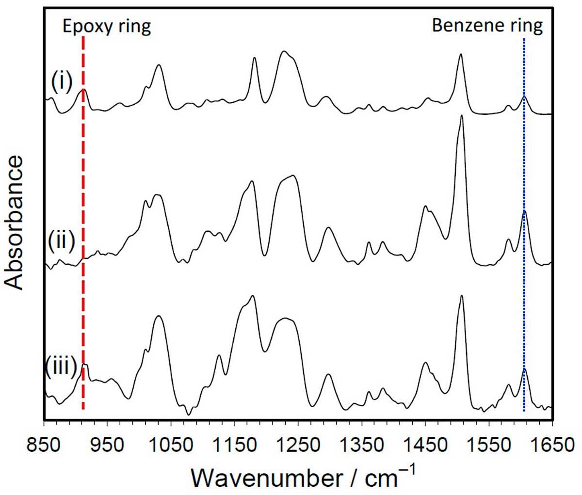

The quality of the cured adhesive was examined by attenuated total reflectance Fourier-transform infrared spectroscopy. Our tests indicated complete cross-linking of BADGE after 10 minutes of microwave heating. In contrast, complete cross-linking had not occurred after 20 minutes in the furnace. Source: Sophia University

The difference in the structure of the adhesive between microwave heating and conventional heating after curing was investigated by the attenuated total reflection technique using a diamond prism in the FTIR spectrophotometer. Differential scanning calorimetry was also performed. No differences were observed in the results.

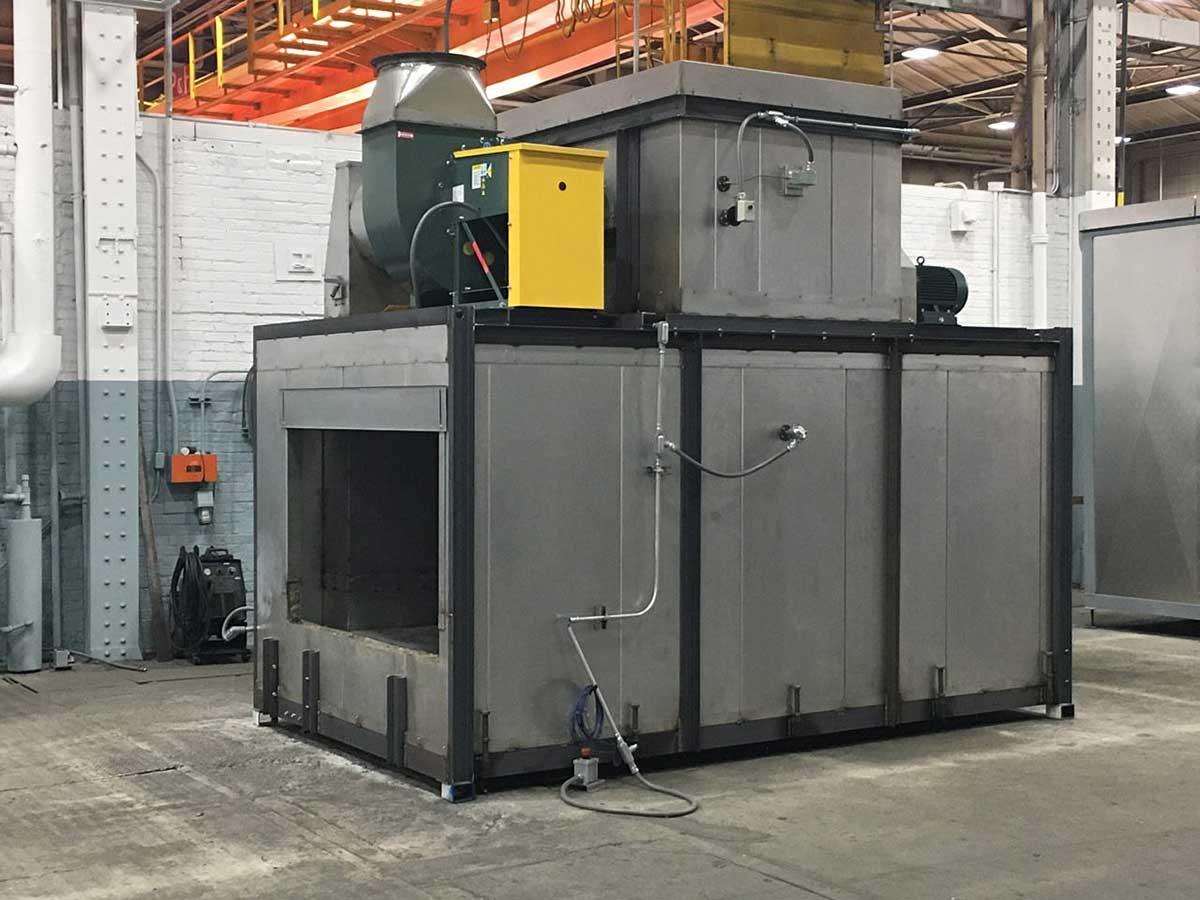

Epoxies can be cured more quickly by heating the bonded assemblies in an oven. However, not all substrates can tolerate extended time in an oven. Photo courtesy International Thermal Systems
