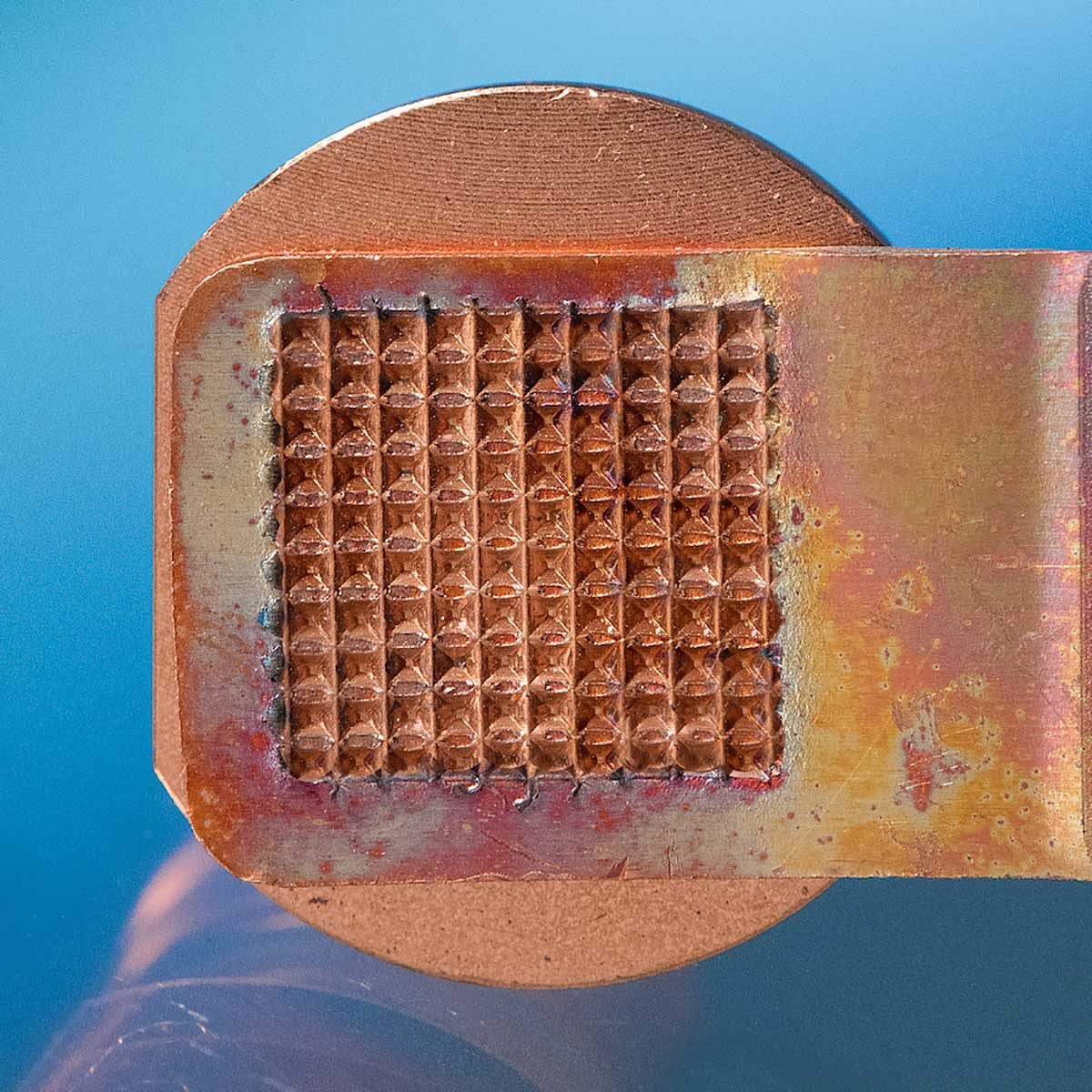

This close-up of a “direct press” weld shows how strongly the tooling gripped the part. Photo courtesy Branson Welding and Assembly at Emerson

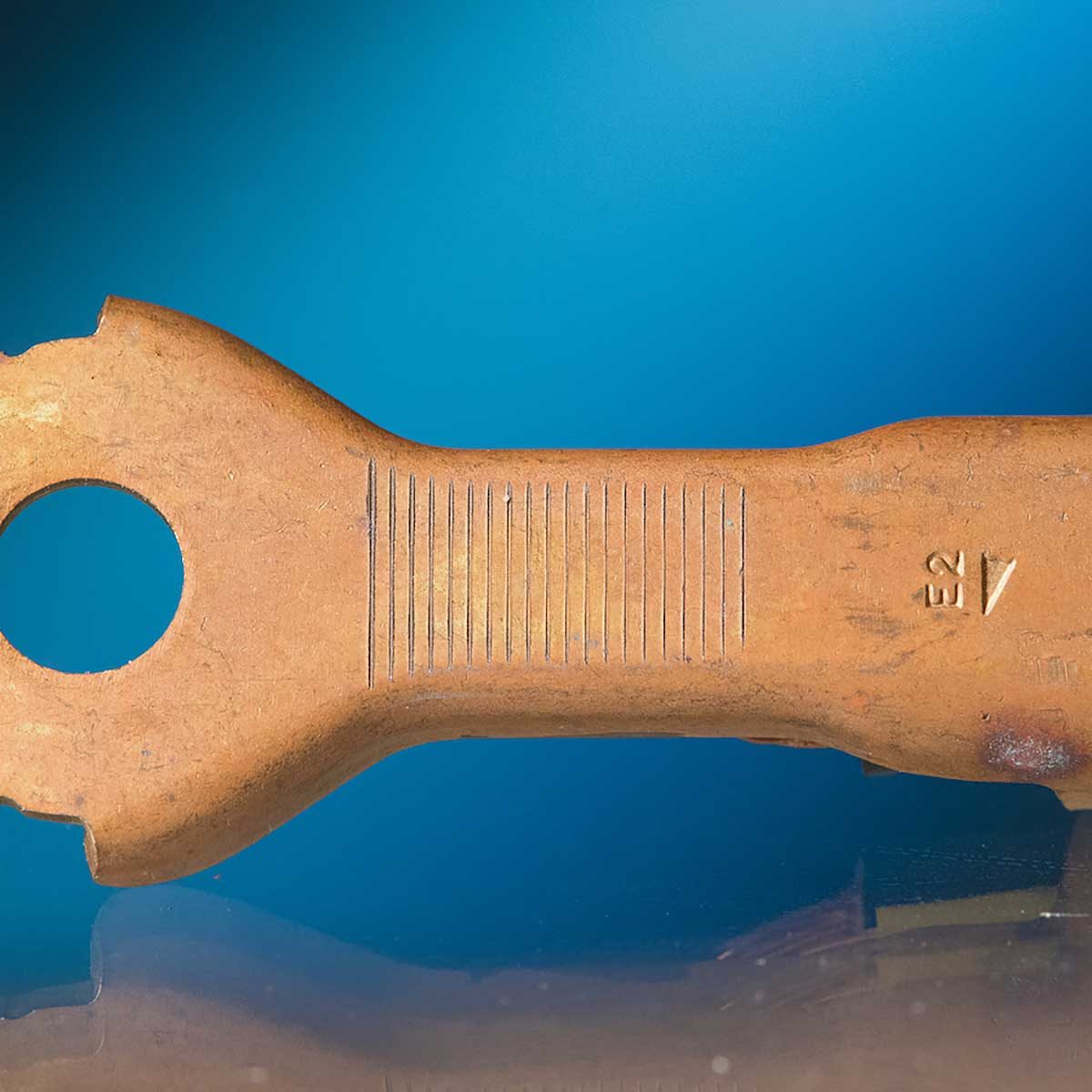

Finally, the reliability and effectiveness of weld tooling are diminished, since higher amplitudes and power cause the weld tooling that should normally compress, grip and rub the cable strands against each other to lose grip and begin sliding against the cable strands. Such tool slippage results in rapid and excessive tool wear, increased tool replacement and refurbishing costs, undue stress on welding equipment, and increased energy consumption.
One logical remedy for tool slippage caused by higher amplitude and power would be to greatly increase the clamping force used in the weld process. However, testing demonstrated that when welding cable diameters larger than 60 square millimeters, the cantilevered press actuators used in many current ultrasonic metal welders are pressed beyond their mechanical limits.
Musical instrument, Wood
This photo shows slippage marks caused by too much amplitude and a poor grip on the parts. Photo courtesy Branson Welding and Assembly at Emerson

The optimal solution eliminates the cantilevered press actuator in favor of direct downward force on the parts to be welded. Direct downward force delivers a robust hold on the parts throughout the power and amplitude range to maintain control over the weld process. This solution, developed by Emerson, is found in a new generation of Branson “direct press” ultrasonic welding equipment, typified by the Branson GMX-20-DP welder. This equipment delivers on two essential capabilities. First, this re-engineered equipment is capable of exerting high levels of clamp force on large cables—up to 6,100 newtons. Second, it can efficiently manage delivery of the significantly higher power levels needed to generate the vibratory motion and frictional heat essential to welding large conductors together under higher levels of clamp pressure.
At the same time, Emerson set to work on improved tooling that would overcome the problem of rapid tool wear under the stress of higher clamping forces. This new tooling—applicable to both horn and anvil—combines new coatings that increase tool hardness and durability with special knurling that gives weld tools an increased grip on the cabling. When this improved tooling is combined with the capabilities of the new “direct press” ultrasonic metal welders, the result is a markedly more efficient and repeatable large-cable welding process than cantilevered press welders can provide.
