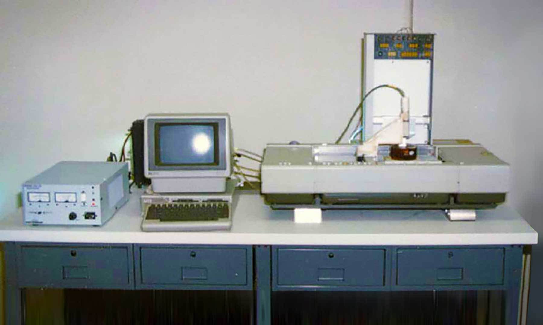

The first commercially viable AM technology, stereolithography, was invented in 1983. Photo courtesy 3DPRINTUK
