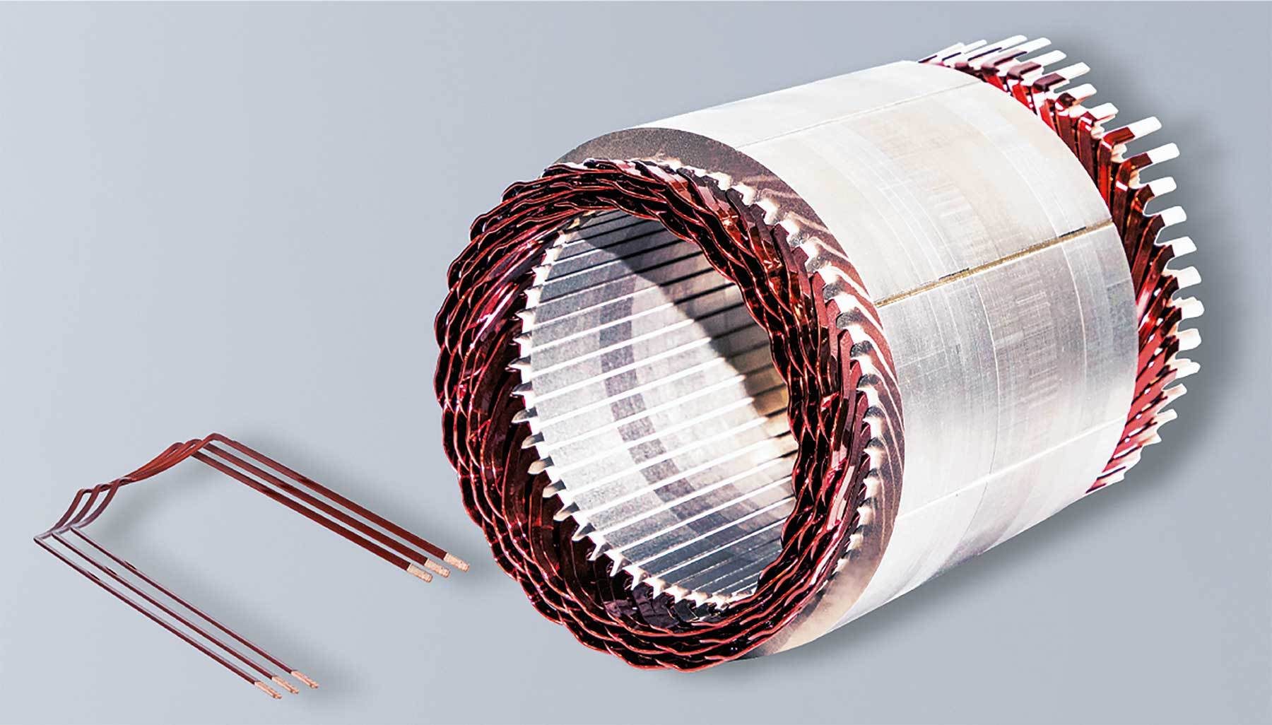

GROB’s electric motor stators (right) contain several winding rims made of individual hairpins (left). Photo courtesy GROB-Werke GmbH & Co. KG

Around 200 hairpins in approximately 50 different designs are required to build a stator winding. These are produced one after the other in the order required for placement in the pre-insertion nest. Inline error detection is therefore important.

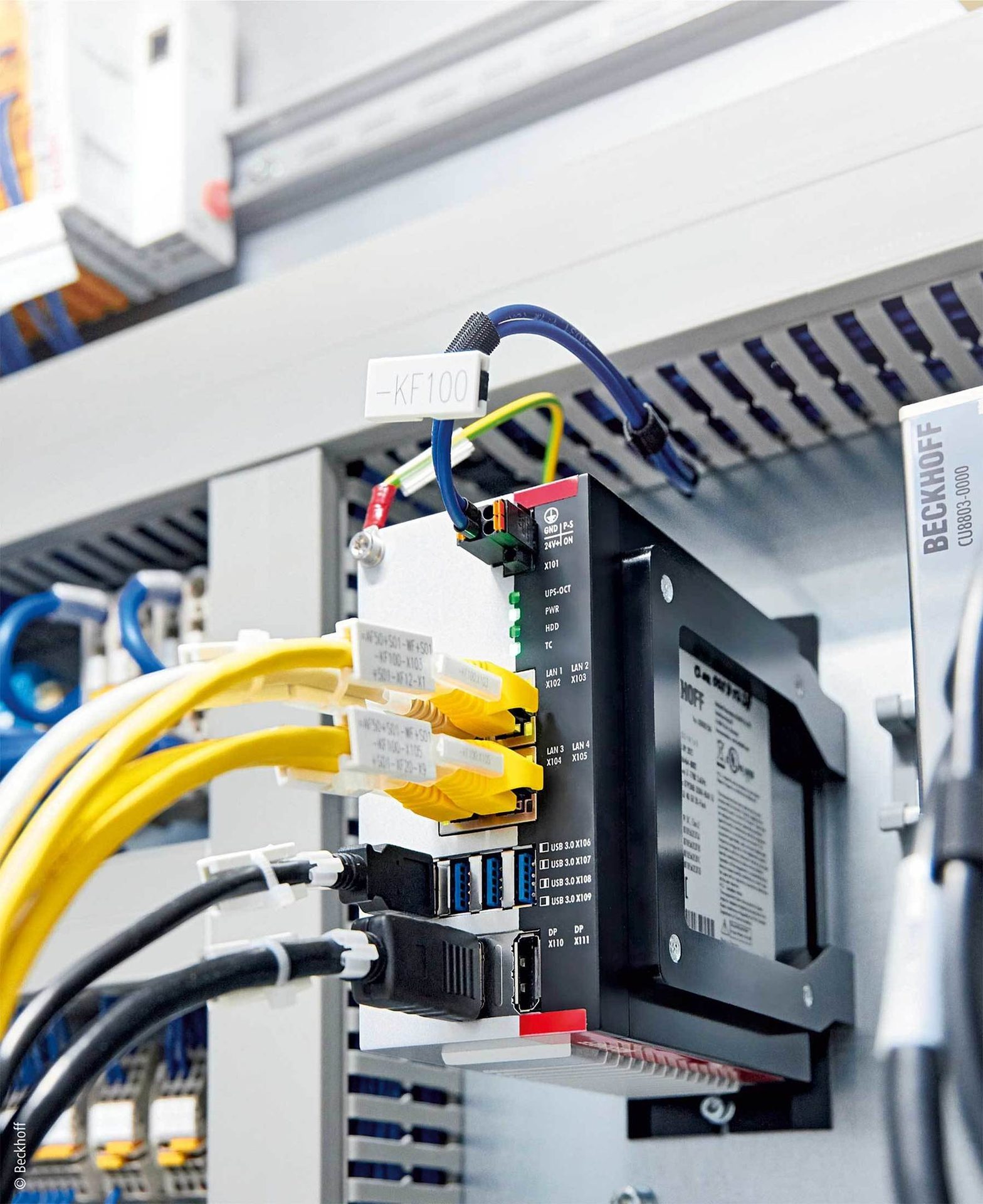

A C6030 ultra-compact industrial PC provides optimal computing power for central control of all process sequences. Photo courtesy Beckhoff Automation
“Compared to systems for internal combustion engines, systems [for EV motors] are characterized by more sophisticated stations, reduced PLC cycle times, a higher proportion of drive technology in assembly, and sophisticated coupled movements.”
This is also evident in the hairpin machine, which is fully equipped with Beckhoff control and drive technology. In addition to four GROB spindles, the system includes 57 numerically controlled axes: 40 real axes, five virtual axes and 12 XYS movers that are operated as individual servo axes. In addition, there is an extensive number of I/O, consisting of EtherCAT and TwinSAFE terminals or box modules, with 270 digital inputs and 150 digital outputs.
Using a C6030 or C6032 ultra-compact Industrial PC (IPC) and TwinCAT 3 automation software as the control core, the machine achieves a high output rate based on a cycle time of just 2.3 seconds per hairpin. This is even more impressive due to the complexity of the machining process and the number of control tasks involved, such as wire feeding, bending, stripping and positioning. The control tasks include:

Beckhoff’s ultra-compact industrial PC, the C6030 (or the C6032, if more interfaces are required), is used in connection with a CP3918 multi-touch control panel with customer-specific push-button extensions. “The PC provides sufficient computing power to reliably achieve our target of a 4-millisecond PLC cycle time,” says Glöckler. “As an added benefit, it has a compact design and variable mounting options.”

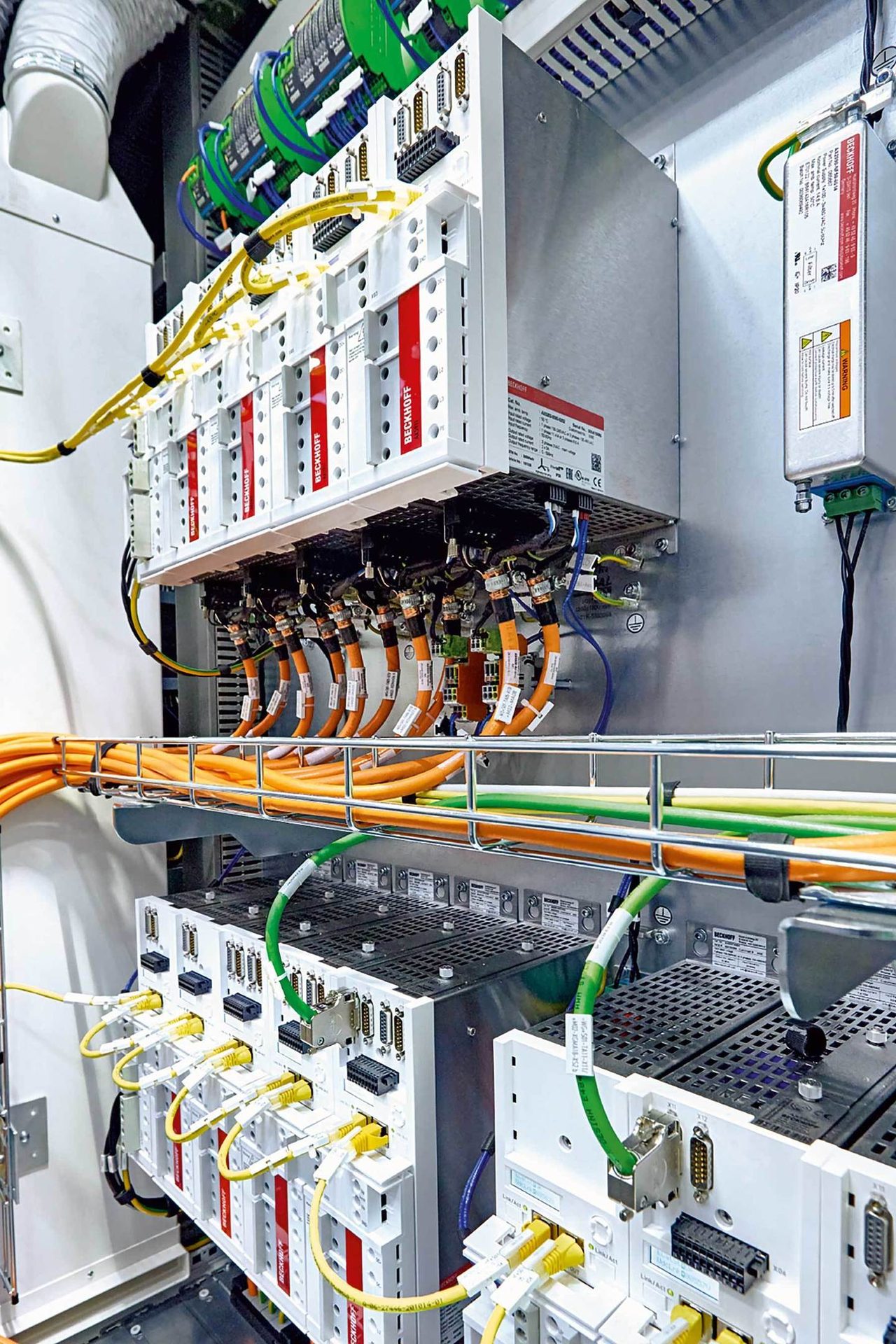

AX5000 servo drives are primarily used to control AM8000 servomotors. Beckhoff’s One Cable Technology minimizes installation space and cabling effort. Photo courtesy Beckhoff Automation
The numerous rotary axes are implemented with AX5000 servo drives, EL72xx and EP72xx compact drives and AM8000 servomotors. Ellenrieder sees a particular advantage in motors and drives with Beckhoff’s One Cable Technology (OCT).
“OCT results in significantly less cabling effort and minimizes potential sources of errors,” he says. “Other important factors when using the AX5000 are the covered encoder interfaces and the safe motion functions of the AX5805 TwinSAFE option card.”
