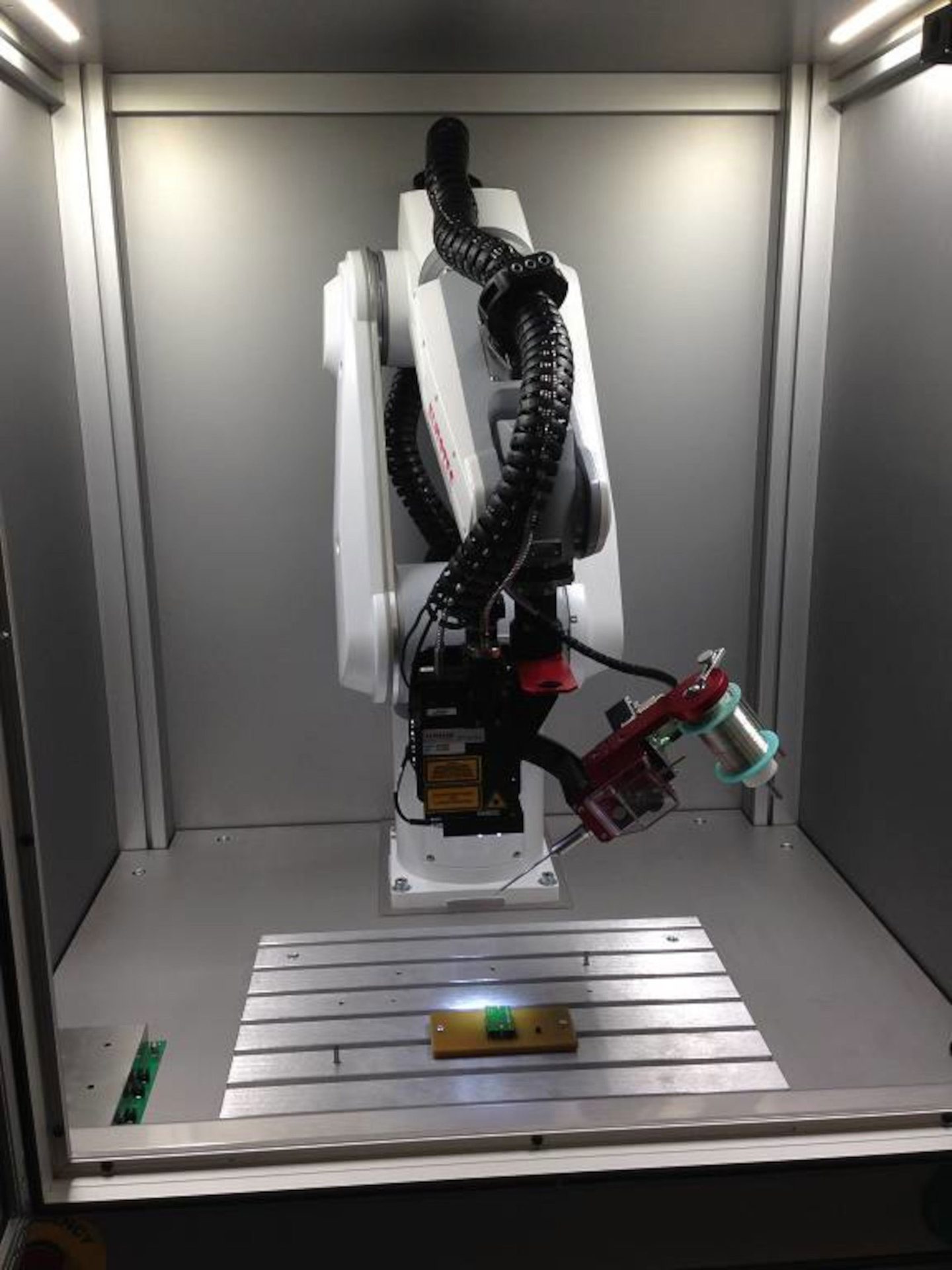

Several years ago, Kuka partnered with Alnea to produce a compact soldering cell that features a KR 6 R900 robot and a Zeus controller. According to O’Farrill, the system can reduce production time by up to 50 percent. The robot controls the motions of the soldering iron while holding PCBs in a fixed position.

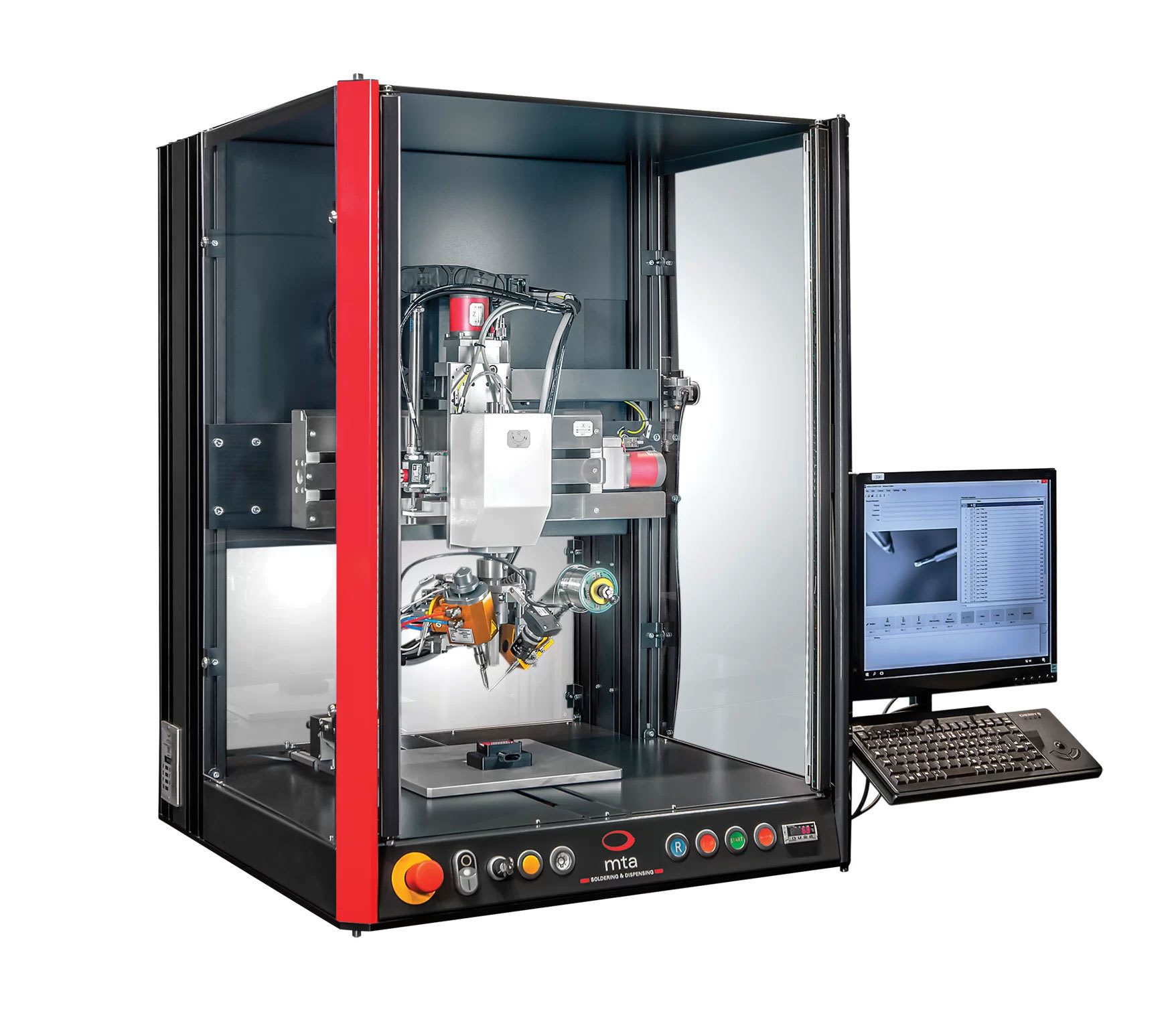

Tabletop robots offer a good way for manufacturers to transition from manual soldering to robotic soldering operations. That’s why MTA Automation developed the TR300 platform. It provides a cost-effective way to automate existing hand soldering processes without the cost of a fully automated systems. The four-axis robot features 0.02-millimeter repeatability and a 300-by-300-millimeter work envelope.
“The TR300 nicely fills the gap between highly skilled labor and expensive fully automated machines,” claims Hunter. “The purpose-built robot performs the solder process, so the operator does not need special training and certification.
“Because operators load and unload parts, the robot does not need nimble motion control or complex vision systems for part handling,” explains Hunter. “The machine and operator complement each other in a cost-effective symbiosis, so manufacturers can fill their labor gap with relative ease.
“This tabletop platform is ideal for applications where human dexterity is required to position parts,” Hunter points out. “Operators can load and unload parts in offline fixtures to minimize machine downtime.
“The ball-screw axis and motors provide fast, repeatable motion,” says Hunter. “They are strong enough to support our heads, which include an anti-jam wire feeder system and solder wire spool. There is no need to push solder wire through lengthy and problematic feed tubes.
“Therefore, the soldering process is more accurate and reliable than feeding the wire long distances,” claims Hunter. “Similarly, we preplumbed a large fume extraction hose with the nozzle located directly above the solder joint. Light curtains and safety guarding are also standard features.”

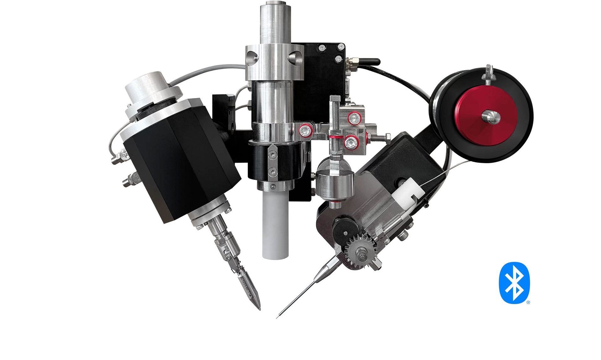

MTA Automation’s newest product is the MSH150 solder head, which was released about a year ago. The standalone unit is a compact, all-in-one package.
Everything is contained in one unit inside the head, including the soldering iron, wire feeder and controller. The plug-and-play device can be used with collaborative, SCARA and six-axis robots. It can also be installed on any standard robot, including machines from ABB, Epson, Fanuc, Kuka and UR.

This solder head can be used with a variety of collaborative, SCARA and six-axis robots. Photo courtesy MTA Automation Inc.
