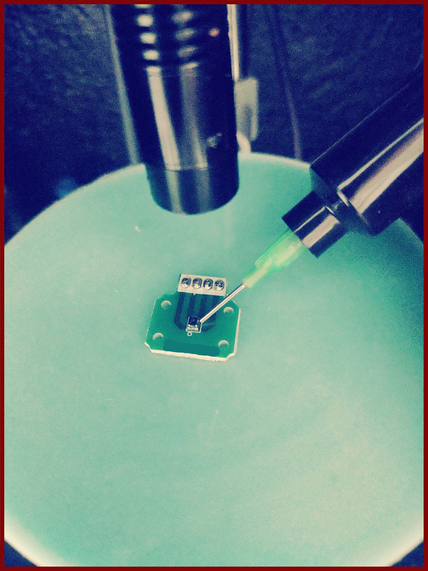

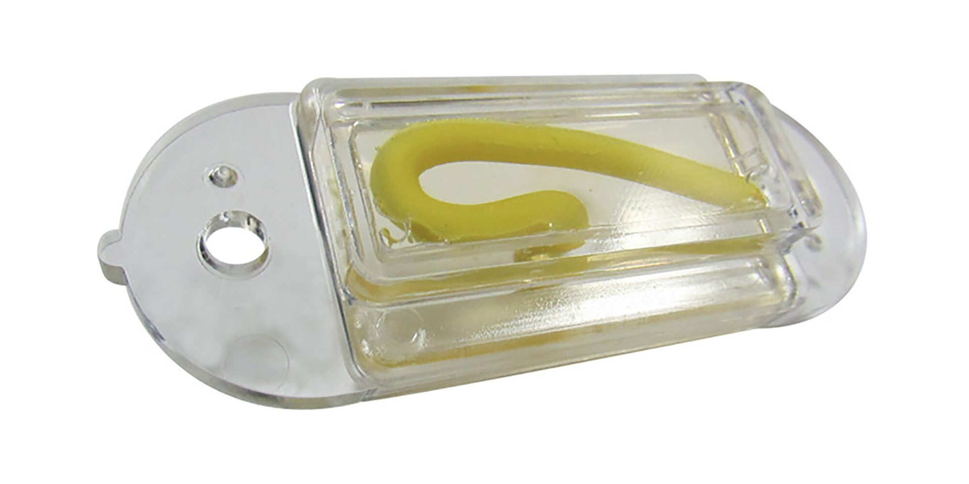

UV-cure Epoxy Cures in Less Than a Minute
Musical instrument accessory, Rectangle
This epoxy cures quickly when exposed to UV light. A layer of epoxy up to 0.5 inch thick can cure in 30 to 60 seconds. The epoxy provides great clarity, superior adhesion, and a long shelf life (up to one year at room temperature). The epoxy has a virtually unlimited pot life; it will not cure until exposed to the appropriate UV wavelength. It has a low viscosity of less than 400 centipoise. This nonbrittle material has good chemical resistance. Booth 1700

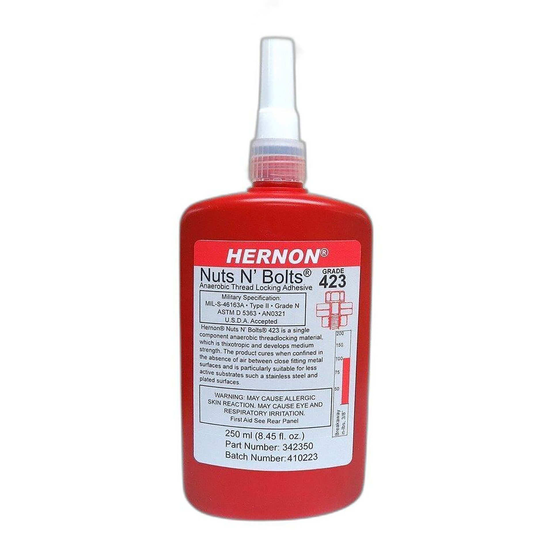

Threadlockers Prevent Loose Fasteners
Liquid, Fluid
The Nuts N Bolts series of one-component, anaerobic adhesives lock, seal and prevent corrosion of threaded fasteners. Formulations are available to meet a variety of adhesive properties, such as maximum gap filling, cure times, shear strength (breakaway and prevailing torque), and varying viscosities. These adhesives replace expensive methods of preventing loose fasteners, such as lock washers and split washers.
Booth 1437
Hernon Manufacturing

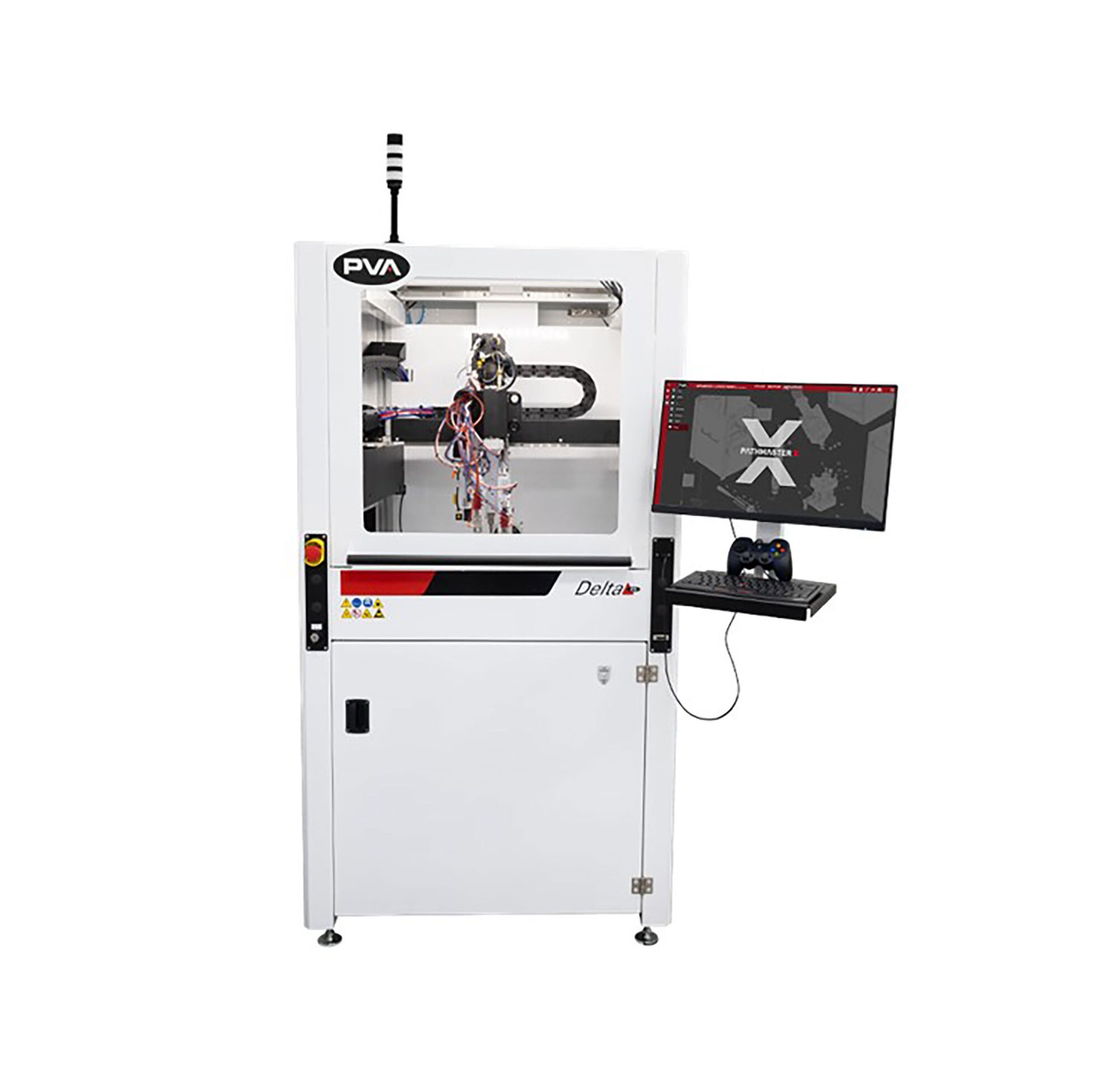

Conformal Coating System
Output device
The Delta 8 four-axis conformal coating machine features state-of-the-art components, including the FC100-CF non-atomized coating valve with continuous film calibration; the FCS300-ES-UF ultra-fine extended-spray valve; and the FCM100 front-closing micro dispense valve. These valves ensure precise and uniform application of conformal coatings.
The machine is programmed with PathMaster X software, which has been specifically designed for the Delta 6 and Delta 8 systems. The software introduces a range of advanced features, a unified programming and production environment, and tools to streamline programming for conformal coating, dispensing and custom applications.
A key feature of PathMaster X is the X-PAD multifunction controller and a modern touch-screen monitor. This intuitive system consolidates all controls within a user-friendly interface. Booth 1706

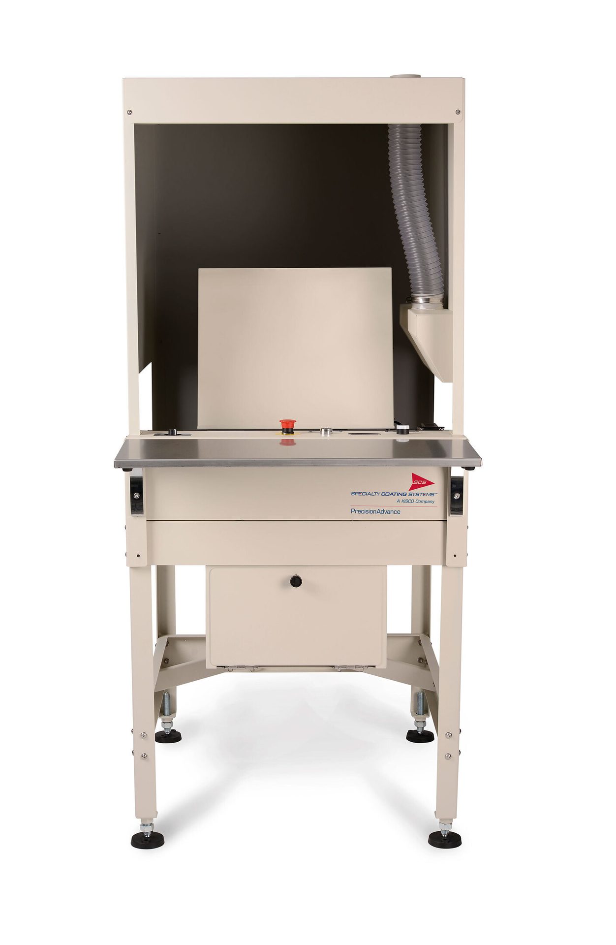

Conveyor for Automated Coating and Dispensing
Output device, Rectangle
Available in four configurations, the SCS PrecisionAdvance is a pin-type-edge handling conveyor for transporting circuit boards through dispensing, conformal coating, curing and inspection operations.
The conveyor fully integrates with the SCS PrecisionCoat and PrecisionCure systems to provide a comprehensive automated dispensing system, enabling line management and streamlining the movement of boards through the manufacturing process.
These modular systems are all governed by the same control software for easy integration. Additionally, the conveyor has several optional features to meet specific process needs. For example, the inspection conveyor can be configured with an easel that is ideal for displaying board drawings. When paired with an enclosure hood, operators can use an overhead black light to inspect coated boards while minimizing ambient light. Booth 1711
