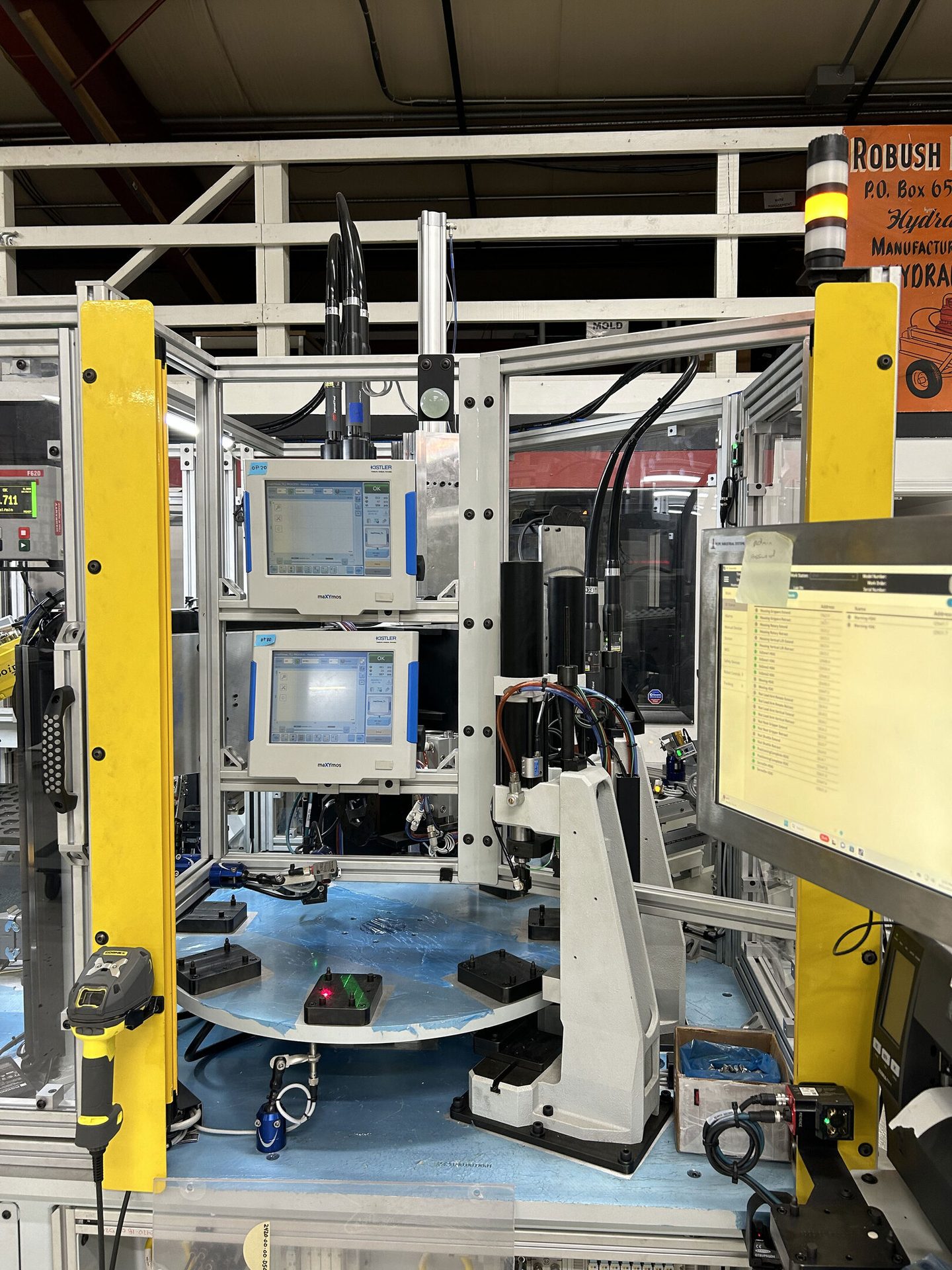

The system consists of a pre-assembly station, a rotary indexing dial, and a robotic assembly station.
At the pre-assembly station, the parts are staged by an operator. This provides flexibility for part preparation, which aligns with the customer’s workflow. The operator starts the process by scanning a 2D Data Matrix code on the main module housing. This logs the parts into the facility’s MES system. A bar code is then printed to track the control module through the assembly process. Once the bar code has been applied to the housing, the part is loaded onto the dial.
Industry, Factory
The system is built around an eight-position rotary indexing dial. The dial features a bar code reader, pneumatic presses, vibratory bowls, a six-axis robot, fixtured screwdrivers and an inspection station. Photo courtesy The Christopher Stephen Corp.
The dial has eight positions. At the first stop, a reader scans the bar code that was applied to the housing at the pre-assembly station. This connects the part’s data to the start of the automated assembly and test process. All data developed as a part of the assembly and test process is connected to the unique bar code of that part.

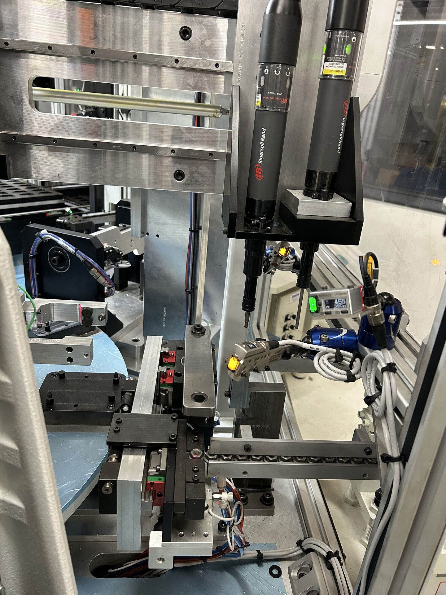

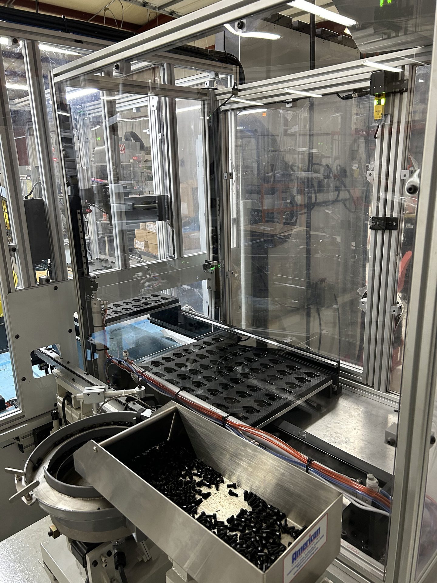

At position 4, an actuator picks the assembly off the dial, rotates it 180 degrees, and returns it to the dial. Two vibratory bowls feed a plug and a nut, which are picked up with tooling that has a detent to hold the parts. Then, Ingersoll Rand fastening spindles install the nut and plug to a specific torque.

Fixtured spindles install threaded fasteners to a specific torque. Photo courtesy The Christopher Stephen Corp.
The solenoids are supplied in a two-tray system. While the robot is picking parts from the tray inside the machine, the operator is reloading a second tray outside the machine. The trays automatically switch when one tray is empty and the other is full.
When the bolts and solenoid are in place on the housing, a set of fixtured fastening spindles from Ingersoll Rand tighten the bolts to a specific torque. Once this is completed, the fixture rotates 180 degrees and the process repeats with a second solenoid.

While the robot is picking parts from a tray inside the machine, an operator is reloading a second tray outside the machine. The trays automatically switch when one is empty and the other is full. Photo courtesy The Christopher Stephen Corp.
