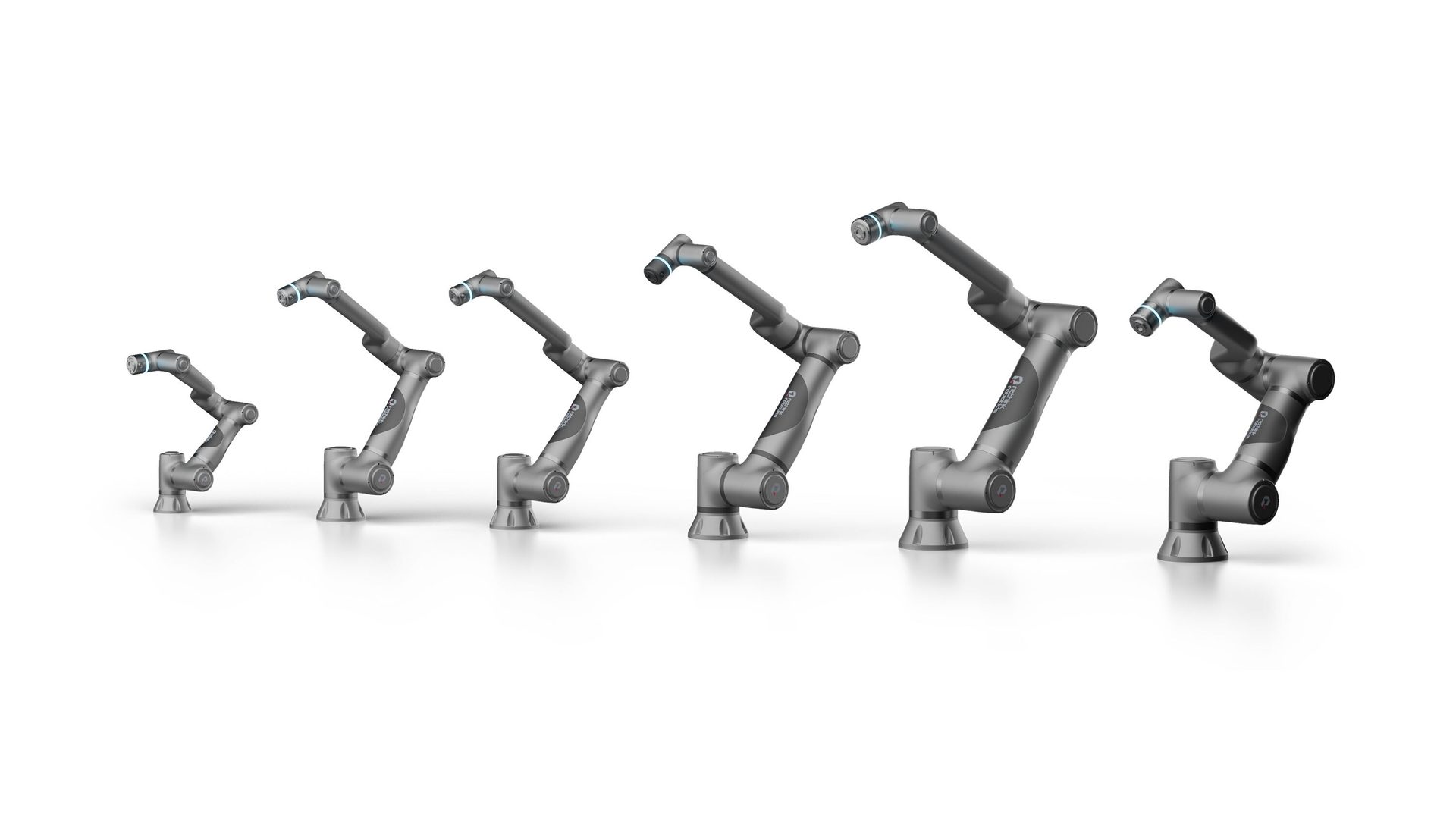

The Reacher line of cobots comprises seven models with payload capacities of 15 to 66 pounds and a maximum reach of 800 to 1,600 millimeters. Photo courtesy Rethink Robotics
But, like a phoenix rising from the ashes, Rethink Robotics surprised everyone by reappearing at this year’s International Manufacturing Technology Show in Chicago last month with a large booth. The company displayed three new robots it says are better designed for manufacturing.
One of those new robots is Reacher, a conventional-looking six-axis cobot. The Reacher line comprises seven models with payload capacities ranging from 15 to 66 pounds and a maximum reach of 800 to 1,600 millimeters. The robots have an IP65 rating for use in wet and dusty environments, and they have a positional repeatability of ±0.03 millimeter, making them suitable for the most demanding tasks. Depending on the model, maximum speed ranges from 120 to 200 degrees per second.
