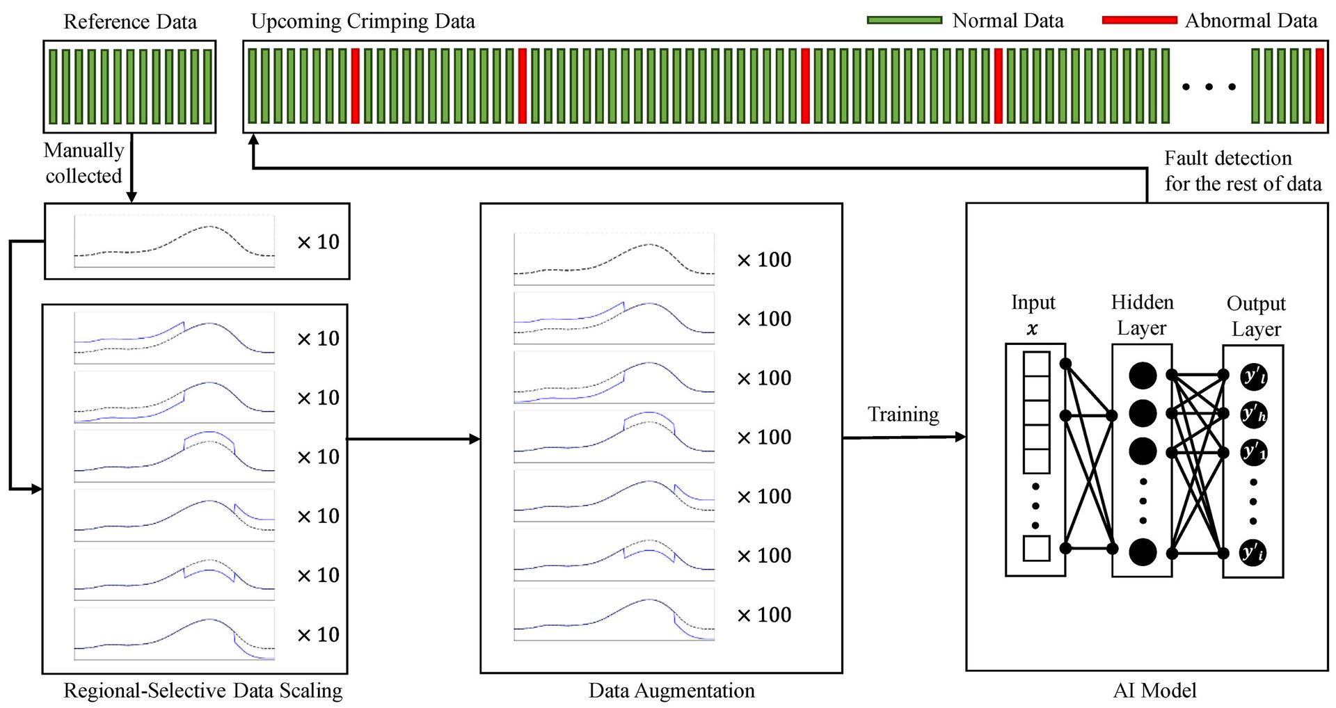

This illustration shows the process of using an AI model for fault detection during a crimping operation. Initially, reference data are manually collected. Then, RSDS is applied to the data to generate synthetic abnormal data by performing upscaling or downscaling on specific regions. The data are then augmented using Laplace distribution to increase the volume of the dataset and improve the training robustness of the model. Finally, the augmented dataset is used to train the AI model, which uses a MLP. Source: Dongguk University

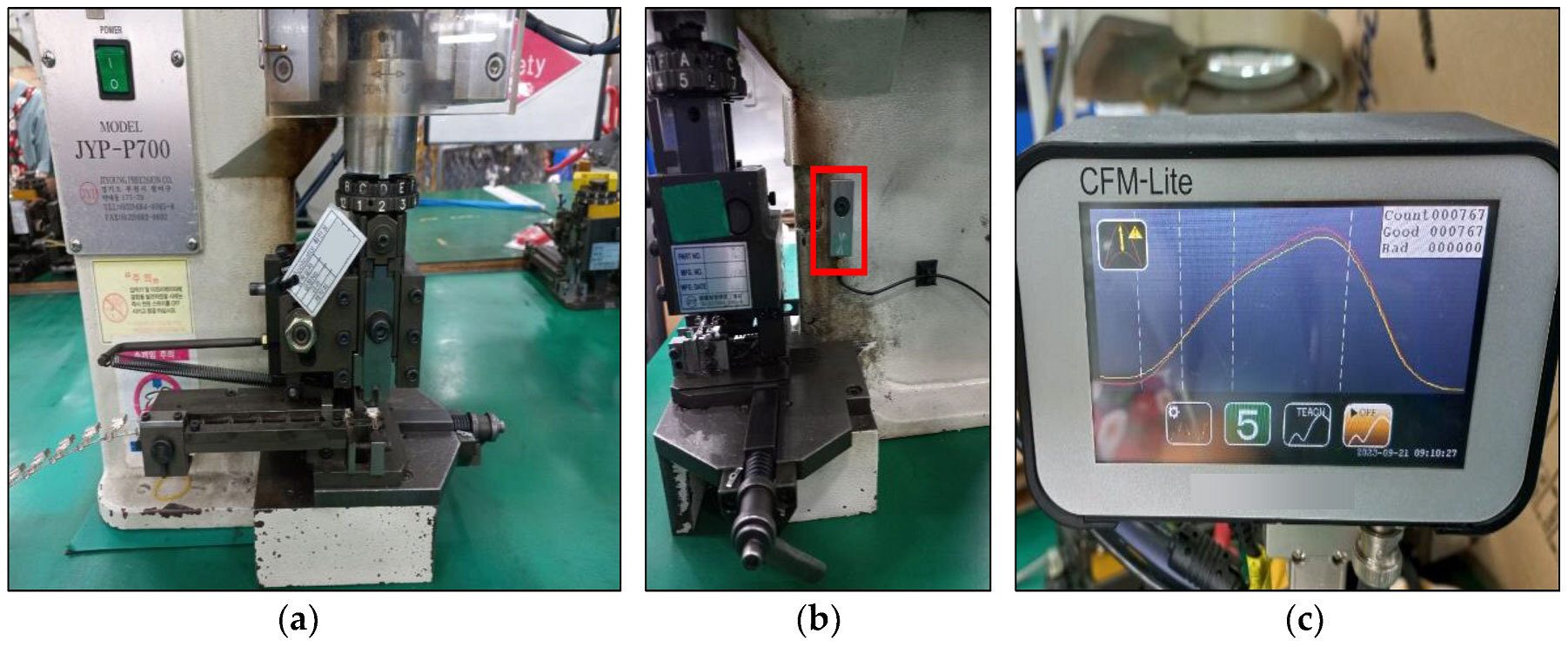

To develop a practical fault detection system, it’s essential to collect raw data from the actual manufacturing process, instead of theoretical simulations. For our research, we collected data from a crimping press in operation at a wire harness manufacturing facility.
The machine runs daily in multiple shifts and is dedicated to producing wire harnesses for a range of electronic assemblies. It is equipped with a CFM system.

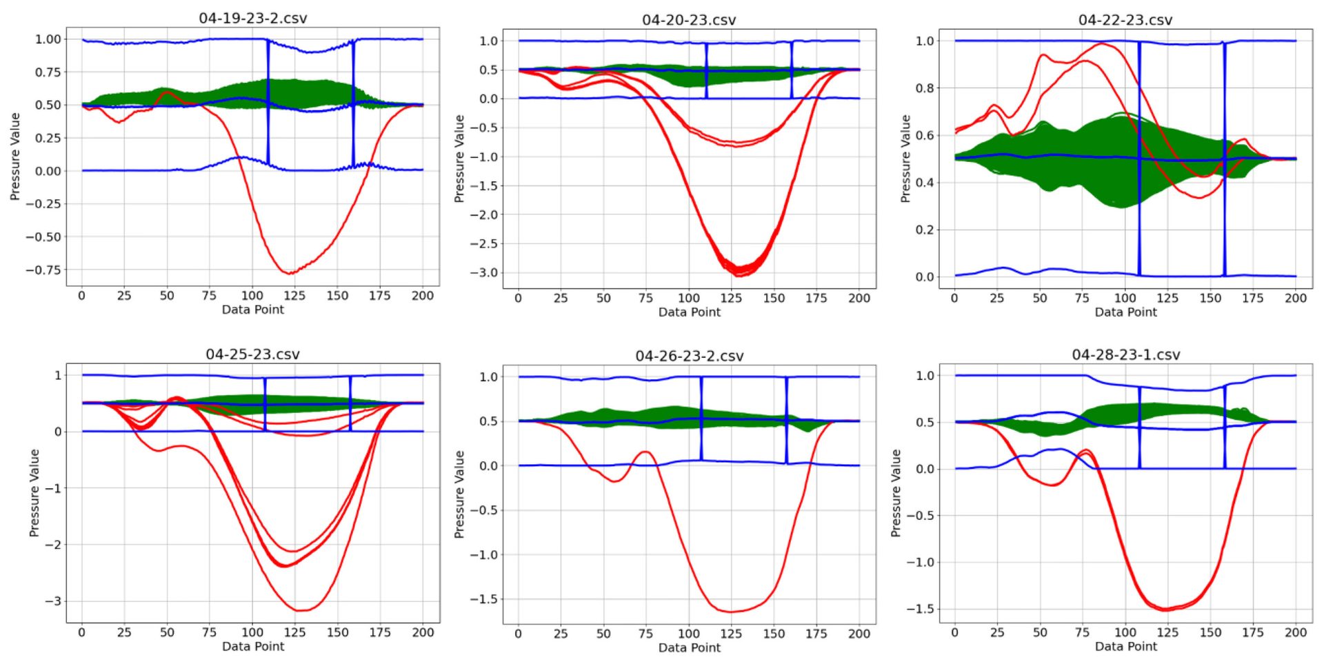

The scales of the datasets, even those collected on the same day, are significantly different, which poses a substantial challenge to the development of a generalized AI model for defect detection. Data collected on April 19, April 26 and May 4 display clear discrepancies. This inconsistency is not just due to the variability in products, but also arises from issues with sensor sensitivity and fluctuations in environmental conditions. Given these variable and inconsistent scales, it is crucial to reset the AI model for each unique manufacturing setup, ensuring accurate defect detection under these diverse and variable conditions.
White, Green, Light, Product, Black, Rectangle, Azure, Blue, Slope, Font
These graphs display six representative prediction results, all accurately classified. The researchers’ model accurately identified defects of different sizes and shapes. The blue lines represent the researchers’ synthetic data. The green areas are true crimp defects. The red lines are true good crimps. Source: Dongguk University

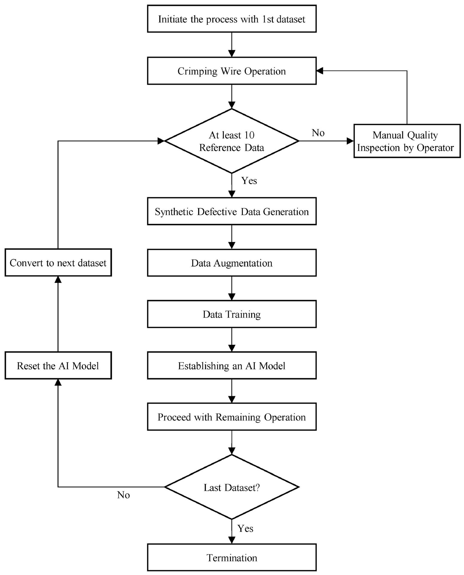

Proposed Fault Detection System
Considering the constraints of traditional CFM and recognizing the challenges of applying conventional AI to fault detection, this paper presents a new paradigm: a fault detection system based on AI with RSDS. This paradigm solves the challenges caused by limited training data and unpredictable defects by using an anomaly-detection-based algorithm.
In our process, initial reference data is manually collected by an operator. Then, RSDS is applied to the data to generate synthetic abnormal data by performing upscaling or downscaling on specific regions of the data. The data are then augmented using Laplace distribution to increase the volume of the dataset and improve the training robustness of the model. Afterward, an augmented dataset is used to train the AI model of the system, which utilizes an MLP.

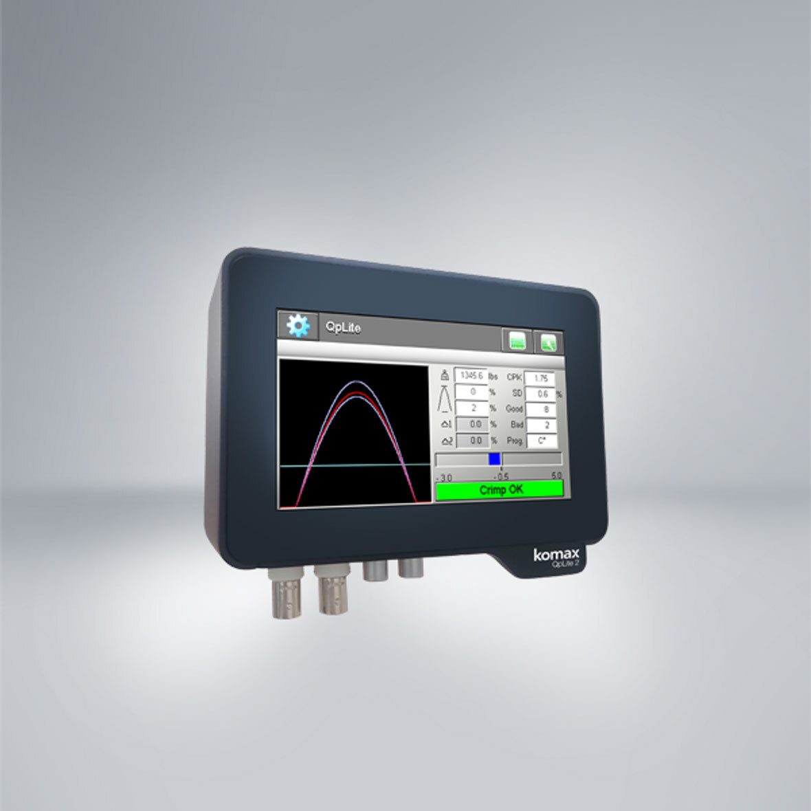

The QpLite2 is a scalable CFM device for ensuring the quality of each crimp. It can be integrated with either single or double-channel benchtop crimp presses. Photo courtesy Komax

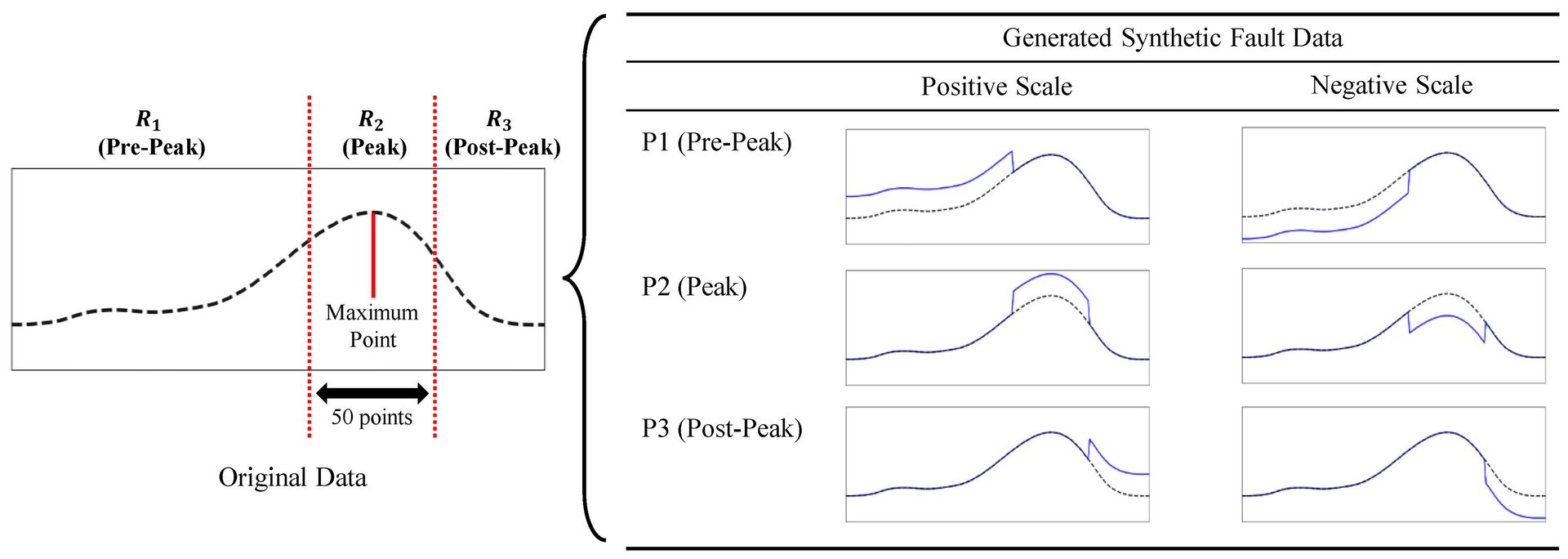

An MLP needs at least two classes for training, thus requiring the creation of synthetic abnormal data to effectively train the model. Generating and integrating synthetic abnormal data can introduce additional complexities and potential biases into the training process, demanding a careful and strategic approach to ensure genuine and meaningful learning.
A feasible approach might involve upscaling and downscaling of the original data to create synthetic fault data. Implementing upscaling and downscaling randomly on the original data seems like a feasible solution for detecting unexpected defects. However, this technique can complicate the model by necessitating the integration of numerous fault data classes. This increases the model’s structural complexity while prolonging the training.
In contrast, uniformly applying scaling adjusts the entire dataset consistently, potentially simulating various defect scenarios by systematically deviating from the original “normal” manufacturing data. However, uniform scaling across the entire dataset might impede classification performance, as it counters the MLP’s intrinsic learning mechanism.
Given that MLPs learn primarily by adjusting weights during the back-propagation process, uniform scaling, which inherently reduces differences in the data, could adversely impact the model’s ability to effectively differentiate and adjust weights, possibly compromising its predictive accuracy and classification ability.
Consequently, this uniform increment could adversely impact the MLP’s classification performance and predictive accuracy by distorting the relative disparities among each input feature.
Regional Selective Data Scaling addresses these issues. The generated synthetic abnormal data can help to generalize AI models with few reference data points. Rather than uniformly scaling the entire region, this approach divides the region into smaller sections and then selectively applies scaling. In this way, this approach addresses the challenges related to uniform scaling while also allowing for a more systematic simulation of various defect scenarios. RSDS plays a crucial role in creating synthetic abnormal data, allowing models to learn and adapt to different defect types, even when actual defective data are initially unavailable.

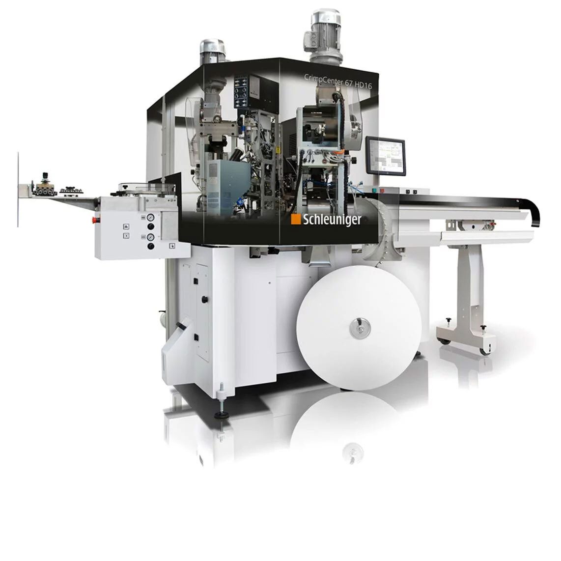

Many fully automatic cutting, stripping and crimping machines are equipped with CFM technology. Photo courtesy Schleuniger

The experiments were conducted in a specific scenario to simulate real-world manufacturing. At the start, the system begins with the initial dataset and assesses the availability of at least 10 reference data points. It is assumed that the collection and assessment of reference data is performed manually by an operator. However, in the experimental setup, the first 10 data points from the normal label are used to simplify the experimental processes.
After generating synthetic abnormal data from the reference data, an AI model is established. If the system processes all the remaining data, it resets the AI model and moves on to the next dataset, until it processes the last dataset. This approach ensures that each dataset is paired with a dedicated AI model that is carefully calibrated to match its unique characteristics.
Some 60 datasets were generated from the 10 reference data points. These datasets were subsequently expanded to 700 datasets using data augmentation techniques. From the creation of six defective types, seven classes of labels were accordingly established, including the normal class. The training data consisted of a total of 770 fully labeled datasets, each classified into one of the seven classes.
It is worth noting that only 10 out of the 770 datasets were original reference data. To maintain consistency in normalization, the MinMax scaler was employed.
After scaling, the data were used to train an MLP model with 200 input neurons and two hidden layers consisting of 64 and 32 neurons, respectively. The model utilized the ReLU activation function and the “adam” optimization algorithm. An “adaptive” learning rate was employed, with the maximum iteration set at 500. For the evaluation, we chose accuracy and the true-negative rate (TNR) as the main metrics. Accuracy provides a comprehensive assessment of the model’s performance, whereas the TNR specifically evaluates the system’s proficiency in identifying defective items, a critical aspect in the domain of manufacturing quality control.

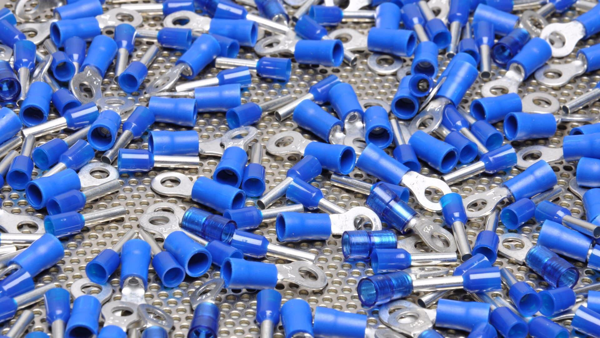

Terminals must be attached to a wire with just the right amount of force. Photo courtesy Partex Marking Systems

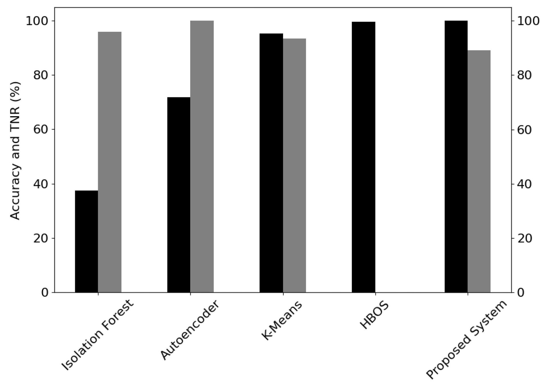

Our proposed system is notable for its exceptional average accuracy of 99.95 percent. Its TNR stood at 85.72 percent, demonstrating its high sensitivity in detecting anomalies.
The HBOS demonstrated an impressive accuracy rate of 99.56 percent. However, the TNR of 0 percent across all datasets indicates potential overfitting and a lack of effectiveness in detecting anomalies.
The k-means algorithm, with 95.39 percent accuracy and 93.44 percent TNR, presents concerns in manufacturing contexts. A difference of 4.5 percentage points may not seem like much, but it implies a substantial number of misclassifications. Moreover, while the k-means’ TNR seems better than our system’s TNR of 85.72 percent, the small sample size of true and false negatives suggests that the apparent advantage may not be significant.
The results for the Isolation Forest and autoencoder algorithms indicate a case of anti-fitting. Specifically, the Isolation Forest showed an average accuracy of 40.42 percent paired with a TNR of 96 percent, while the autoencoder achieved an average accuracy of 68.92 percent with a TNR of 100 percent.
Our study presents a concrete and systematic approach to improving quality control in wiring harness crimping manufacturing by integrating RSDS with AI. This approach utilizes the distinctive capability of RSDS to generate synthetic abnormal data, effectively addressing the challenge of having only limited labeled datasets available for robust AI training. The experimentation conducted on authentic industrial datasets demonstrated both a promising alternative to CFM and its advantage over traditional anomaly detection algorithms. This suggests that the integration of AI can help improve manufacturing quality control.
